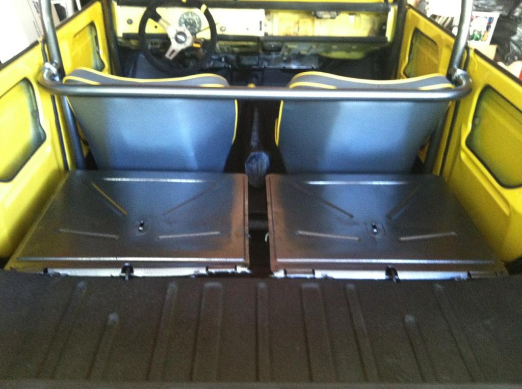

Thanks for the input! The kid agrees and we are going to match the bumpers to the cage. We might just get carried away and coat the engine tin and back seat backs in the same hammered tone. Cool Back to work on it after our vacation on 8-11.

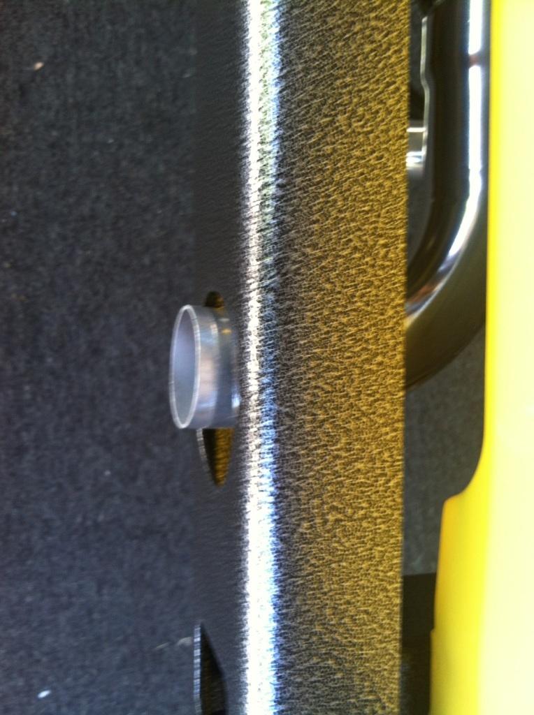

Back from the vacation, I got the bumpers and seat backs from blasting and powder coat....turned out nice! Cool
And a close up of the powder coat:

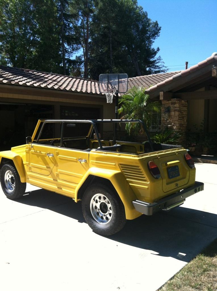

PostPosted: Mon Dec 29, 2014 10:58 am    Post subject: Reply with quote
Finally got through all of my wiring issues. After dealing with the old harness, brittle and broken connectors and its numerous hacks, I picked up a new harness from Rebel Wire. Very simple install. It turns out my cracked ignition switch also fried the starter. Sad After that was replaced it was time for a winter drive. If you look closely, you can see the LED parking lamps are on. Smile
