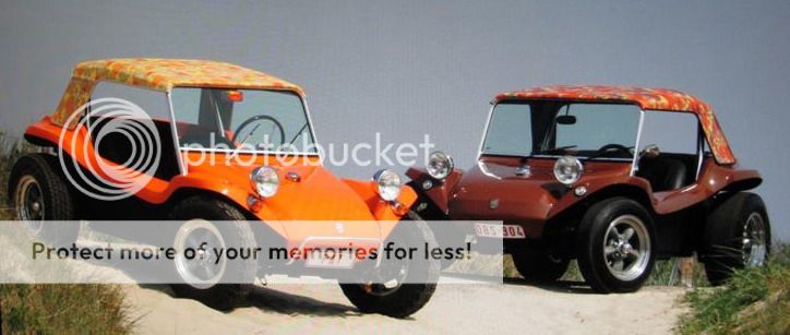

I aproached the Belgian company who custom printed the vynil for this top and they wanted 680 euro for 2 metres!

I had a PM re. the wheels and tires on the orange car so I dug the old magazine out of the loft and answered it, but if anyone else is interested..
8 1/2 and 6 by 15 American Racing Torque Thrust wheels with ancient L-60 x 15 BFG Bog Boppers on the rear and M/T Mini Mag E78 x 15 front.
The two cars were featured in the UK magazine 'Ultra VW' in the May 2008 issue.
The roof fabric was custom printed by Dam's Graphix in Belgium...
