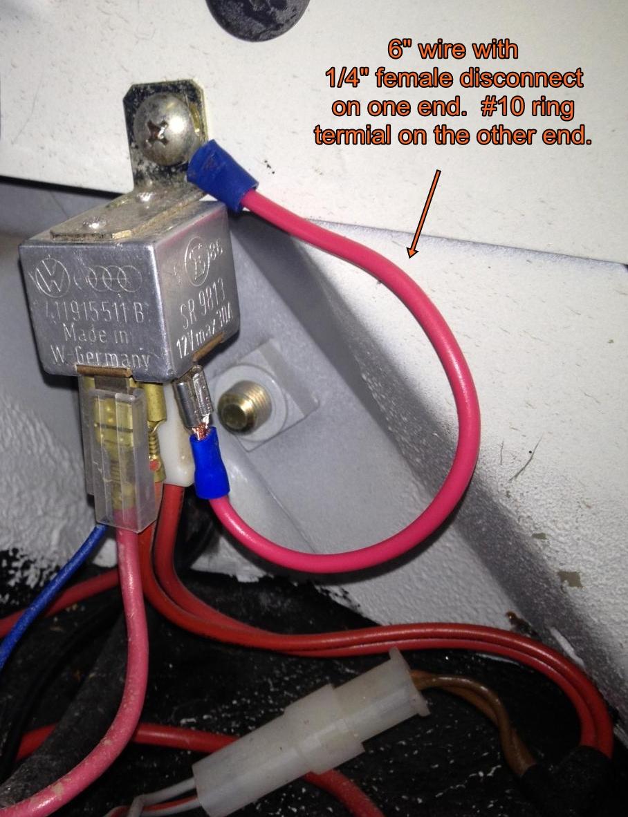

PostPosted: Sun Mar 01, 2015 8:41 pm    Post subject: Grounding relay under driver's seat Reply with quote
Can anyone steer me to a picture of the relay Jay speaks of above properly grounded? PO installed my van's hard start relay ( made by Jay) and he said he wasn't electrically savvy...of course, neither am I.
1987 2.1L 2WD Full Camper Kerouac

PostPosted: Sun Mar 01, 2015 9:33 pm    Post subject: Reply with quote
This is what you are looking for.
My hard start kits include a brown 6" wire with a 1/4" female disconnect terminal on one end and a #10 ring terminal on the other end (this photo is from designer in the gallery)
This modification is only needed on vans with full camper interior or factory dual batteries.
