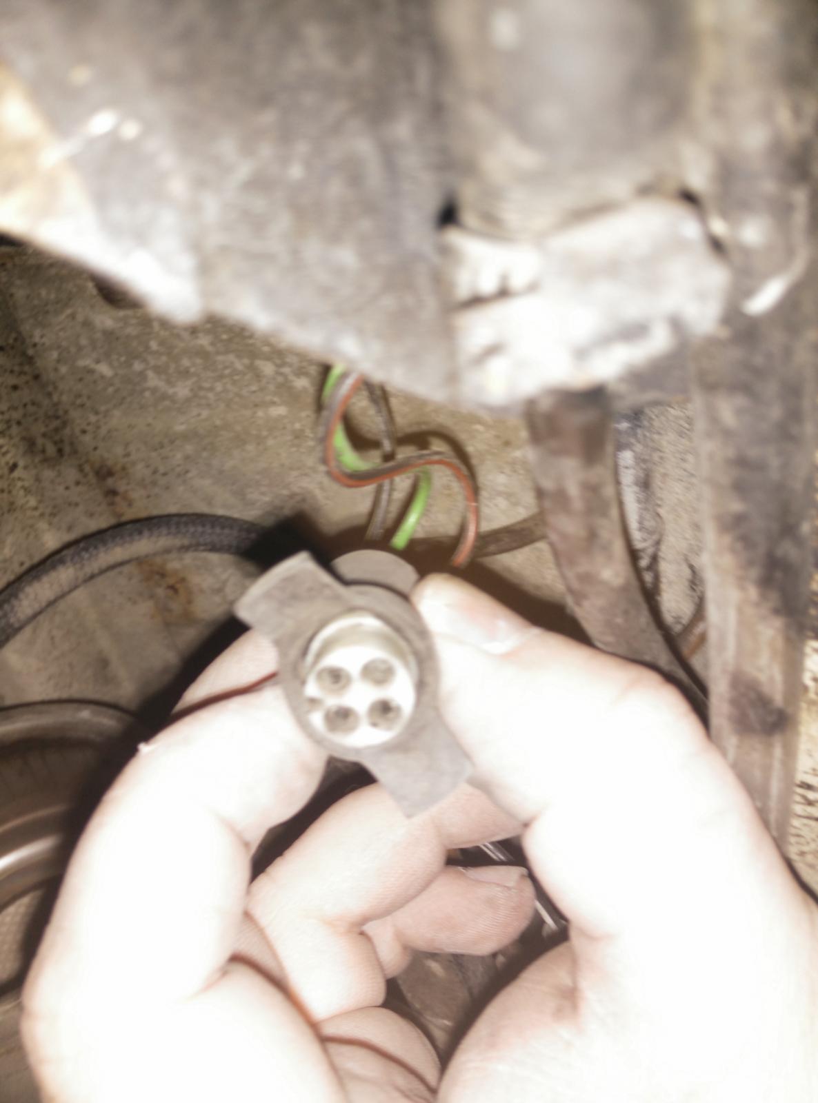

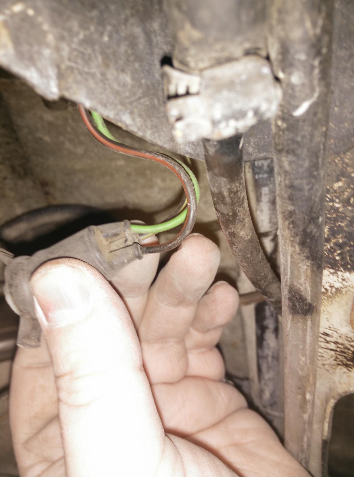

Ground wire that attaches to the screw on the side of the blower under the rubber cap
This connector only goes on one way

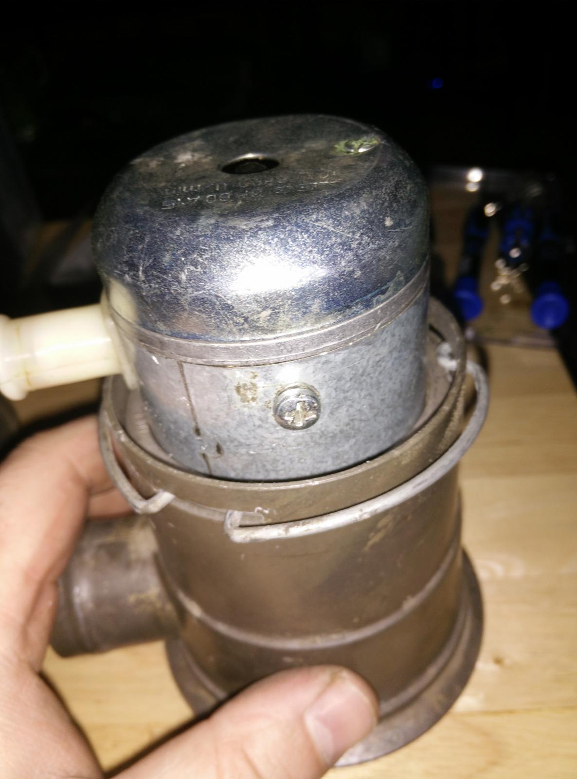

Here's the blower out of the vehicle, remove the sing bracket that holds the top on. It will slide off loosely
Start wit removing this hex screw through the little hole:
After the top should slide off like so:

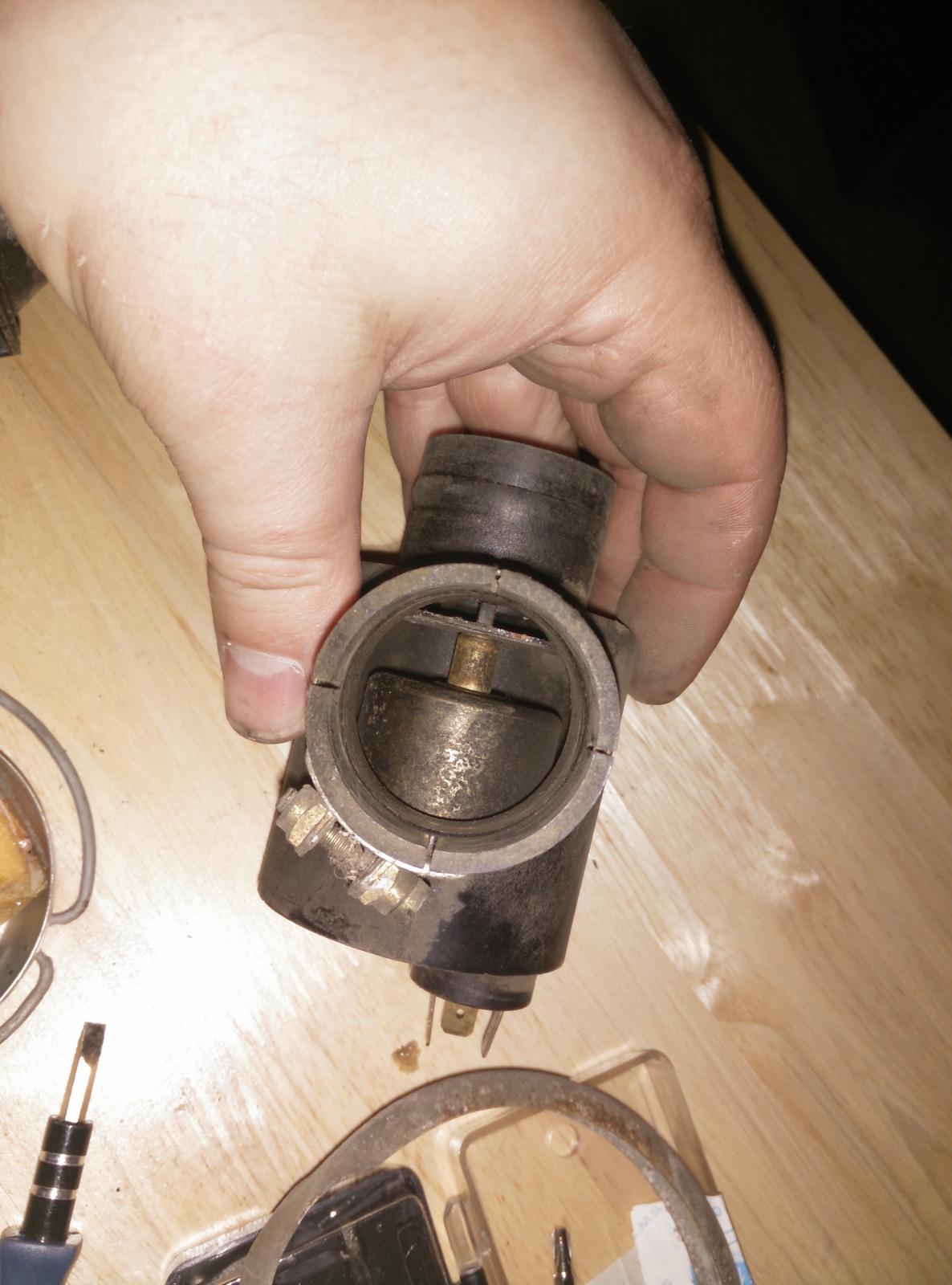

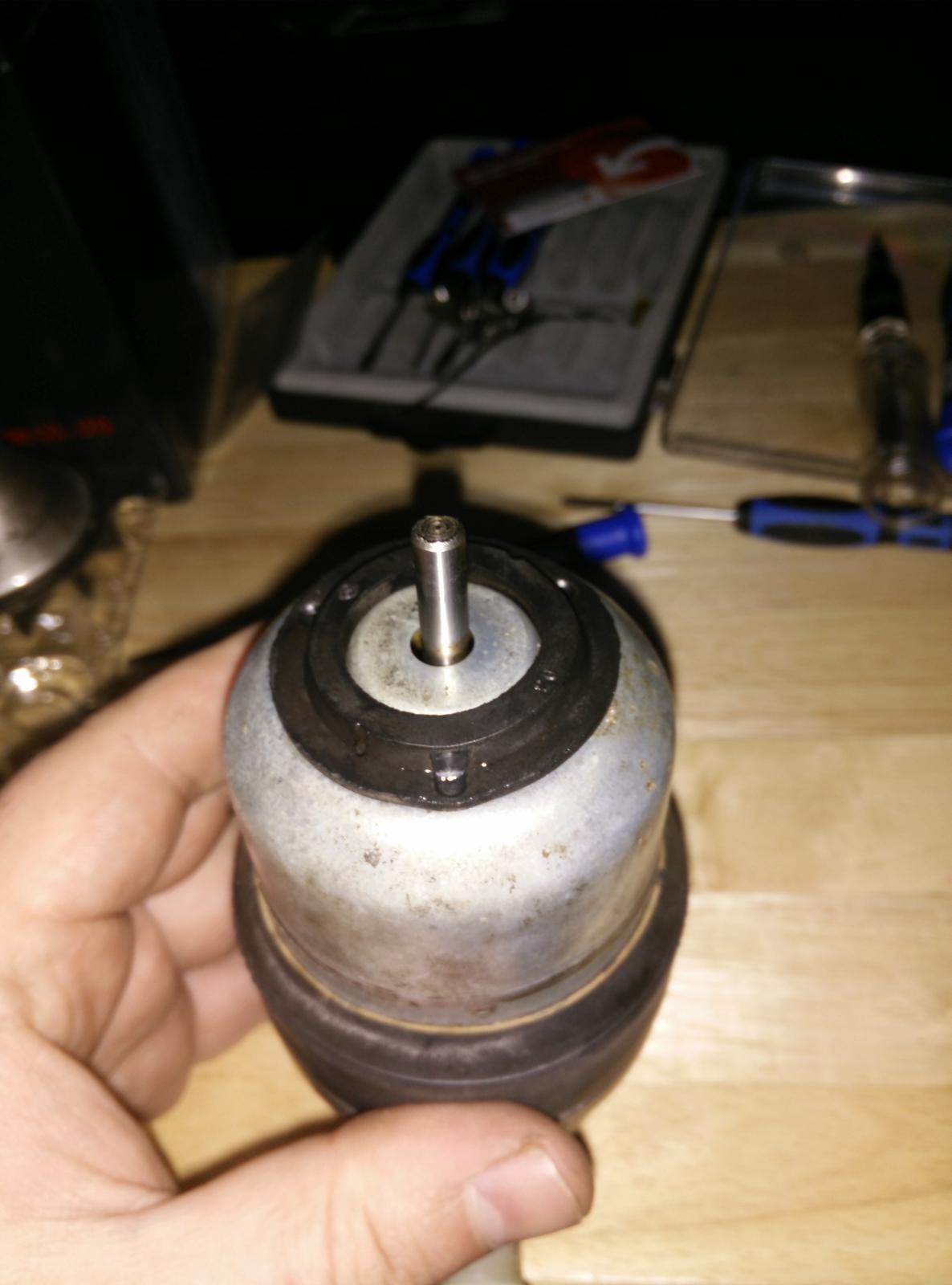

The bottom should have a flathead screw, remove it and the bottem is exposed
There is a contact switch here that runs the spark, which is moved by the rotation of the spindle at the center. Make sure the contacts show connectivity, I used a probe and a spare 12v battery
Contact is at the bottom of this photo:

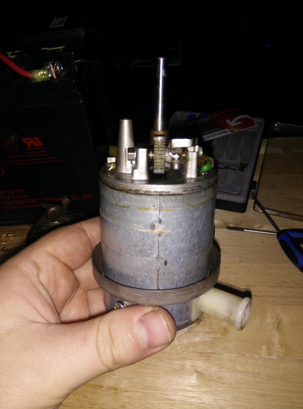

Here's the spark assembly with the 2 screws removed, there's not much adjustment that can be done on this one. I cleaned the contacts up a bit, but they were working for me before.
remove the metal retainer clip, it's easy.
Now this housing should slide right off (with some force/help)
It will now look like this:

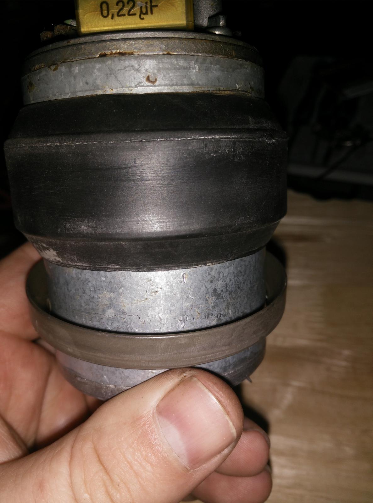

This ring will go back on the same way, so keep that in mind:
The rubber band will slide off, I used a flat head to get under it and loosen the rubber.
And now remove the top rubber seal

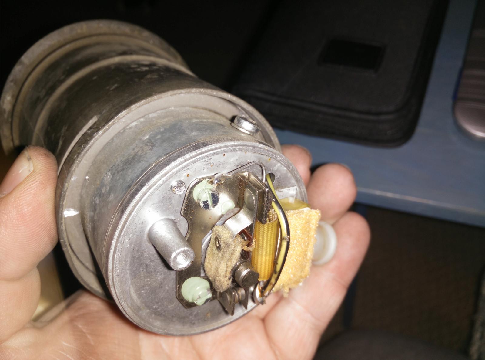

Now remove the screw at the top here:
This will expose the Fuel switch contact and assembly:
Again I used a probe hooked up to the ground of a 12v battery, and positive hooked up here:
I used my probe here:
the top contact was hot, but the bottem wasn't contacting right. I removed the bottom contact (make sure you remember the order of isolator washers,) washed it and scrubbed it, and lined it back up to the top contact after putting it back in. Still no contact with my probe. So I removed the top contact (because I have the bottom lined up I know where to align it after.) I scrubbed it also and put it back in and I had contact. (make sure you align it correctly) YAY!

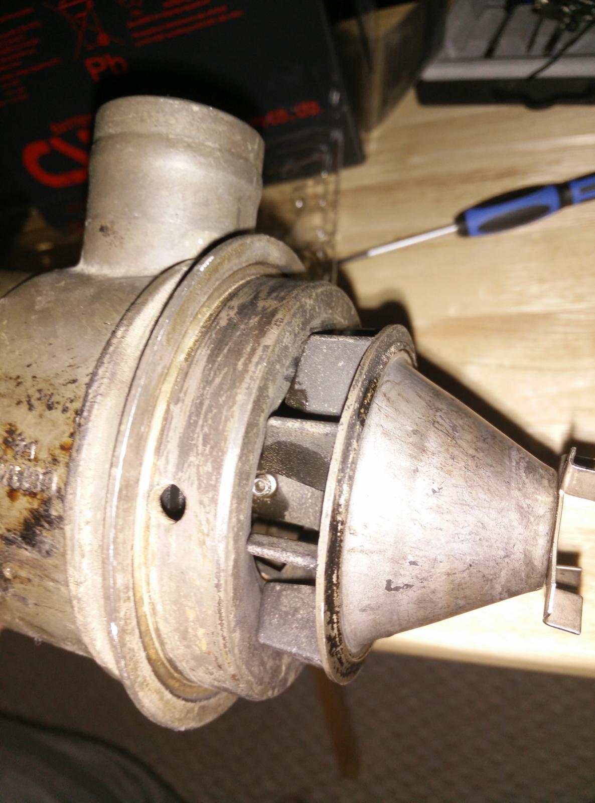

And I believe this is the air intake for controlling the airflow, it attaches to the large side hole when all assembled.

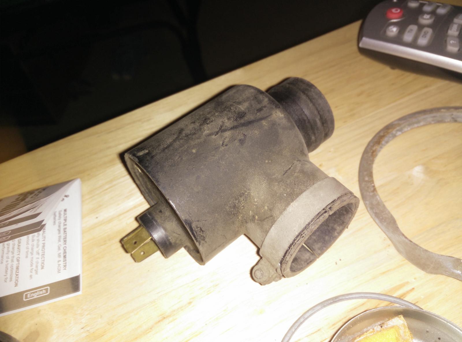

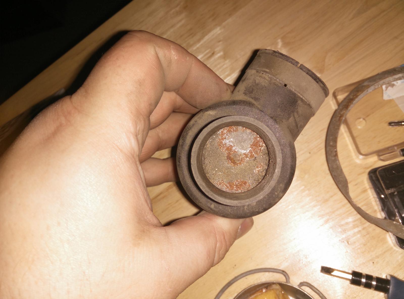

However when I removed it I found that this component wasn't hooked up to anything.
Any suggestions on why this wouldn't be hooked up? Is this a DA6 heater component? (I wiped down the service tag and the body is of a DA6 heater, but it is working on gas)
