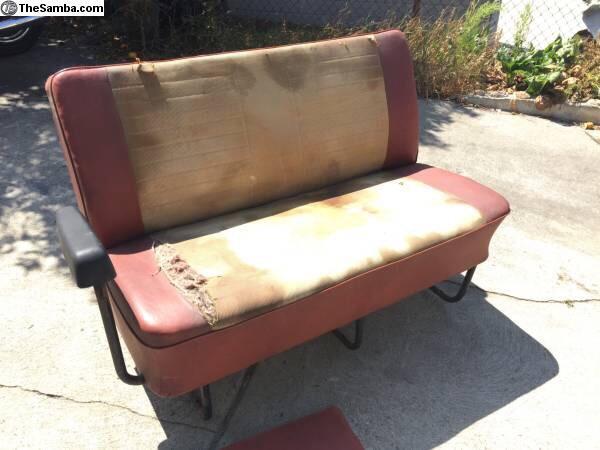

43. Red Middle seat

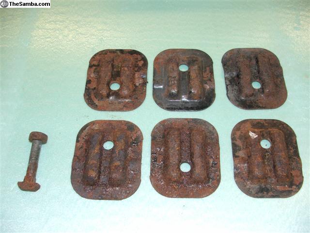

31. Middle seat clamp and stud

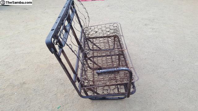

15. Center seat frame out of a 78

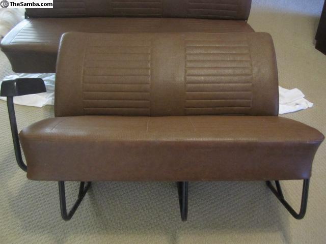

Fits a split screen from 1967 as well. Rare Dogtail (armrest which comes from the back)

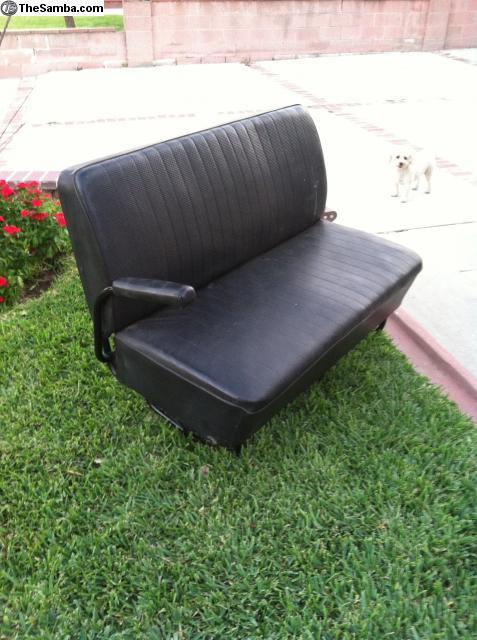

5. 1970 Middle seat
4. 70's owner called it a 70/30 split.

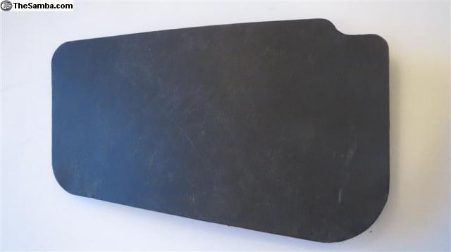

1. Middle Seat Trim Panel

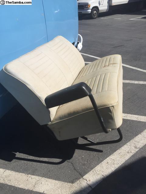

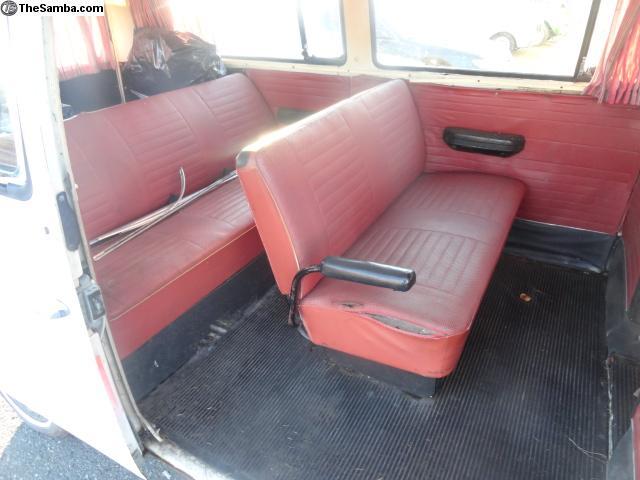

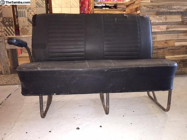

All right! So, is this destined to be a "middle seat identification" thread? That would be good (or at least to have one somewhere). I can make some contributions. And photos. Here's what I have now:

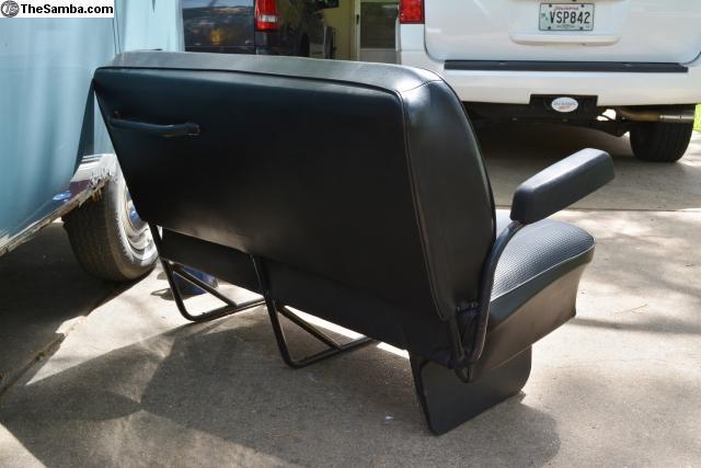

- a three-person (3/3) middle seat from left-hand drive (LHD) 1972 or earlier, with nice original upholstery
This one has no headrest tubes, black basketweave upholstery, a handle on the back, an ashtray on the back with a silver frame, and a roundish knob for rotating the third seat forward. This also has the older-style seat belts, with the gray lever to release.

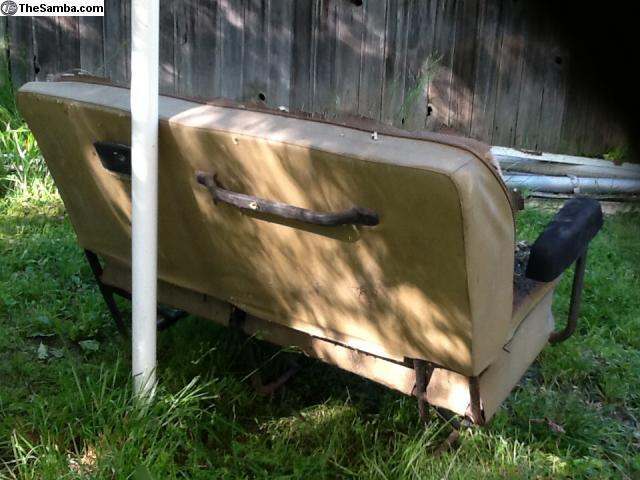

- a 3/3 LHD seat from 1973 or later, with ratty original upholstery.
This one has tubes for headrests, beigeish basketweave upholstery, a handle on the back, an ashtray on the back with a black frame, and a squarish knob for rotating the third seat forward. This uses the newer seat belts, with the orange push-button release.

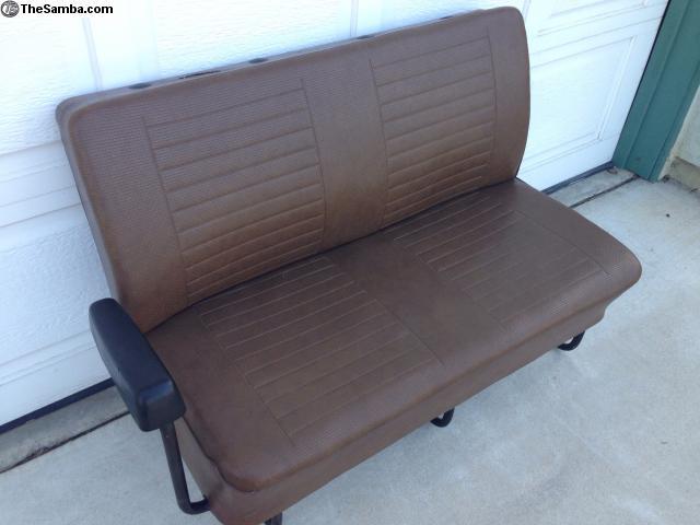

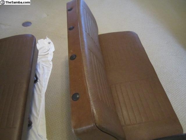

- a 19?? 2/3 middle seat for a LHD bus, nice canyon brown basketweave upholstery. Armrest is attached at back only, seat back has handle and ashtray with black frame. I don't know the year of manufacture, but it matches perfectly the canyon brown interior in my 1979 Transporter, Snickers.
Seat documentation photos should include overall view, plus these details: upholstery type, 3rd seat knob type, ashtray, headrest tube holes (there or not), headrests if original style, and... what else, folks? Maybe upholstery details to aid in identifying the proper replacement stuff? Pics of the underside?
Should we split the thread into 2/3 middles and 3/3 middles?
Also - a note on Tcash's first photo of the 3/3 black seat: If that headrest is original , that seat is 1976 or later.
I also notice several inaccuracies in TMI's tables. For example (just one example of many) they group the middle seats into '68-'73, but there was a change in 1973 to headrest tubes. I suspect that is also the time the change was made to the squarish lift knob. Is TMI interested in correcting their information? I hope so, because I am going to be ordering from them a full set of new upholstery for my 1973 9-seat Wild Westerner, and they need to get it right! Smile With the information they have in the table, they wouldn't.
This is going to be fun.

PostPosted: Thu Jul 07, 2016 2:57 pm    Post subject: Middle (center) seat Clamps Reply with quote
middle seat clamp advice

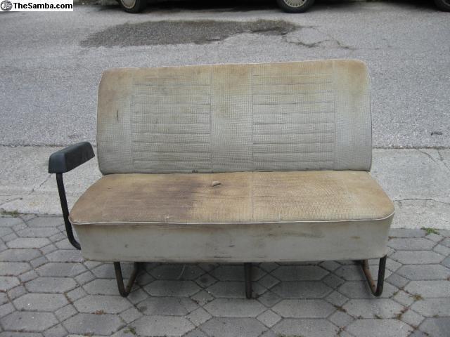

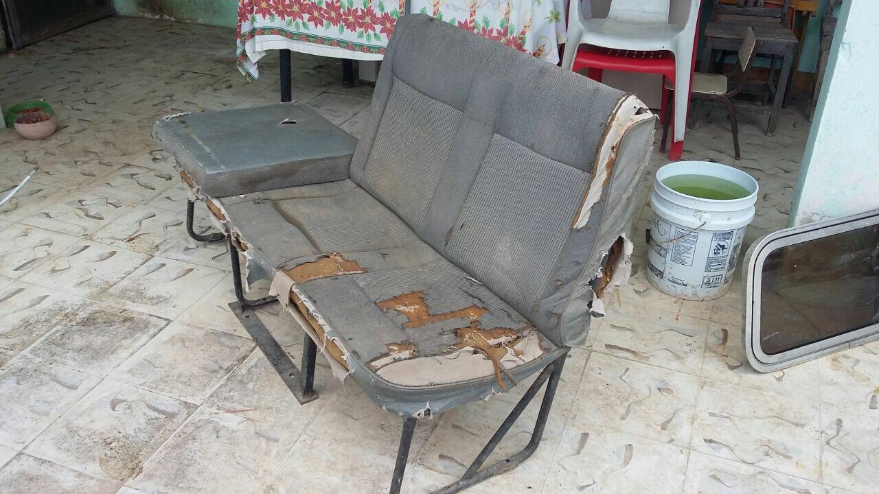

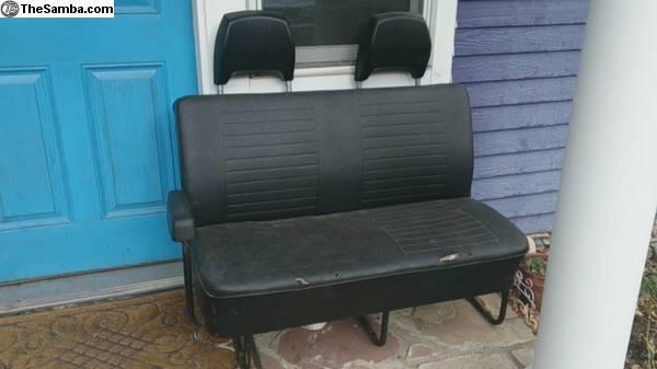

I'm rebuilding my 74 bay window bus and like many others, it doesn't have a center seat.
So, I got two choices: this one, close to home, I can pick them up on saturday for 30 bucks.
Clamps alone will cost more.
Or this:
Cost is a little bit more, but under 80. Those would have to be shipped to me, but that's not an issue.
I'm just wondering the ID of the gray one, because it kinda feels like the bottom ones are more like mine:
Can anyone give me a proper ID on all? Thanks.
jtauxe Premium Member
Joined: September 30, 2004
Posts: 5980
Location: Los Alamos, New Mexico, USA
jtauxe is offline
PostPosted: Fri Jan 26, 2018 10:58 am    Post subject: Re: Middle (center) seat identification Reply with quote
A full-width middle seat for under $100?! That's a steal. The first one you show has some odd flat bar on the bottom -- not original.
One in good shape can get close to $1000. Check out the classifieds!
Consider that by 1974 these middle seats would have had provision for head rests, so you may with to look for that, too.
And yes, you will need 8 clamp sets to secure it, and then the very-hard-to-find special middle seat belts.
And fresh upholstery will set you back a few hundred, if you want to go there.

Thanks. Yeah, it's been a pain to get everything. I think I can get the clamps from Customandcommercial and the belts from another european place I can't recall just now.
The extra bar was an aftermarket thing, I'm sure. I think the seats look more like a 90's thing. they look different from mine.
I'm still going to go junkyard diving and see if I can scrounge other options.
