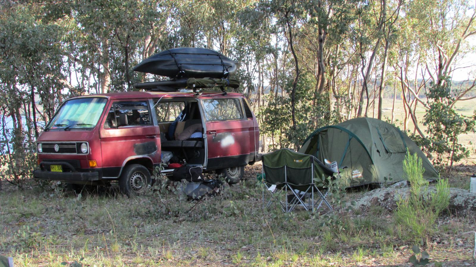

Hi,
I have just been reading some of the posts on lifting a 2WD but didn't find anything on using syncro springs to do this. I was wondering whether I coud use front and rear springs to lift my bus, as I was told to get springs from a ford for the front. Was hoping that the sycro springs would do. They are in good condition. Also wondering what, if any, other mods are needed, particularly to the front, such as steering, sway bar etc.
Thanks
Included 2 photos from a trip I did near the end of 2014 with her. Over 2000kms covered in 2 weeks finishing with a Kombi Klub weekend.
