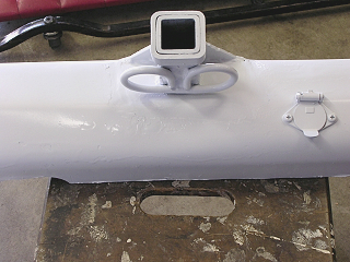

I bought the lowered bus model for my 15 window and once installed it was rubbing the apron and the pressed bumper would not go on. I love the exhaust so I did not want to get rid of it. I looked at it for a bit and realized that the flanges could move forward about 3/4" and that would make a big difference. I reluctantly cut off the flanges and bored out the old welds and re fitted the whole muffler forward and tilted down slightly. Fits very nicely now and you can't even tell its modified.
Why buy what you can build.
Red Fau Veh
Joined: September 07, 2012
Posts: 3037
Location: Prescott Az.
Red Fau Veh is offline
PostPosted: Fri Mar 27, 2015 8:07 am    Post subject: Reply with quote
Cool Jeremy, and now you have the thing in the way of a nice hitch! Are you going to make a hitch to work with the VS system because I need one if you do. Cool

jeremyrockjock
Samba Towbar Builder
Joined: January 01, 2002
Posts: 5008
Location: Richmond, Verjinya
jeremyrockjock is offline
PostPosted: Fri Mar 27, 2015 8:45 am    Post subject: Reply with quote
That would be really tricky. There's not much room for a hanger

jeremyrockjock
Posts: 5008
PostPosted: Sat Mar 28, 2015 4:42 pm    Post subject: Reply with quote
One of my "rules" when making accessories is to not have to modify or damage any OG VW parts to install it. Wink

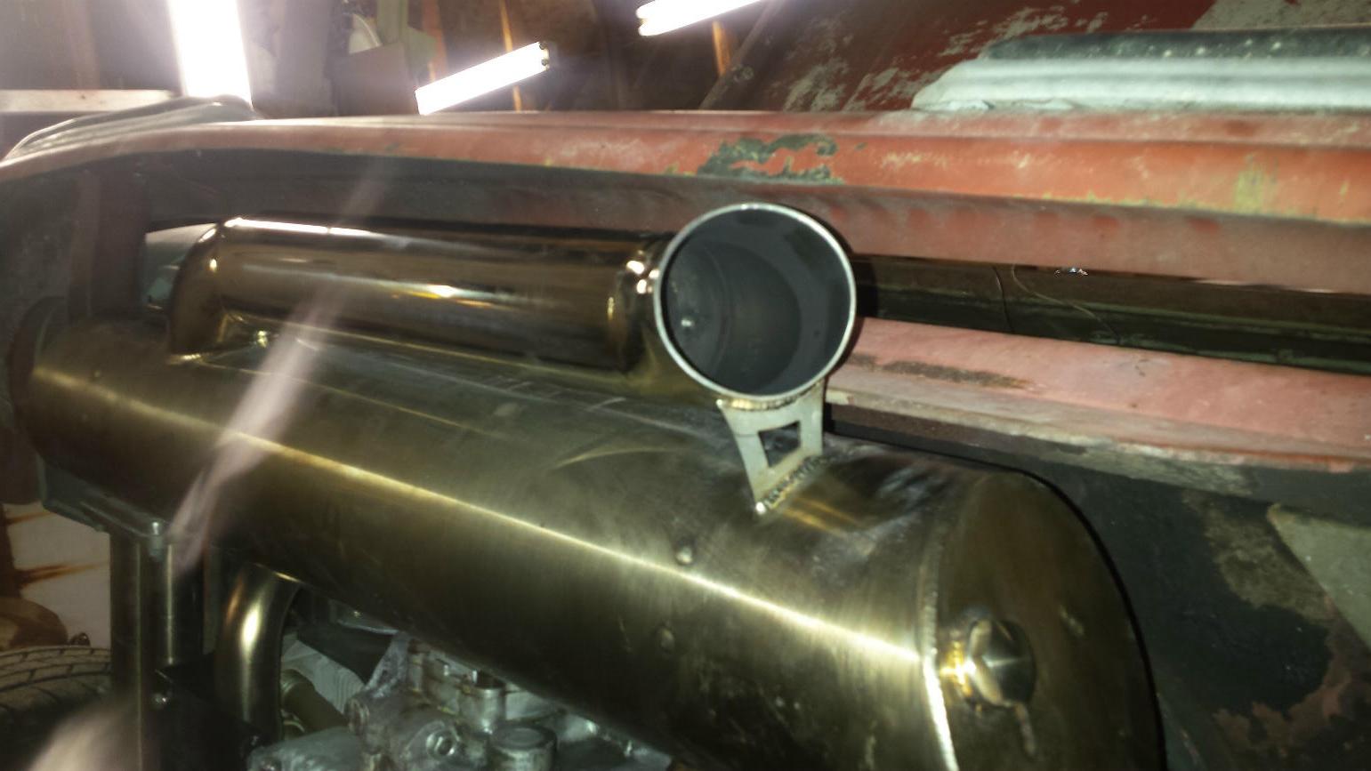

FTR, the bumper I grafted unto the hitch was an already bent repro I got for some $20. Cool
On topic, I wonder just how much actual research the aftermarket manufacturers do when designing exhaust systems and other stuff!?! Confused
With the sidewinder I also had to get the MONDO muffler modified as the tail pipe was too close to the bumper/hitch braket. Though Tiger at A-1 took care of it within minutes, I belive that could have been avoided with a little more effort in developement. Just like you found that slightly "shorter" pipes makes your Vintage Speed muffler clear the apron. Eh?
Before:
After about an inch cut short:

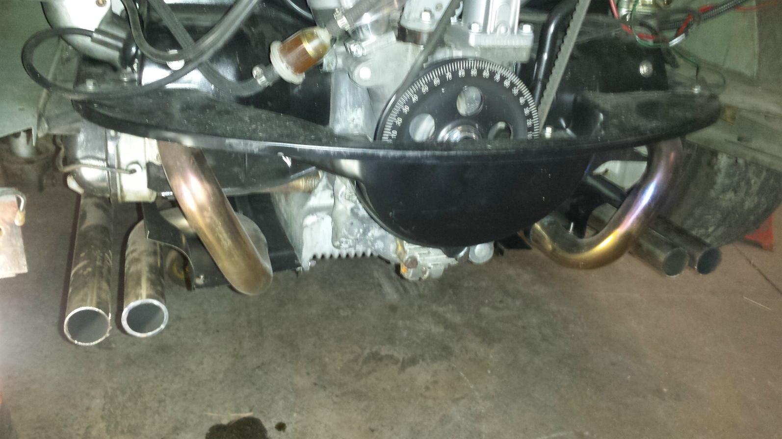

PostPosted: Mon Mar 30, 2015 6:30 pm    Post subject: Reply with quote
I really like this exhaust but I'm curious if anyone else has experienced the same thing that happened to me. This actually happened twice. 2 liter motor, stock height, nothing out of the ordinary. This is the driver side header and it completely separated from the flange that goes to the head.
Anyone else?

PostPosted: Thu Apr 02, 2015 6:57 am    Post subject: Reply with quote
Just wonder since the exhaust has to be tweeked so much, and tightened in a certain way that it produced stress on the flange and when stainless gets hot it gets hot and caused it to separate and also maybe not a very good tig weld....tig welds can look pretty but dosent matter without the penetration. I would think vs would stand behind his product, and replace it?
mg6770
Joined: July 26, 2005
Posts: 843
Location: North Shore CamPbodia
mg6770 is offline
PostPosted: Thu Apr 02, 2015 7:50 am    Post subject: Reply with quote
Yes they do stand behind and provided me with a replacement. The replacement is the one in the picture. I got about 18 months of use out of it until I noticed it did the same thing. I've been in contact with them again because I discovered a crack on the exhaust itself where it connects with this header. I sent them a picture of it and he said they'd replace it. One thing that has me skeptical is that they asked for a P.O. (purchase order number) from when I purchased it 3 years ago so I've got some searching to do (paid in cash.) To their credit, he has kept communication with me so I'll see how this plays out.

PostPosted: Fri Apr 17, 2015 9:58 am    Post subject: Reply with quote
mg6770 wrote:
Glad to update on my situation. Vintage Speed stands by their product and is a good company to buy from. As well I'd like to give John at TopLine Parts a big thank you for helping me in the matter. I purchased this exhaust through John in 2011 (even earlier than I thought previously), paid cash and he gave me a receipt. Since then they have upgraded their internal system and everything is logged digitally. I was skeptical because that meant he had to dig through boxes of old receipts just to verify mine. Well after talking with him, John did that very thing and found my invoice. He then contacted VS and they sent out a new one immediately. I'm very pleased with there customer service. I'd definitely recommend this exhaust.
