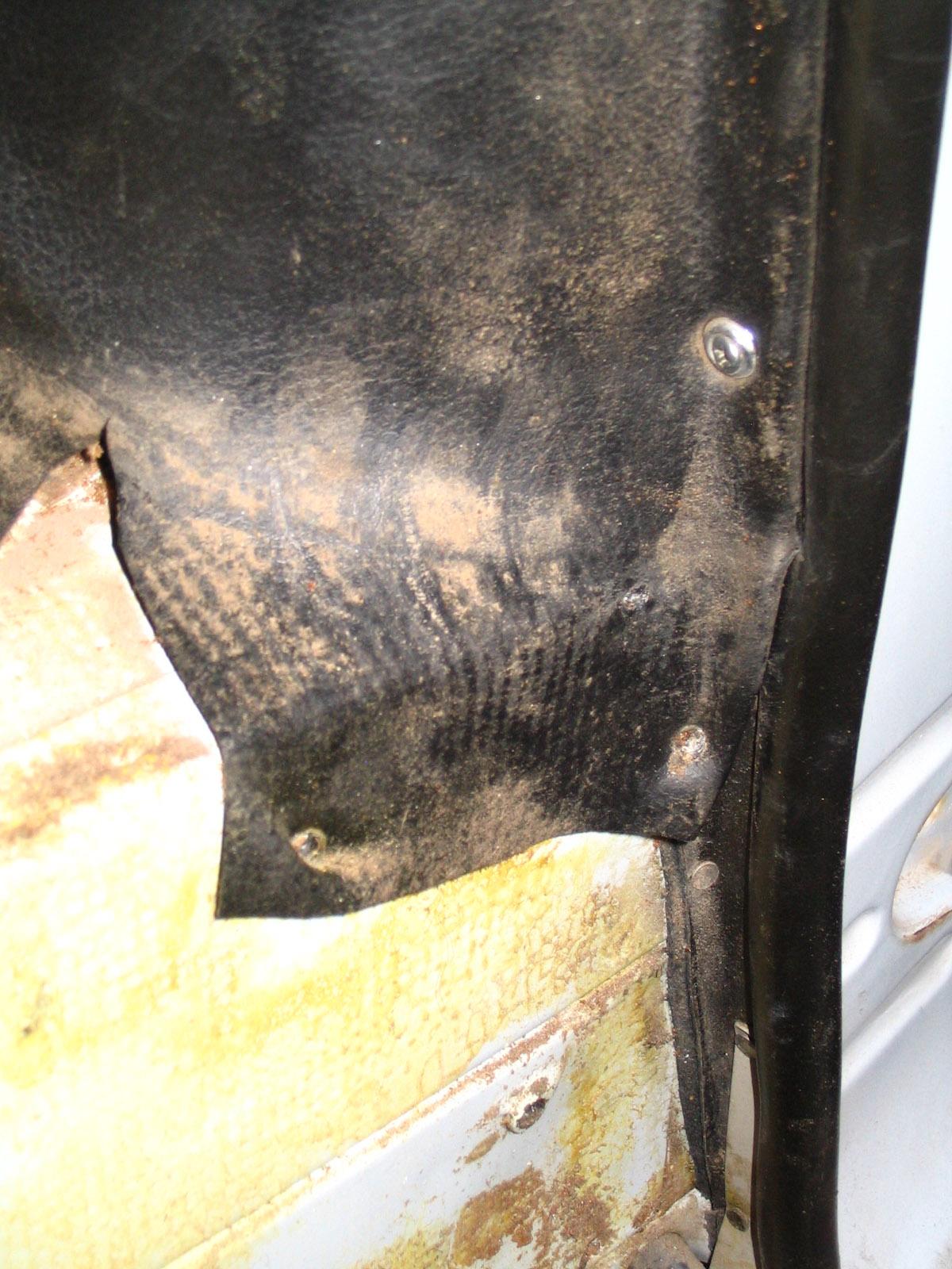

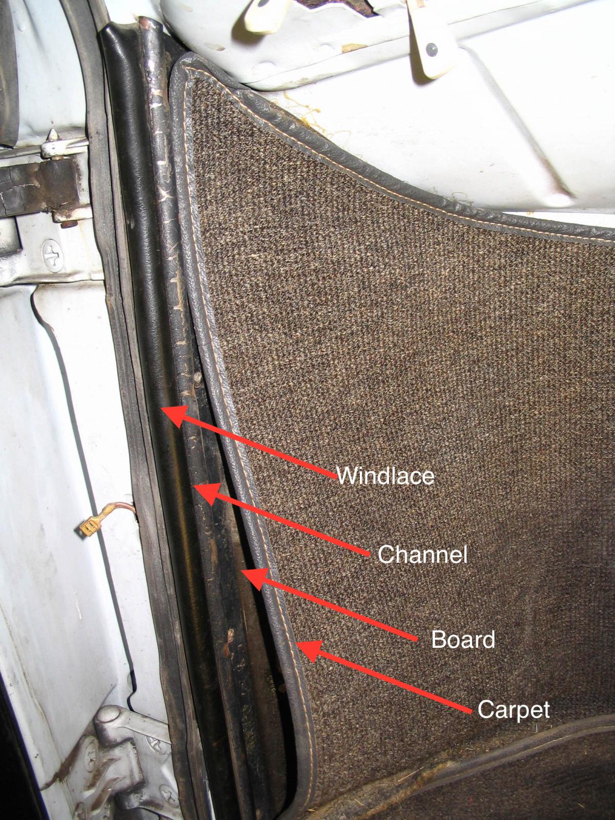

Thanks for the photos. A couple of interesting things:
1) The lacing appears to be held on with carpet tacks/nails as opposed to screws
2) I looked at that color chart and if what you are saying is true that it would match the seats, then my wind lace would be brick red. I am inclined to think it should be off-white though to match the parcel shelf per the color guide...
I saw a guide somewhere else that indicated the shelf was supposed to be off-white, but it didn't mention the lacing.
3) Inside the wind lacing is just a plain ol rubber hose - my plan is to go to auto zone, buy some rubber tubing with the same diameter and have my seamstress sew the vinyl around it.
4) The board in your photo is the kick panel - I will be posting a photo with accurate template dimensions this evening. I was able to source an untouched one I can use to recreate.
Mostly yes for the lock pillar. There are a few screws at the top as part of the chrome trip. At the bottom is an "L" shaped piece of metal that is nailed in over the top of the windlass that gets covered up with the carpet
At the Kick panel, its all held in with screws

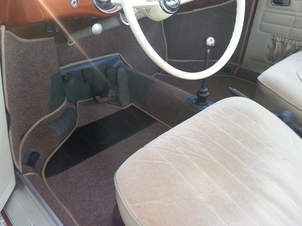

After installing my Newton Commercial carpet kit, I've had people ask where I purchased the windlacing from... I didn't. That's the cloth binding on the carpet:

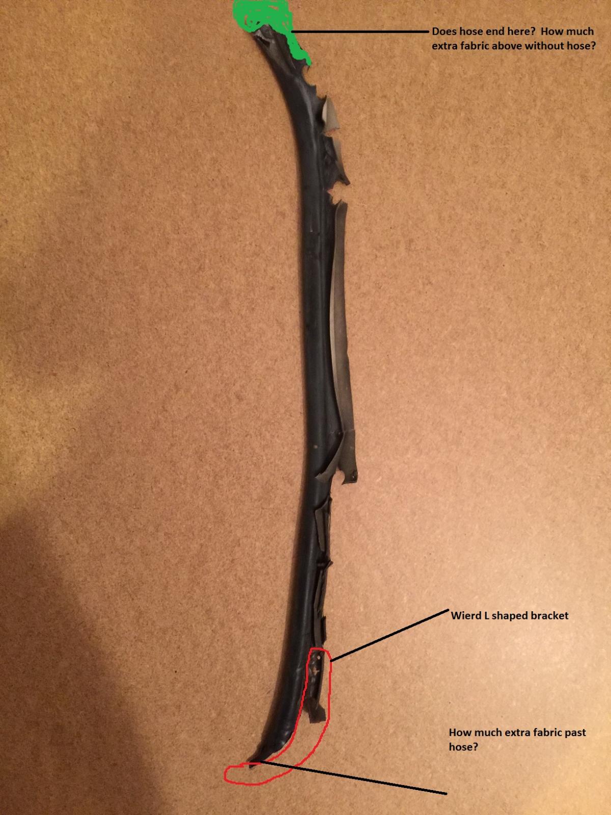

I could use some help from you gurus again. I was able to source an old windlace set from the front and rear of the door. The one in front is easy to re-make. It's 18.25 inches and straight.
But the rear vert windlace I procured was in horrible shape and broken. I need to remake it, but I can't tell how many inches past where the rubber hose ends there should be. Not sure if my photo helps...
