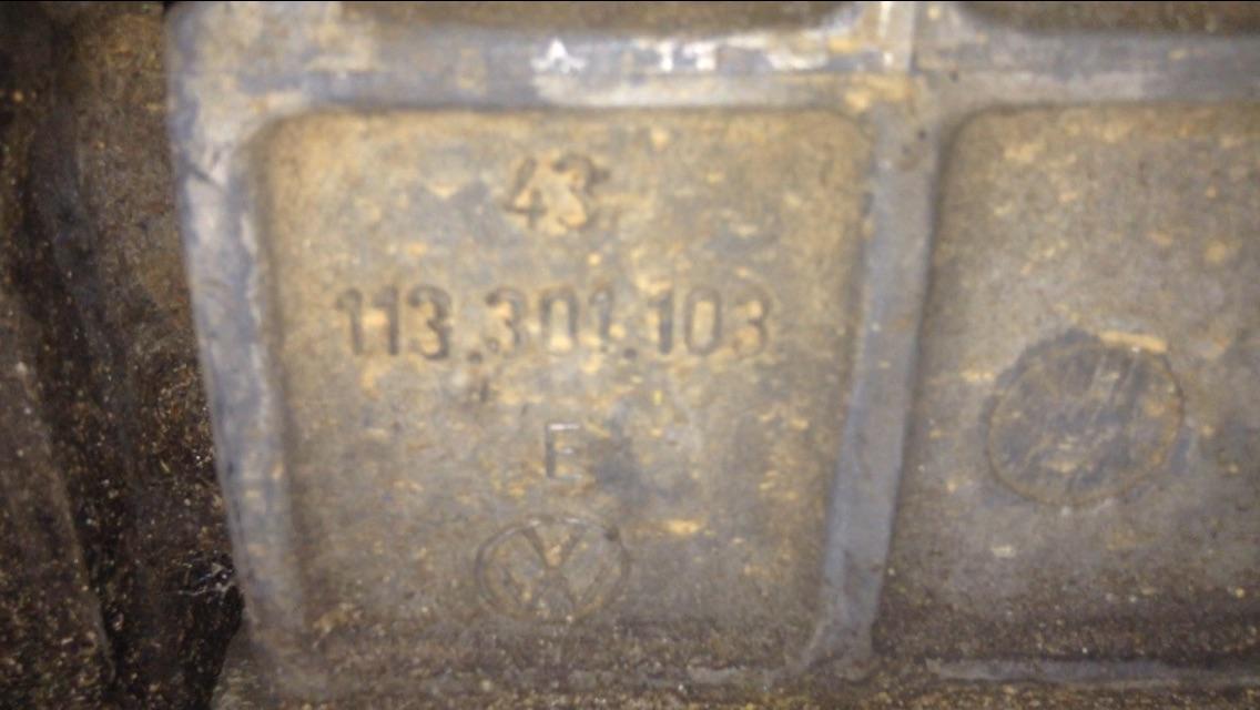

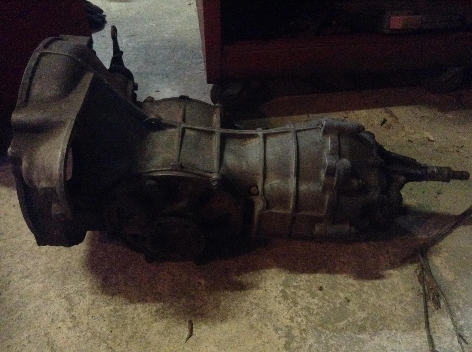

PostPosted: Sun Apr 05, 2015 6:41 pm    Post subject: Reply with quote
Got a transmission for 10 bucks Cool appears to be in alright shape,
Anyway to tell what year it's from? Told its IRS . These are the only numbers I was able to find easily.

PostPosted: Wed Apr 22, 2015 5:15 pm    Post subject: Reply with quote
well progress is slow, I haven't really had any problems to fix - not complaining about that! I got my spare shift rod and cage that came with the trans, getting a new cage next week - I'm just going to use the original Vw parts, and only the Plastic from the new one. got to look at the trans - it is an AH code, gunk was covering the letters.
