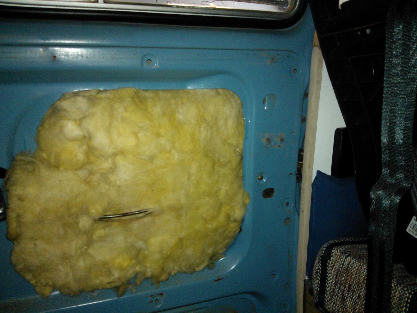

PostPosted: Sun May 10, 2015 4:23 pm    Post subject: Reply with quote
These are the pics of the sliding door with the panel removed. You can see to mounting location for the second handle. I like the idea of a loop-strap type handle for this location...that may be the way I go.

IIRC the second handle is a early westy only part.

I believe it is a square post that screws on there, and the standard inner handle mounts on that. At least that is the way it is on my '83.
