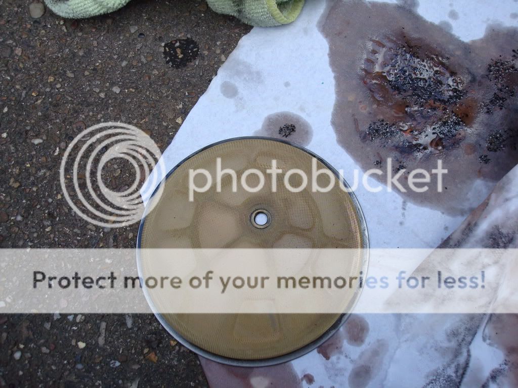

Drop the filter cover and remove the filter..it looks like this:
The transmission service kit should look like this:

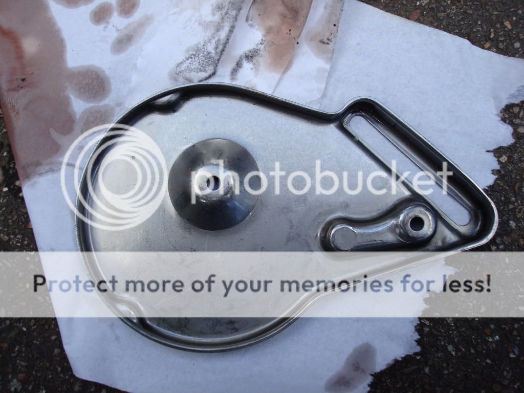

Clean everything up..the ATF pan and filter housing..brake clean works well. Don't leave any trace of cleaner or paper towel in the pan or housing..clean is good.
Remove and replace the paper gasket..install the new filter (it goes back as the old one came out..it should only fit one way) and centering the filter housing/filter with one of the two phillips screws in the middle of the housing..finger tighten the housing back to the valve body. Then install the second phillips screw. tighten both screws up. Torque spec is 26 inch/lbs..snug.

Hopefully I can get some insight into this head scratcher. I just did the AT filter and gasket kit. Torqued everything down and then followed this from AtlasShrugged:
"No leaks? Good. Lower the Vanagon and with two quarts of ATF inside the fresh clean pan..start the engine..in park..at idle..level ground and check your ATF level..it is probably just barely on the dip stick..let the engine warm up. With the WBX original ATF/water cooler installed once the cooling fans come on..re check your ATF level..you may need to add 1/2 to 1 quart to get the ATF reading on the dip stick right in between the MIN and MAX mark...engine running, in Park..transmission now warm.
Go for a drive for about five miles and then again recheck the ATF level..in park, engine running..it should be up close to the MAX mark..good.
Do not overfill the transmission with ATF..or underfill too. Just at or slightly below the MAX mark with the transmission at operating temperature is good."
I put 2qts of Type F ATF (recommended by TF). Took it for a drive and had a very scary thing happen. Just before I got back home (about a 12 mile run) smoke started pouring out the back. The smoke was coming from the top of the final drive/tranny area. No fire just smoke that smelled like grease, not oil. Today I jacked it up again and checked the gear oil in the differential/final drive. (What is the correct terminology?) Oil right to the bottom of the fill hole.
I started it up again and let it warm up. I kept checking the tranny dip stick but couldn't see any oil. Being colored blind I waited for conformation from the wife and she also said, NO oil on the dip stick when engine is warm and running.
I turned it off and after a few minutes oil appeared to just below the lower mark.
WHAT is going on? Anyone??????? Please?????
'85 Westy
'07 FJC
'02 Camry
AtlasShrugged
Joined: October 30, 2008
Posts: 1605
Location: Decatur, Ga. USA
AtlasShrugged is offline
PostPosted: Fri Nov 18, 2016 5:30 am    Post subject: Re: Dexron III vs VI ATF in Automatic Transmissions (revisited) Reply with quote
Two quarts ATF with a filter change, drain and refill is just fine..which is perplexing as what it sounds like is the transmission blew out ATF from the breather port on top of the transmission like it was over-filled with ATF (a classic over-filled symptom) and yet your dip-stick indicates too little ATF after your drive home.
Could be the transmission was accidentally over-filled, the spinning internals "frothed" the ATF with air..blew a good amount out the breather..then when you got home..the ATF level settled and the aeration in the ATF settled out and your level was now too low..
I would again..without a 12 mile test drive...start the engine..in park..hand-brake on, on level ground..let the engine warm up and check the ATF level with the dip-stick. Once the cooling fans have run a couple of times..the ATF level should be at the MIN mark or a little above.
If your having a hard time seeing the ATF level on the dip-stick (it happens sometimes) have an assistant with good eye-balls check it for you.
Don't drive the Vanagon until you have confirmed that the AFT is at or slightly above the MIN mark, in Park, at idle, on level ground, engine and transmission warm (radiator cooling fans have run a couple of times)
Once you are certain the ATF level is good and not under or over filled then do the test drive.
