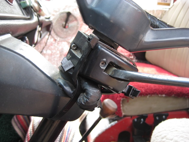

Thanks for the reply. It confirms the fact that I don't want to use drag link adjustment to correct the problem. I talked to Gary this morning and he has a steering wheel puller and I might just borrow it from him or head South and do it there. I don't especially want to pull the turn signal switch and steering wheel, but that may be the best route unless I can get a different rebuilt box with the correct groove orientation.
It took some effort to get my turn signal repairs done several years ago.
