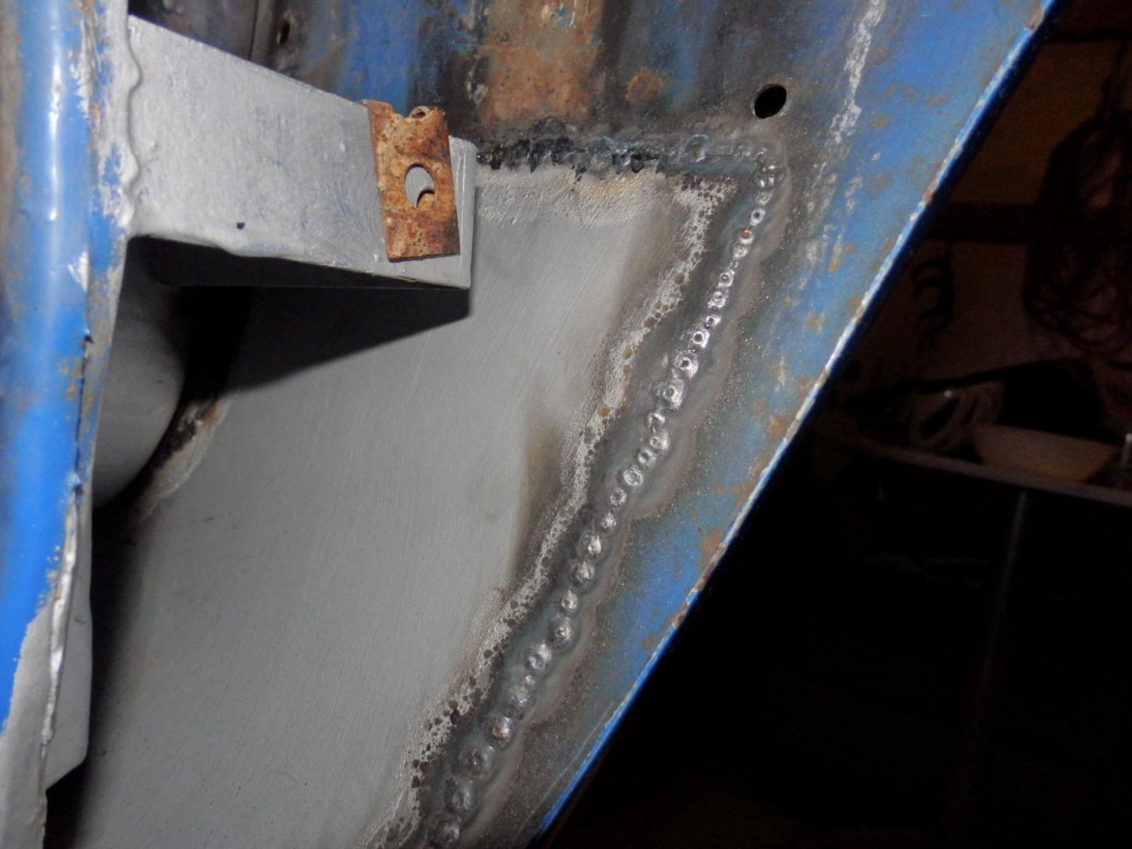

Mellow Yellow 74 wrote:
But haven't you made this harder than it needs to be by cutting the panel?
The way you have done it you will need to do two vertical welds in addition to a horizontal weld whereas if you used the full repair panel (trimmed to the required height) you would only need to do the one horizontal weld plus the spot welds at the bottom.
Note that this is not a criticism, just a question - I am about to do the heater channels on my 62 and your thread has been really good.
I don't mind my mistakes or inefficiencies being pointed out (in fact I'm asking for them), so thx for doing that. I've got nothing to hide!
I cut out just the center section so that the body didn't "release" in case it was in tension. In fact, this happened to the rear fender which I think contributed to my door gap headaches. This is probably a lesser issue in an undamaged car, but mine has been in a fender bender or two. I was also thinking that replacing just the center section would eliminate having to mess with the contour on the patch panel and door gap but that is probably not a big deal. I will probably do as you say and cut the whole thing off when I replace the other channel, because fitting has definitely taken me way more time than the actual welding. There is definitely an art to fitting panels.
Anyway, here is the front-of-door panel finally fitted and tacked in...
And welded in...
The backside showing full penetration, though I think I can get by laying down less metal. I'm getting more comfortable slowly figuring out the little nuances of how long to hold down the trigger, where to aim, when to let the metal cool, etc. Fun fun fun...
So this is where she stands now and onto the rear fender...

PostPosted: Wed Jul 29, 2015 10:34 am    Post subject: Reply with quote
djway3474 wrote:
Go to a hardware store and look for a thin Fiberglas aluminum backed insulation for pipes or ducts. If you can't find that since the temperature is low enough here you may just find a jute padding and wrap that around.
Original material is like thick wool that I'm guessing allows air to percolate through but deadens the sound. I found some foil-backed pipe insulation, but it was dense foam that seems to restrict air much more. So I'm sticking with the original and hoping I don't breathe in too much of the particles. But I did learn a nice scrabble word... jute!

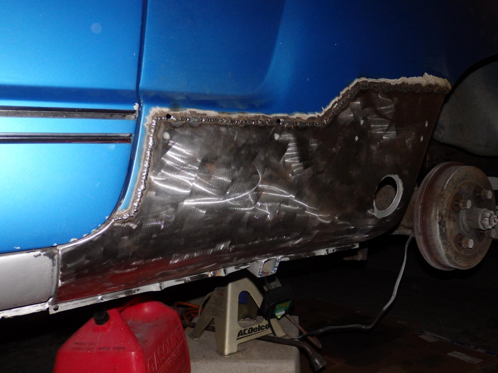

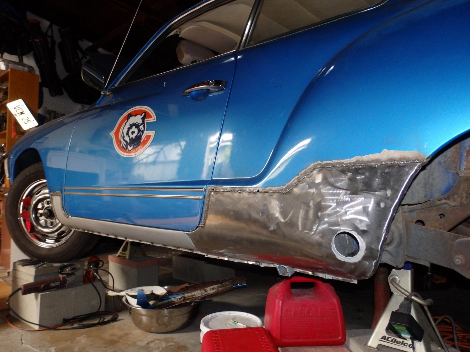

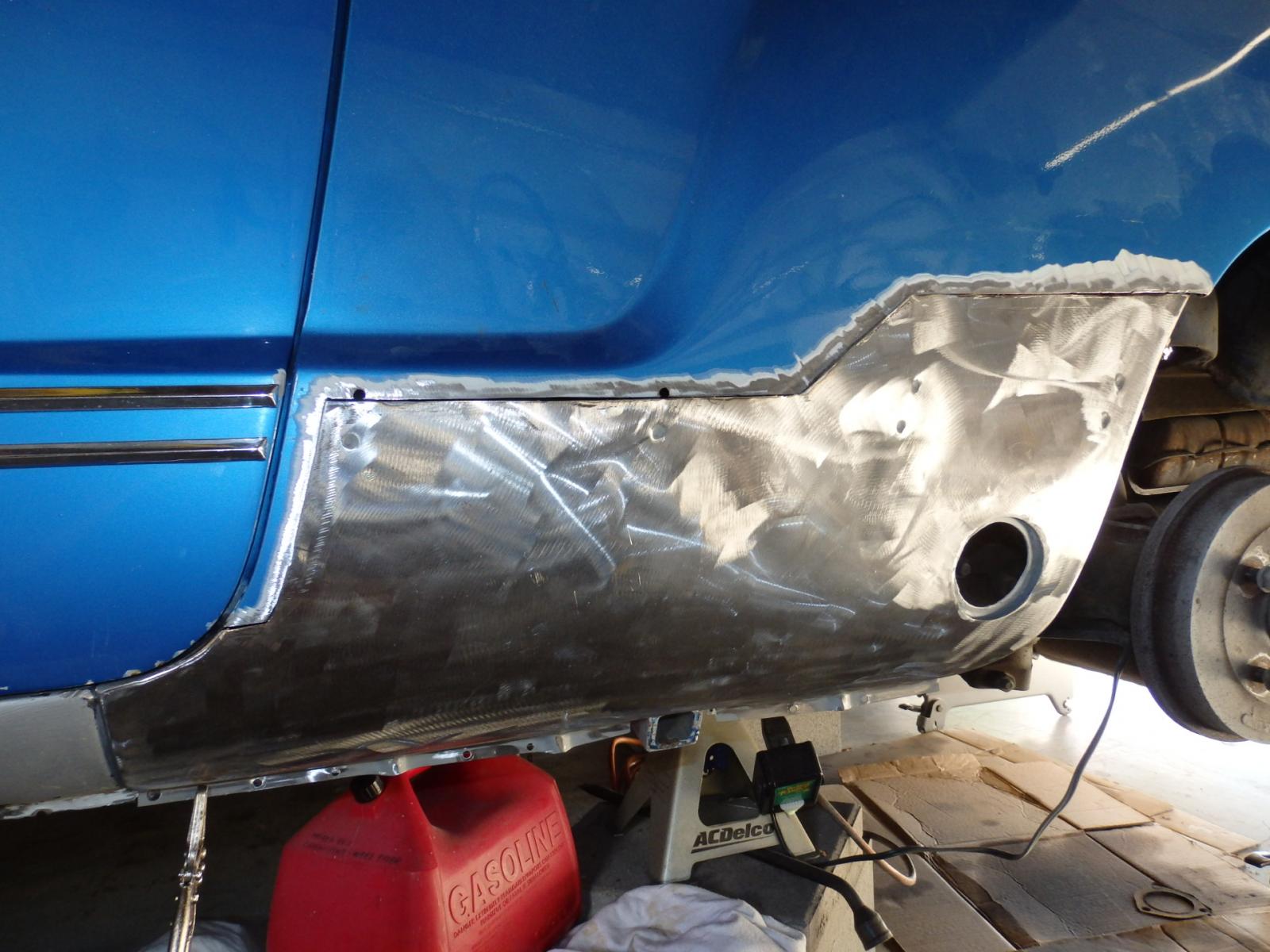

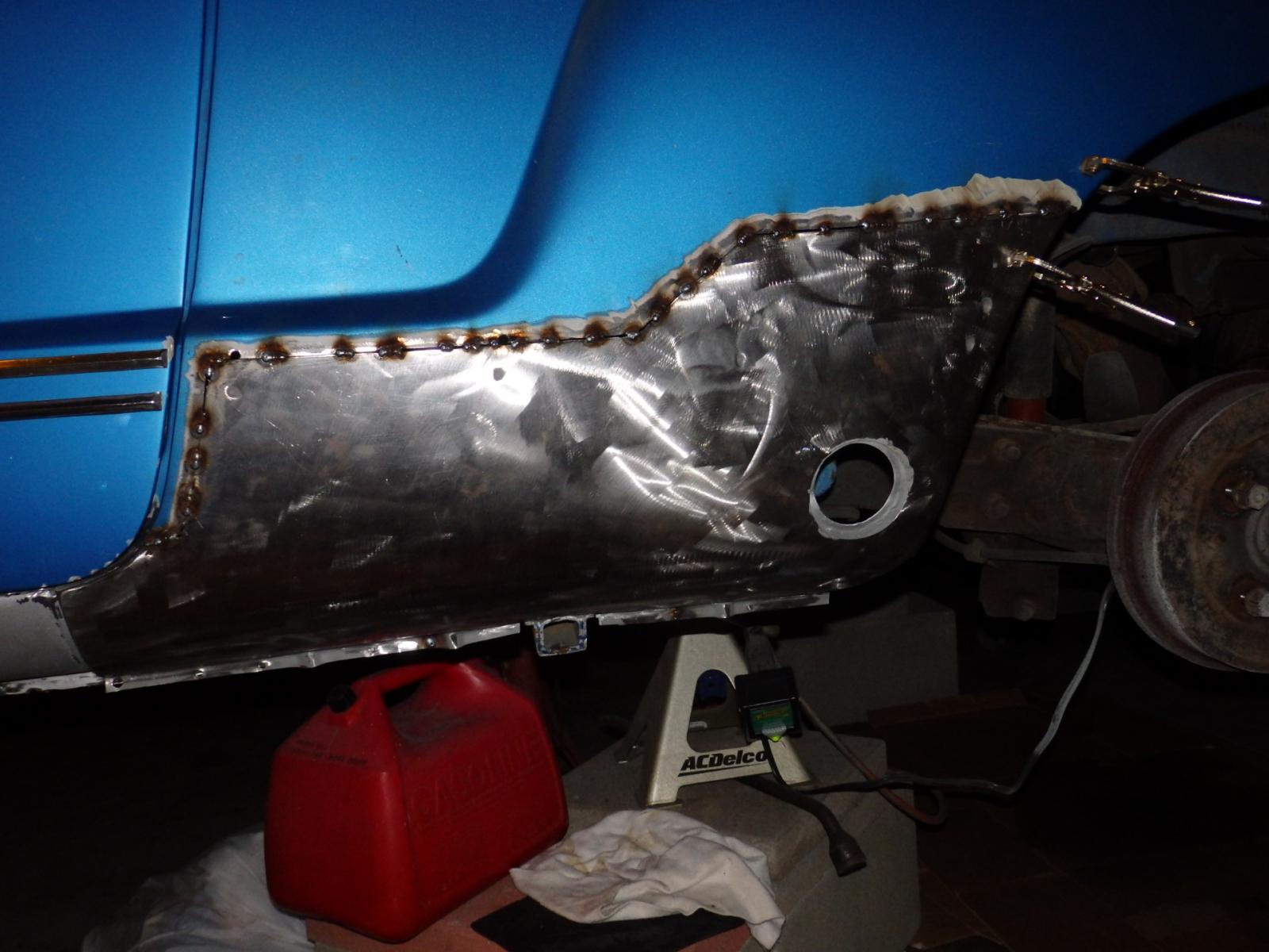

Well, the rear fender panel is on. Once again, fitting was a challenge. It may have been the panel itself combined with how the channel and rocker was put in. In my case, when the panel was matched at the seam, the rear edge at the wheel well did not match up (in other words, the panel was too long). So pull out the wrench, hammer and wood block and do 100+ trial fits.
Btw, as opposed to the front fender where using the full patch panel might be easier than trying to preserve original metal, I think the rear fender would be easier preserving as much of the the corner at the B pillar as possible. Otherwise, you're adding work to rebuild the piece for the panel lip to lap on top of. Anyway, trial fitting...
Stitching...
And in. Oh, btw the panel came in gray primer and I used a flap disk to take it all off since people here seem to claim it is cheap. I will MS it later...
Theoretically, I think it is road-ready, so after tying up a few loose ends I may put it back on the ground this weekend. I can deal with cosmetics later, I'm just itching to drive! Uh, but I guess that means I have to now figure out why fuel is not flowing to the motor...

Congrats J1. Looks like your practice welding is paying off, welds look good. A bit of cutting and grinding will clean up the lower rocker and its going to look fine. Only one problem, I just cant consider you an AVERAGE JOE anymore. Nice work. Very Happy

c21darrel wrote:
Congrats J1.
Couldn't have done it without input and encouragement from you and others. But the congrats are still a bit premature. I still have a little more fabbing, welding, panel beating, and lots more grinding to do... gotta make sure I don't get complacent and fall into the false summit syndrome!
I've also never used filler before so that will be another learning curve for me. Speaking of which, I had the joy of grinding off filler on my rear fender... snow in SoCal!

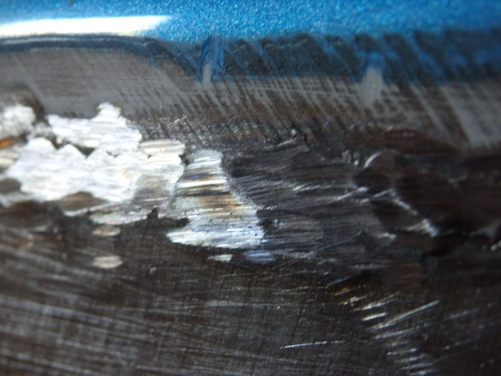

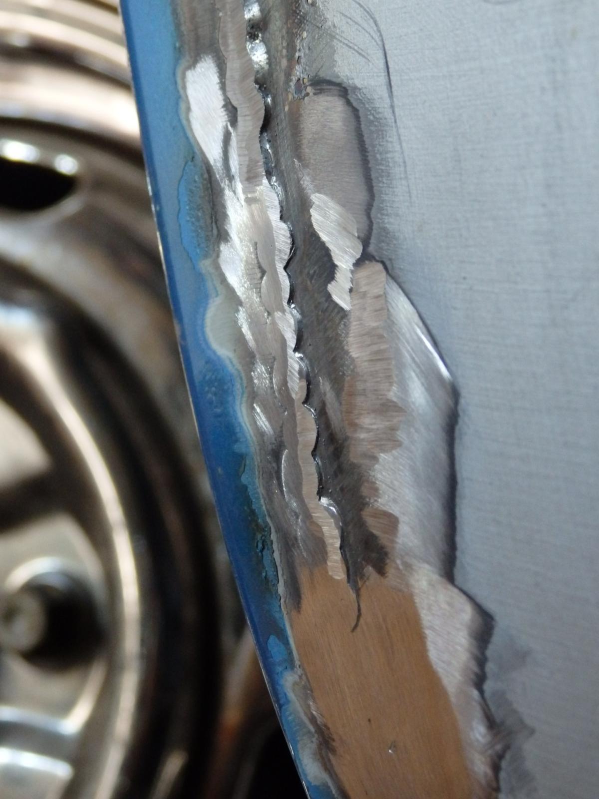

PostPosted: Wed Jul 29, 2015 2:43 pm    Post subject: Reply with quote
Speaking of grinding and filler...
QUESTION: I'm starting to grind down the welds and quickly realized I have to be careful. Seems some people use a thick-ish grinding wheel (not a flap disk or cutting wheel) and stop early so as not to grind down the surrounding metal too thin. Then use filler. I plan to do this, but how far should I go??
Bottom third of this picture shows where I used a flap disk and tried to get perfectly smooth and then said "uh oh". Middle third is with a grinding wheel and requires a bit of precision. Top third is again with a grinding wheel but don't need to be so careful. I'm thinking I should shoot for the middle third, maybe even a little closer in order to minimize filler????
1971 Ghia coupe. Assume I know nothing and you'll be pretty darn close to the truth.
CiderGuy
Joined: December 23, 2013
Posts: 1351
Location: Bucks County, Pa
CiderGuy is offline
PostPosted: Wed Jul 29, 2015 3:05 pm    Post subject: Reply with quote
I have used just the edge of a well used cutting wheel, to grind down just the weld itself.
Cars Currently Owned:
1970 Karmann Ghia Coupe
1973 Karmann Ghia Coupe - Project car for sale
1970 Karmann Ghia Convertible (Body off restoration)
Timing is everything
c21darrel
Joined: January 22, 2009
Posts: 8239
Location: San Dimas
c21darrel is offline
PostPosted: Wed Jul 29, 2015 4:49 pm    Post subject: Reply with quote
It needs to be flat....or you will be buying a lot of filler Embarassed Flatter = flush.

I use an air cutting disc tool with the thin wheel.
You concentrate just on the bead and move around. You wont build up heat and it cuts real fast.

PostPosted: Sun Aug 02, 2015 10:25 pm    Post subject: Reply with quote
I got the welds down by using a 1/8" or 3/16" thick grinding wheel on my grinder. Just got up close and carefully worked it down to this and I plan to use a sanding block to smooth it out more. I will address the filler and paint in a separate step...
