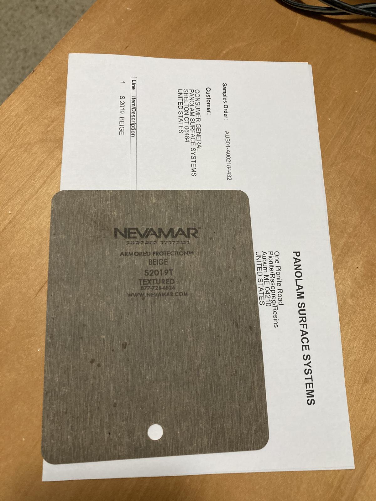

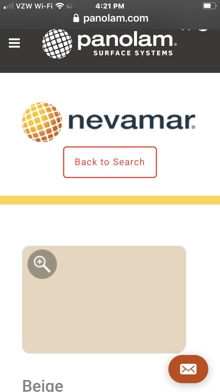

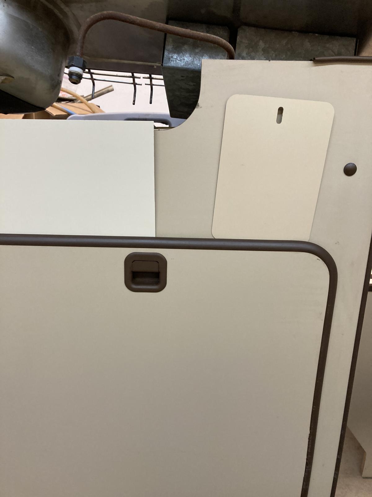

I am re laminating my kitchen cabinet to match the rest of the tan/beige cabinets. I bought from the guy in the classifieds who provided me with the wrong color of laminate. Apparently I’m the only person to complain in four years.
So I have hunted down examples of Formica and Pionite laminate for all to see and order correctly in the future.
On the left is what is provided by the samba member.

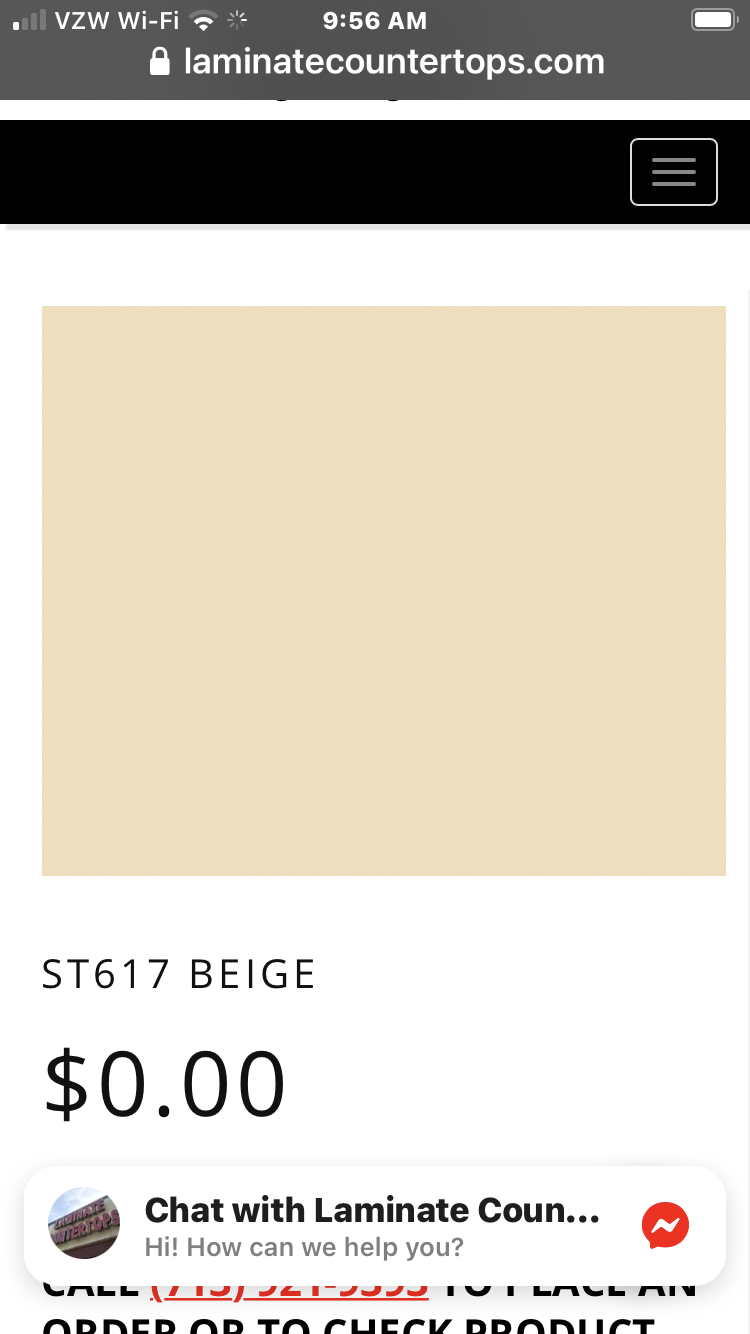

In the middle is Pionite st617.

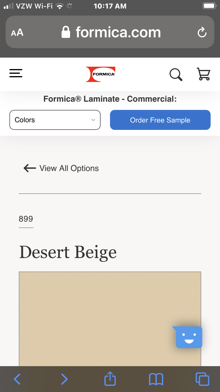

On the right is Formica desert beige in #58 matte finish.
I like the Formica the best.
More information about each.
Westy westfalia laminate color samples Pionite st617
I’ve read here that this is what GoWesty sells as part of their fridge replacement. Maybe someone can confirm?
And the Pionite money shot.
Westy westfalia laminate color samples Formica
The Formica money shot.

You might want to compare them under outdoor light, preferably overcast.
From your pix I like the Formica Desert Beige colour best.

Yea. Lighting sucked on these. Mix of different florescence bulbs.
I tried flat on the cabinet versus vertical to get some colors to develop a bit differently.
I don't think any match, but the Formica is the closest.

Based on your photos I also like the Formica over the other two. Keep in mind though that even if you could find the exact OEM laminate in the original color the odds of it matching 40 year old laminate that has been exposed to the sun and general wear and tear is slim to none.
