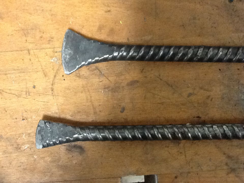

Pretty straightforward.
I clamp these in a vice pointed up and push and hammer out the dents.
When it is near as good as I can get I sand the bad areas with 150 then move up the line with 240, 400, 800, heavy cut polish then fine cut polish.
The aluminum is very thin and is easy to sand through.

PostPosted: Mon Sep 21, 2015 4:04 pm    Post subject: Reply with quote
Be sure to ask for the correct piece. The ends are all angled different.
http://www.thesamba.com/vw/classifieds/detail.php?id=1609950
Thanks, is that hammered re-bar you used to make the profile tool?
Hey thanks. I was looking for that ad. Used the wrong search terms.
Yes. I heat up rebar orange with the torch and hammer it. Do this multiple times and it gets almost as hard as tool steel. These two have lasted a long time. Also great to get to dents in hard to reach places.
