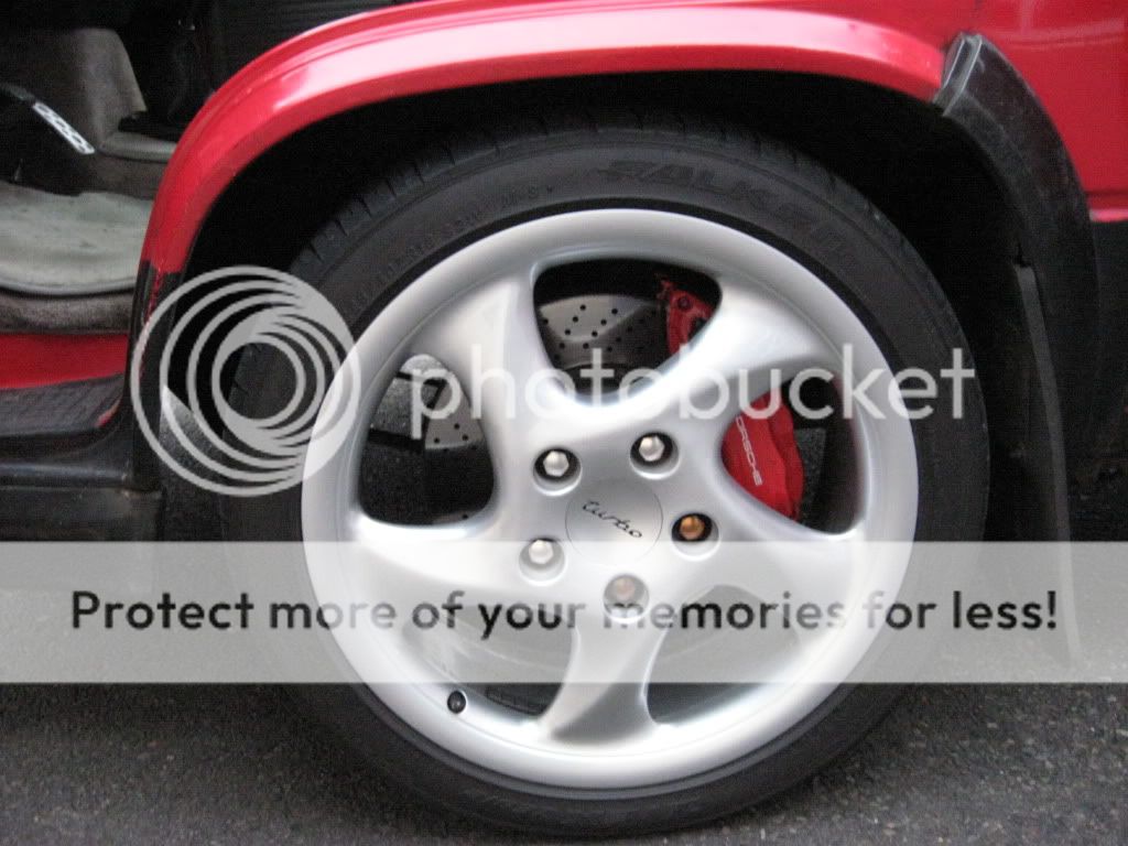

A while ago, I made hubs that have 5x130 pattern and take the 993TT brakes. They use stock vanagon bearings.
The problem with the kit was the expense. Maybe it's worth revisiting?

240 Gordy, you are probably right, but I don't think the typical Vanagon owner is going to want or need large Porsche brakes. This is more for the 'performance' van crowd that has a lot more power and wants more brake to match, and a Porsche bolt pattern at the same time. I've got $350 in just adapters to run Porsche wheels. That's a lot of money for just running different wheels - that cost helps offset the total dollar investment in a setup with a custom or modified hub somewhat.
