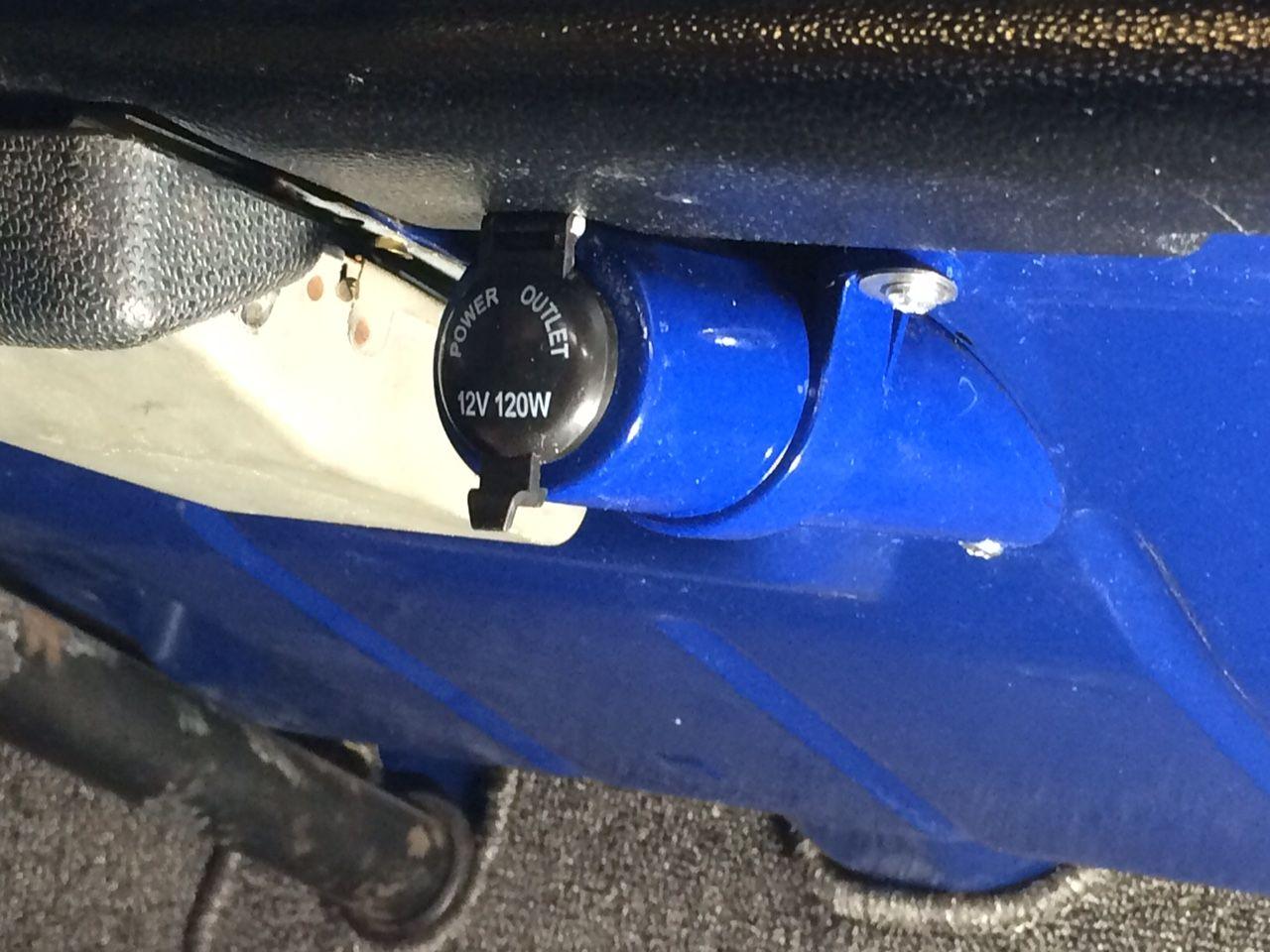

It was tempting to drill a new hole in the dash for this but prudence dictated that I put the auxiliary power outlet in a less prominent place. I used some leftover PVC pipe and a bracket and put it under the dash; still reachable and useable.

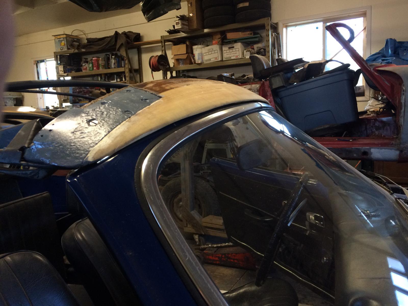

Thanks to NOVA Airhead I got enough side trim material to finish my side trim. I used an extra door piece to fashion a lower left rear quarter trim piece. I used my Oxyacetylene torch to shape and weld the point into it. I came out OK, not great just OK.

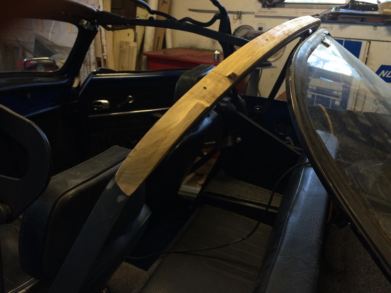

The middle bow was very easy to make. I used 5/4 stock poplar. Maybe $10 worth.
The front bow is another animal. I glued up and added more material to what I had and shaped it with a rotary buffer and 50 grit sandpaper. I nee both guide pins to finish shaping it as I only have one. They are on order with my top.

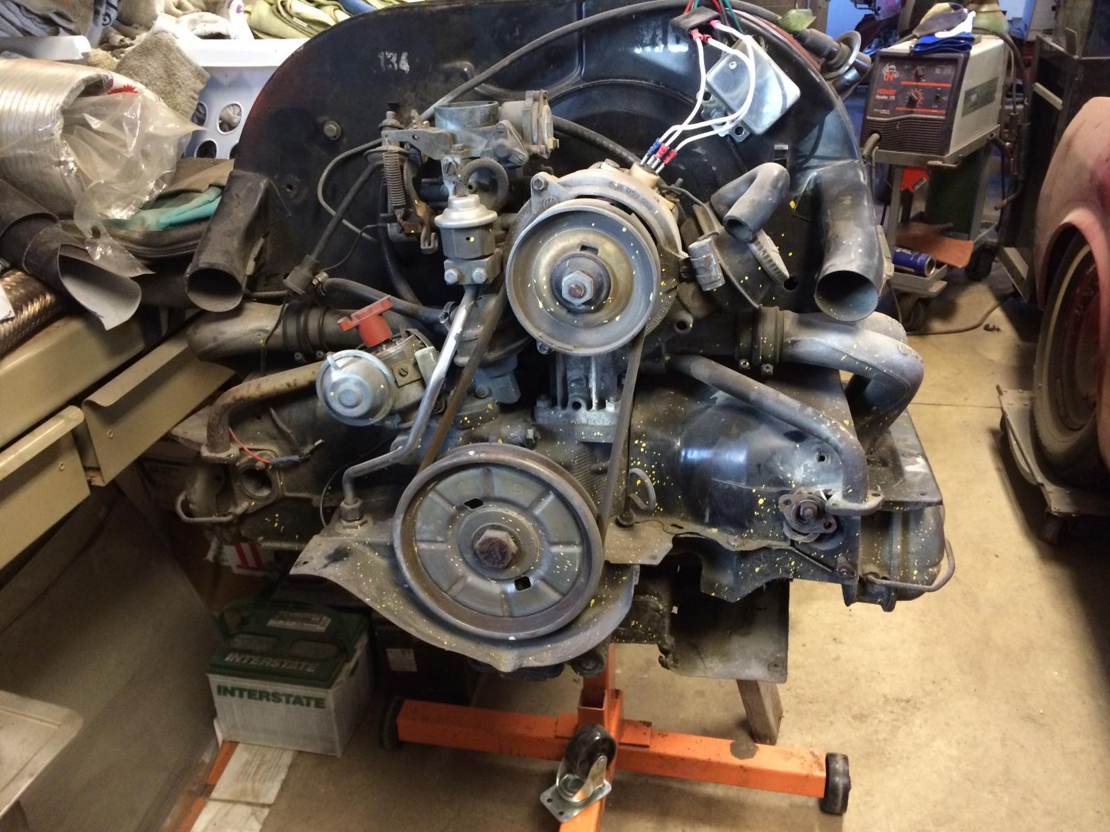

Next is to rebuild a 2nd engine I have. This is the candidate.
This is my solution for mounting it to the stand.

Good idea. I'm too cheap for that Smile 3, 3 1/4 pieces of thick wall gas pipe and some 3/16 inch flat stock scrap I had lying around. Welded to the stock supports.

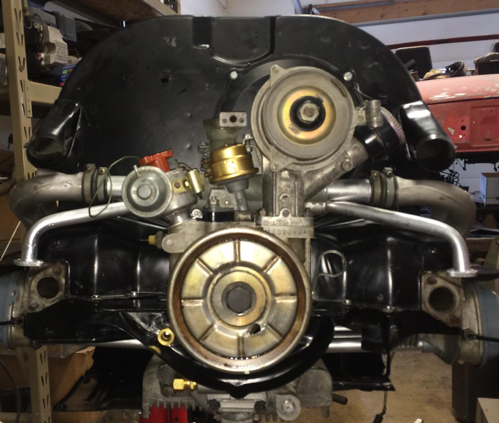

So. The engine is an AH. Bone stock. Nothing had been machined or replaced. The crank is still good. Cam and lifters worn. Most everything still within specs. I hate to replace genuine VW parts with aftermarket crap which is all I can really afford so my plan is hone cylinders, polish crank, new rings, lifters, bearings, valves, rebuilt carb and fuel pump. We will call it refreshed.

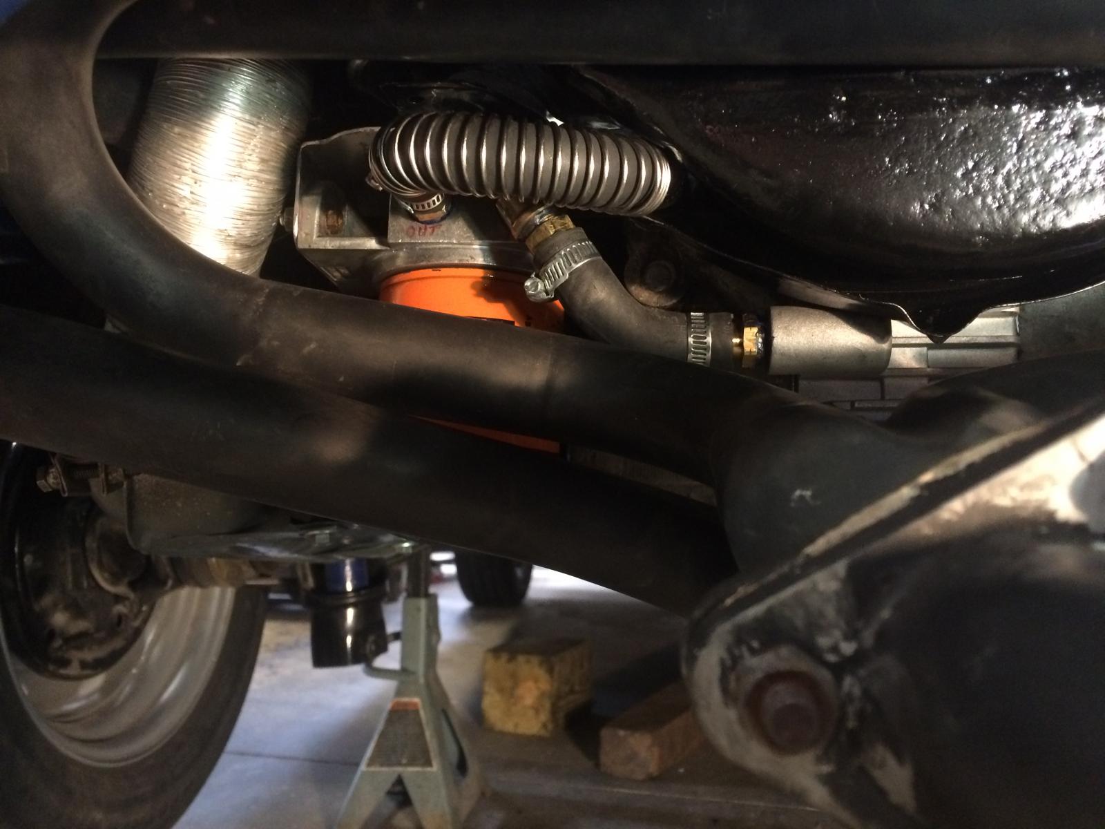

Engine is mostly back together. Went through every part, cleaned and or replaced what was worn. New lifters, bearings, camshaft, rings, valves, seals, etc, crosshatched the cylinders, plugged the outlet on the oil pump and set it up for a full flow oil filter. Fit of all the parts was good. I replaced with german, except for the camshaft.
Started to rob the other engine for its parts. I still need to rebuild a carberator. The one I had on the working engine leaked. And the other is unknown.

An engine is finally back in and running. So far it is a success. Time will tell. I tried to keep it as original in function as possible with exception to the full flow filter setup. I removed the EGR?? valve because I don't have the right exhaust to connect it to. I rebuilt the carburetor. I had to replace the fuel pump even though when I hand tested it it worked fine, it still didn't bring fuel from the tank to the engine. That is important when you want to start the car. I want to replace the nasty looking coil eventually and I need to clean the wiring up a little.
As a bonus it's upgraded with a 50 amp alternator and the thermostat has proven to work well. Oh and a brand new Sachs clutch kit.
