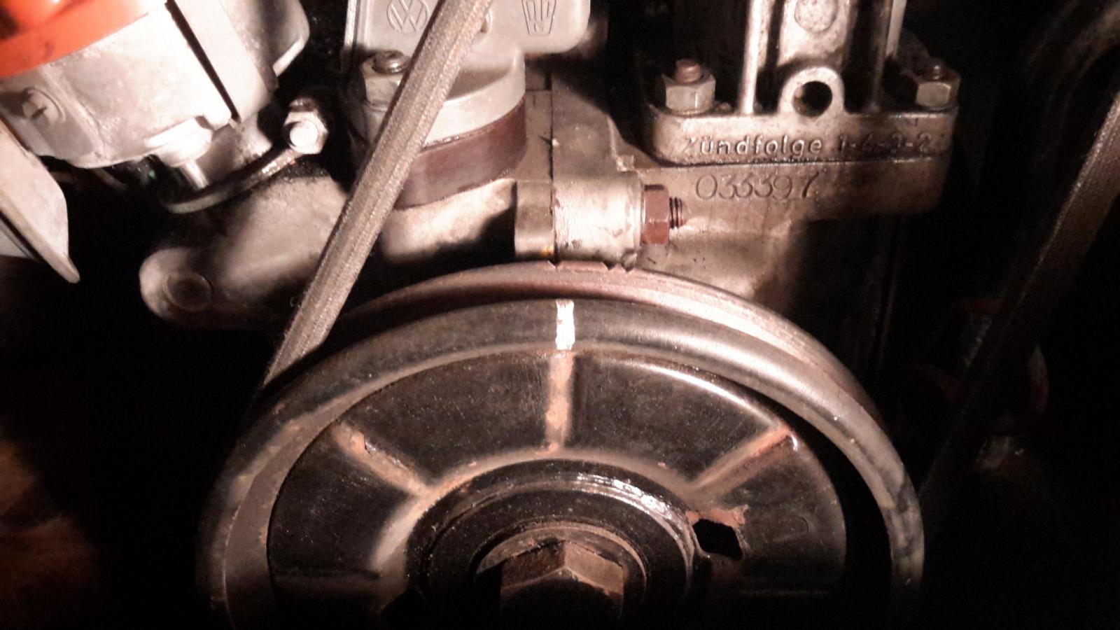

BTW, in setting my timing with test light, do I set it from the the left v groove, which I believe is TDC ?
Peace Very Happy
Tcash
Joined: July 20, 2011
Posts: 12846
Tcash is offline
PostPosted: Tue Nov 03, 2015 1:49 pm    Post subject: Reply with quote
I set it from the the left v groove, which is TDC.
Yes that is affirmative.

PostPosted: Tue Nov 03, 2015 11:11 pm    Post subject: Reply with quote
Setting the timing with a test light.
Clamp the test light wire to the negative side of the coil, and ground the tester. With the valves, breaker points adjusted, and crank pulley set @ TDC (on this setup), and the distributor loosened, ready to fire on #1 cylinder, l rotate the distributor counterclockwise to just where the light comes on. That's where the engine fires (thanks Robbie). I will check it also by rotating the pulley to make sure the light comes on as we reach TDC.
This has been edited as per asiab3 ' s following post. Thanks buddy
Carburetor adjusted by ear. Audio is a little challenged Rolling Eyes
Fuel pressure test next
Very Happy

PostPosted: Tue Nov 03, 2015 11:30 pm    Post subject: Reply with quote
Hi there,
I don't think your static timing is exactly what should be happening. The engine fires the instant the points open, so we want the distributor set to the INSTANT the light changes.
My preferred method is to leave the distributor loose like you have it, pointing to the plug wire for #1. Turn the distributor clockwise until the test light goes out, then SLOWLY turn it counter-clockwise until the light JUST comes on. Clamp the distributor, and check your work by rotating the crank pulley and looking for the light to change RIGHT as the TDC notch passes the case parting line.

Makes sense, Robbie.
Thanks, man !.... Sometimes you have to do something wrong, so you can get it right. Idea

For this engine: 1600 SP engine ... Solex 30 PICT 3 carb., with a 113 905 205 T distributor.
Shouldn't that be when the 7.5* BTDC mark passes the case parting line?

PostPosted: Wed Nov 04, 2015 12:15 am    Post subject: Reply with quote
Tom Powell wrote:
asiab3 wrote:
Hi there,
Robbie
Aloha
tp
For ten thousand miles of my own engine, 0* with a 205T and 30pict3 has been a winning combo. According to Bentley, Muir, and Old Volks:
Distributor: VW 113-905-205T, Bosch 0231 137 035 or 036
Can Use: VW 113-905-205M, Bosch 0231 137 021
Timing Set At:: 0deg TDC Static or @ 800-950rpm w/strobe w/vacuum hose disconnected and plugged
Advance/Retard Range: Vacuum (Advance Only): 17-19deg @ 1.3 In. Hg, 32-35deg @ 3.2 In. Hg
The 205T and 205M statically time to 0*. The 205K and 205L static time to 7.5*btdc.
Do you time your 205T to 7.5*? If you do, you're probably not hurting anything up in the snowy mountains besides your heater output, but a summer drive like that could cook something metal and important…
Robbie

PostPosted: Wed Nov 04, 2015 6:49 am    Post subject: Reply with quote
I use the static timing to initially fire it up if I've pulled the distributor. I then throw a timing light on it and KNOW it's set to 0 at idle.
Dana, the engine sounds good at idle. I like how picky you're being while insuring everything is set correctly!
Keep up the good work.

I've never statically timed my engine and am not familiar with the corret procedure for any engine. I have two 205T distributors, both with new points, condensers and the points gap set on the bench. I have a punch mark on the engine case.
I swap in the spare distributor when needed with it lined up with the punch mark and set the timing at 3000 rpm, check the dwell and let the idle timing fall where it may, which is usually 7.5* at idle.
I assumed that the same 7.5* would be where the engine was statically timed. but ...

Tom,
Just an FYI.. You're setting your "T" distributor like an SVDA w/the vacuum advance hose off and plugged or a mechanical only 009 distributor.
Your "T" distributor is a vacuum advance only distributor and your reading is not very accurate the way you're setting it. Most people with vacuum only distributors set them statically or use a timing light at idle to set them at TDC or 0.
Right now, for a "T" distributor, you're too far advanced and it will run hotter.

Holy cow. I've been doing it that way for the last thirty years. If I recall I set it at TDC on my first tune up after purchase in the '80's and experienced a lack of power and backfiring on deceleration.
I live in Hawaii and use the camper when I'm on the mainland. All my manuals and notes are also on the mainland. The only info I have here and now is what is stored somewhere in my old and abused brain.
Busdaddy has published his timing procedures many times and I'll start doing a search for that. But if I remember it was 28-30* max advance at 3000 rpm with the vacuum hose connected.
I have experienced some overheating in Death Valley and on long hill climbs before installing a deep sump, but no apparent engine damage.
I started a post regarding ignition timing in 2008
http://www.thesamba.com/vw/forum/viewtopic.php?t=347675&highlight=
from this source
http://www.vw-resource.com/34pict3.html#timing
"This method will also work for the 30PICT/3 ... 1300/1500/1600 engines with single vacuum distributor - 7.5BTDC. This is set static - engine off (or at idle with a timing light and the vacuum line disconnected)."
I'll do a search for BD's many postings on timing and update my reply when I find it, but in the meantime it seems to me that the goal is the correct max advance at cruise rpm and static and idle timing are only a means to get into the ballpark.
Aloha
tp
