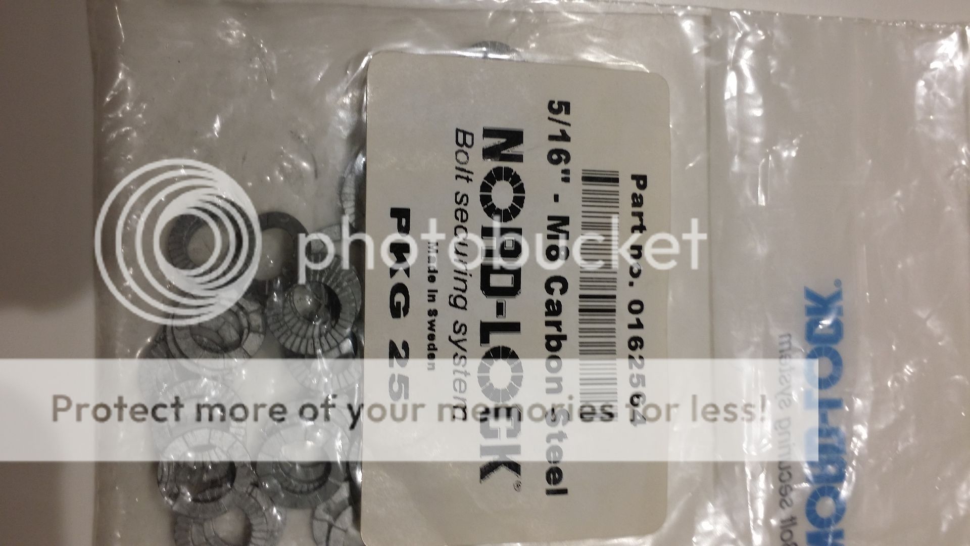

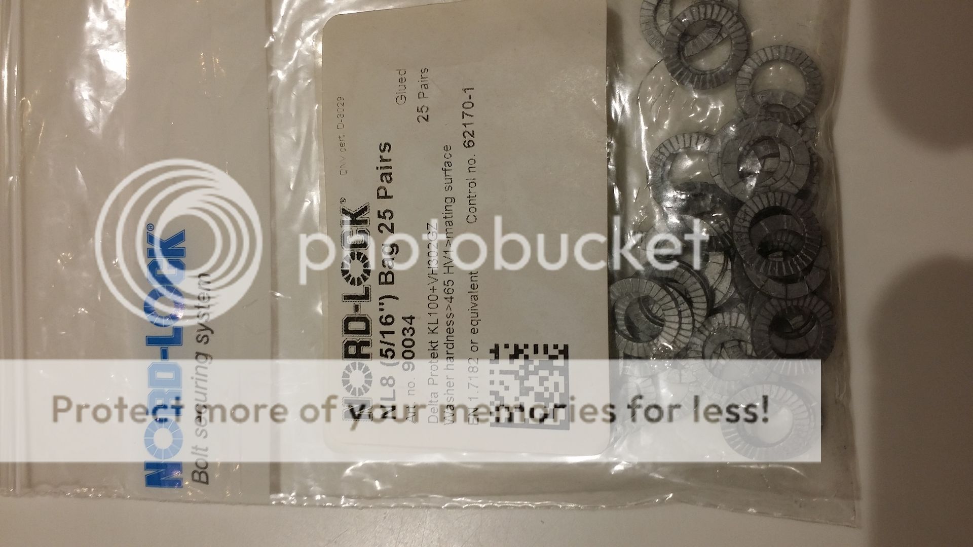

Here is my promised update:
The NX series were not available at Fastenal online or brick/mortar. As a result, I went with the NL series. They are being discontinued so get them now if you want them. Alternatively, you can wait and see if they eventually stock the NX.
I have attached some pics in case they can help anyone looking to purchase them. They were only $11.00 for the package of 25 pairs.
All the redemption I can offer, girl, is beneath this dirty hood

Busstom
Joined: November 23, 2014
Posts: 4591
Location: San Jose, CA
Busstom is offline
PostPosted: Mon Nov 30, 2015 10:58 pm    Post subject: Re: PSA - Nord-Lock your drive shaft (CV) bolts Reply with quote
BUSBOSS wrote:
...As a result, I went with the NL series. They are being discontinued so get them now if you want them.
Nice score! You won't regret it.
I couldn't find such an NX series, only the NL and NLX.
But I think there must've been a miscommunication. I really doubt Nord-Lock is discontinuing them. If something is being discontinued, it's being replaced by something better. Perhaps Fastenal isn't going to offer the NL.
Do you have an account with McMaster-Carr? They are one of the best suppliers in the business, easy to do business with, and they ALWAYS answer the phone and ALWAYS get you your answer(s), straight. I highly recommend creating an account, even if not for Nord-Locks.
So anyway, even though this product entry http://www.mcmaster.com/#91074a130/=101ld9n is somewhat vague, if you call them and ask for details, they will give them to you. And they’ll often inform you or link you to additional related products that don’t appear to be listed. I guess what I’m saying is if the OD of the washers I linked above isn’t what fits the CV joints, they just may have the ones you’re looking for also. I think, like Fastenal, they’re breaking down the bulk packaging for us little guys. Unfortch, McMaster is only offering 20-pair per package, which hoses us for completing a full pair of axles with one bag…..grrrrrrhhhhh.
I like the NLX that Cash linked, but I will probably go with whatever McMaster is offering when I get some for my Bay.
Use that extra pair to do a test torquing, and then back it off. Use a long ratchet or something with a long arm…I bet you’ll feel the wedge-lock action kick in…it’s pretty impressive. Please update with your experience!
