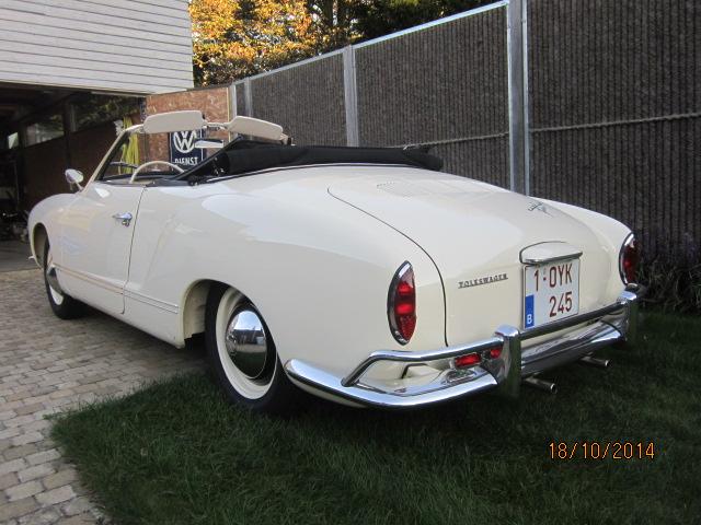

Hi, can someone tell me if the 6 holes are correct for a 64 small Volkswagen logo.
It looked Original but all the Volkswagen badges that I found had 4 tabs but none of the tabs are mathing with the holes......
Can someone tell me what I need.
The enine lid was mathing to the car and was Original paint.....
Thanks for your help! Wink

I also have a '64 Cabriolet. It has its factory-original engine lid and the correct VOLKSWAGEN emblem. I just measured the length of the emblem along the continuous line along the bottom- it's 215mm long.
The one you have is most likely from a mid '60's Bus, such as seen here. I know from experience that the bus emblem is at least a few centimeters longer-
http://www.thesamba.com/vw/archives/lit/1968_bus_comes_in_a_box/3.jpg
I also checked the underside of my Ghia's engine lid. The emblem is attached using only 4 holes.
So the engine lid you have is most likely from a '66 and later Ghia which had the "slanted" VOLKSWAGEN emblem. Like this one, from theSamba gallery of an original '66 Ghia-
If your emblem is also 215mm long, then you have the right one, but the later engine lid.
Here's a VW press photo of a '65 Ghia which would have the same emblem as on my car/what your should have.
http://www.thesamba.com/vw/archives/pressphotos/65ghia_2a.jpg
Another shot from theSamba gallery showing the correct emblem; this one is also a '65-

Just want to know if the 6 holes are correct.
The 2 left ones are correct.
It will be painted within 2 weeks and want to know if a VOLKSWAGEN logo exist with 6 tabs.
Thanks for your help. Wink

The correct emblem has 4 posts.

The engine lid on my '63 is an older one I suppose (no holes for the Volkswagen emblem). I bought an emblem on a swapmeet but it's 29 cm long (4 pins)... That emblem should be for a bus then?
I was searching on the www where to drill the holes, couldn't find it though... Someone knows?

PostPosted: Tue Dec 01, 2015 2:04 pm    Post subject: Re: Volkswagen logo on engine lid of a 64 Ghia vert Reply with quote
Thanks for the info! Wink
Car is finished now!

passoa, great that you have the Ghia finished! Engine lid looks very nice with the "petite" VW badge. Have you been able to drive it since completion?
Even though the title of your thread is "64 Ghia", you actually have a 1965 model year based on the heater levers next to the handbrake. So most likely the car was first registered in 1964, but built as of Aug. 1 1964 to be a '65 model year.

Thanks, yes the Ghia comes out from time to time with good weather.
This is my dad's car.
Yes it is a late 64.
Base was pretty solid.
It was a bolt to nut restoration.
I've done 2 others already, also a 64 Manilla yellow vert and a 67 Savannahbeige vert.
