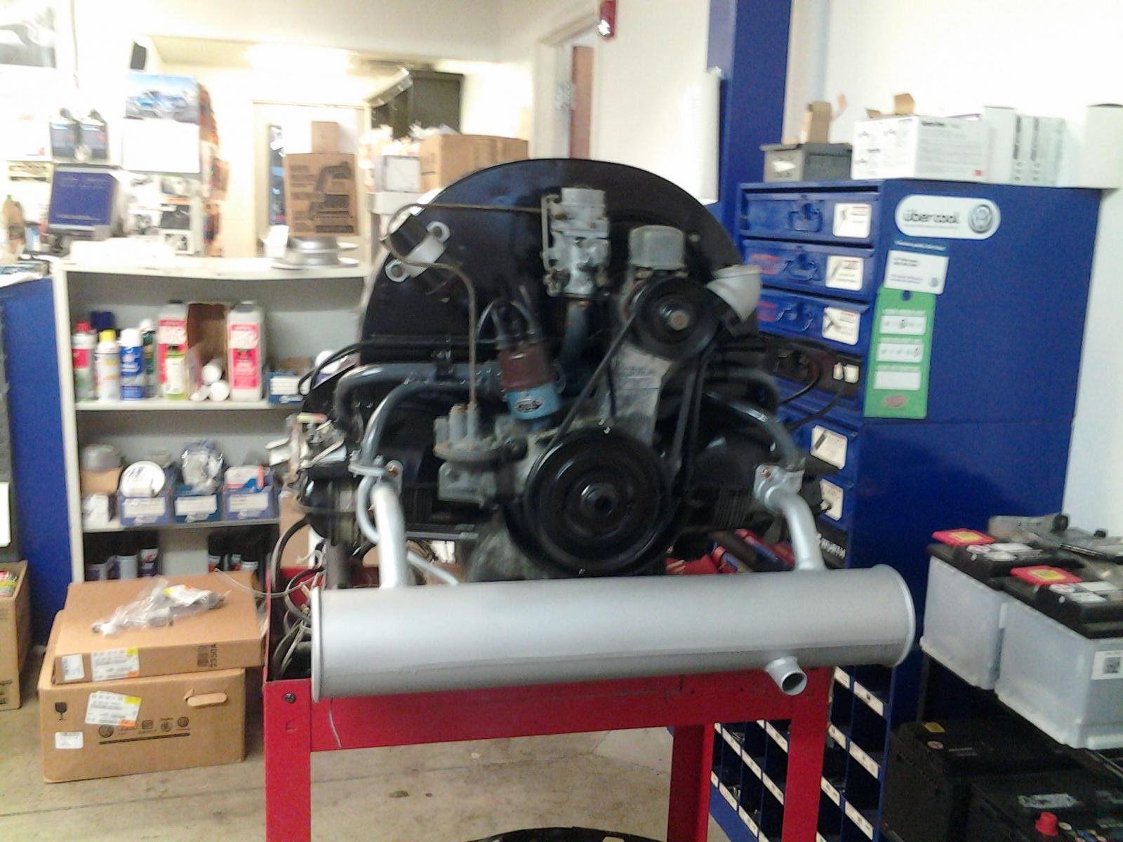

My motor I've been rebuilding at work on my lunch breaks is just about done! It's a 59 block with a few earlier items tossed on and an 019 distributor. I hope it runs!
Excuse the blurriness - cell phone pic on a crappy old phone.

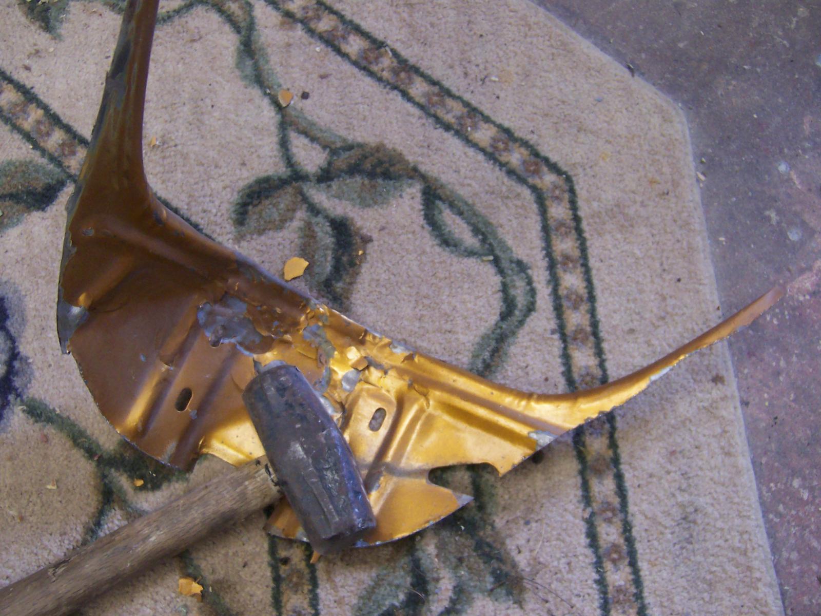

I took a break from soul crushing sanding to start fixing my bargain rear fenders. The left was the worst so I am starting there.
There were issues allover the fender but the rear section was the worst. Mangled, hacked and with chunks snot welded on.
The back was nice too. I had added a couple quick spots to keep the cracks from getting worse.
The original idea was just to cut out that section and splice it in from this original junkyard bargain (free) fender I had. Upon sanding over 1/4 inch of bondo I found it was just as mangled. So that was that.
Then I remembered the pair of rear fenders that came with this car, they were repro and I had no worries over hacking them up.
There's the left one, doesn't look too bad!
You can tell it was from this car... friggin GOLD.
Excuse the blurriness! I was amazed at the unbelievably shoddy design and construction of these fenders, thin as a beer can, badly formed, shaped all wrong, even! I couldn't use this!
So here is the old fender, I sectioned a new piece in where the overrider hole was and met it with the bumper bracket hole area. This is after LOTS of cutting welding, grinding hammering out caved in areas and more.
Numerous sections here were gone so I spliced some I had gotten from a nice fellow on this site. So that's it for fenders today as it started to pour out and I had to put the car back inside.
