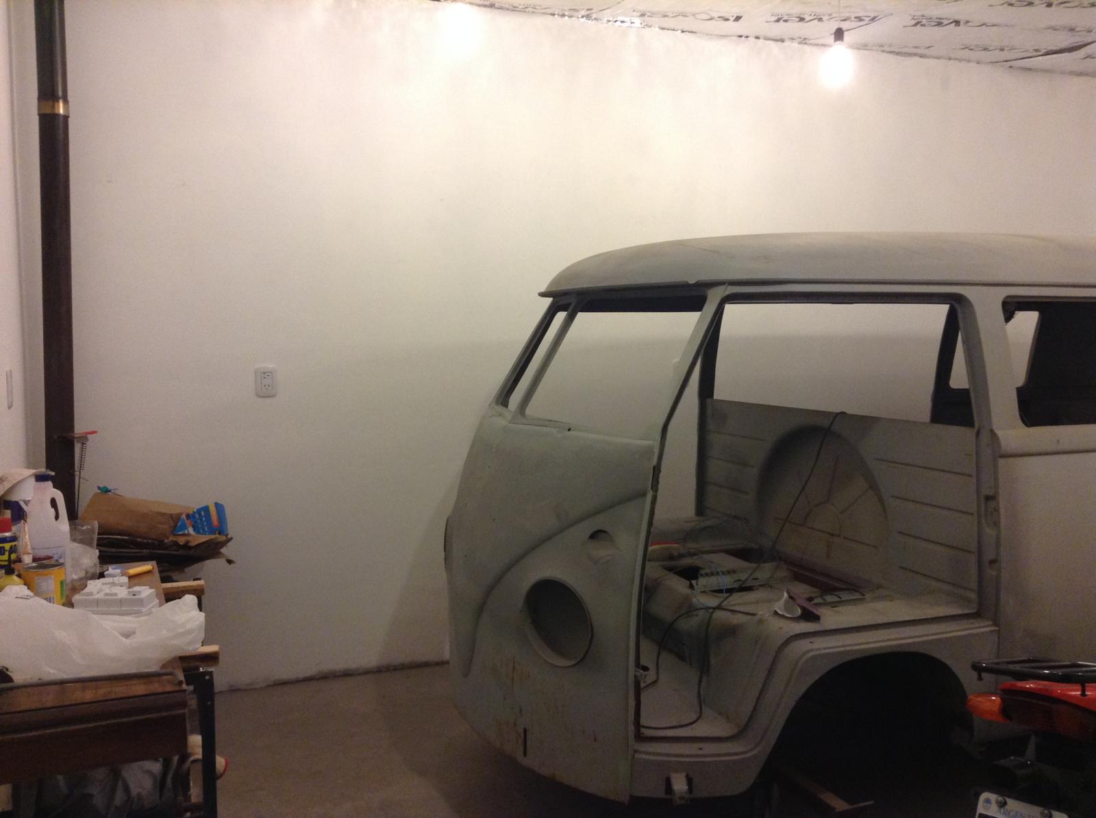

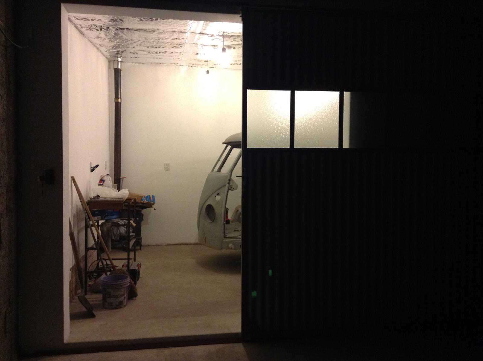

PostPosted: Mon Jul 20, 2015 9:18 pm    Post subject: Reply with quote
Finally!!! The project resumes!!!
Hello everybody, has been a while!
I got the bus inside my little workshop!!! I'm really excited, and also worried for all the things to solve next and well, you know, all this mix of uncertainty, bewilderment and happiness!!!
I'm working on purchase some tools I need because my workshop is empty now. Fortunately i'm carrying here the mig welder I was using before Cool . Someone lent me an air compressor Wink , today I bought the hardware to make the air lines, my son (now 3 1/2 years old) helped me carrying the pipes in the bicycle, strong enough we arrive in one piece Laughing .
I need to build a workbench, move compressor outside and some other stuff to make more room, and few other things. But so far so good!
So here is she, one more chance to finally finish!!! Very Happy Very Happy
I expect to be more involved in the forum again!! see you soon with more updates!!!
