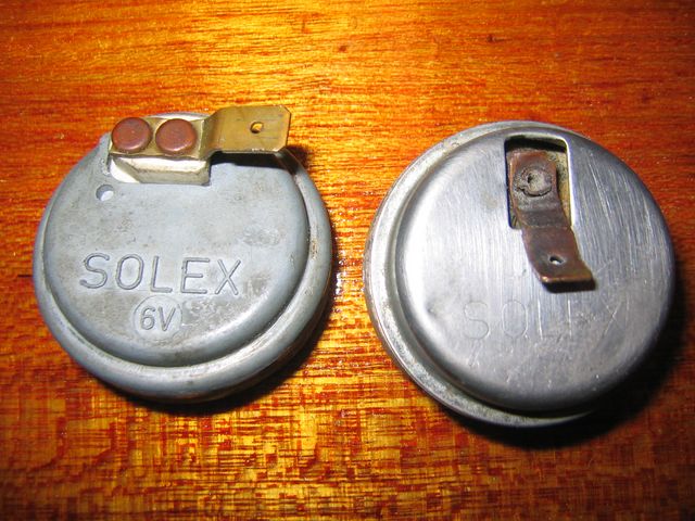

I faced such a problem once, and it was the choke that was not disabling by itself. Actually it was not an automatic choke, and it was staying on overfeeding the engine with gas. After a while the engine has exactly the same trouble. As you act on the choke, check if this is not the cause.
Will double-check the choke, or maybe just disable it completely for diagnostic purposes. I'm pretty sure it's working properly -- I sat and watched it open with the ignition ON -- and has happened with two different carbs and chokes. Still, wouldn't hurt to triple-check it.

Rotate your choke back to the position where is was running without dying. If you disable it, The Bi-metal coil will not heat up, causing the choke to stay closed. The electric choke needs 12v to heat up the B-metal coil and allow the choke to open completely.

I checked the choke a couple of different ways. For starters, I pulled the air cleaner off, pulled the arm off the stepped cam, and made sure the choke sprang to the closed position (cold engine, unheated garage). Then I turned the ignition on and watched the valve slowly open. I think I've read it takes a minute or so, but mine takes more like three to reach the completely open position. Cam moves along with it until it's at the lowest, warm idle position, and the choke valve is completely vertical.
To double-check, once it was cool again I undid the three screws completely and pulled the choke off the carb. Leaving it plugged in to the -1 terminal of the coil, and lying on top of the generator for grounding, I turned the key ON and sat there watching the thing unwind. Also, I made marks on the choke housing corresponding where the full open and full closed positions of the thermostat hook, for reference.
Can't remember if it winds or unwinds as it heats, but the main thing to note, in my way of thinking, is the position of the hook that contacts the valve pin.
Good Luck.
Tried that, didn't work. What I meant by "disabling" the choke was to leave it plugged in, just rotate it far enough so that, wound or unwound, the valve is always open.

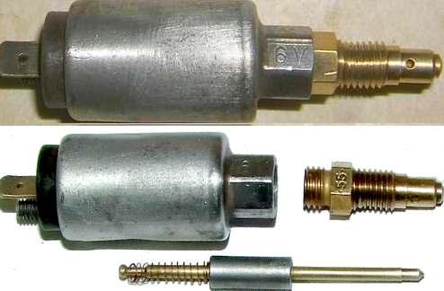

I had a similar problem and found that the auto electro cutoff valve was bad, that's the little cylinder coming off the right side of the carb wired to the coil along with the choke heating element. I replaced it with a jet valve from an extra carb I have. Runs great again without run on which was surprising.
