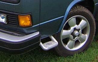

I assume you're probably talking about a sidestep for the slider.
But assuming you're talking about the two front doors, I've got this for you:
Not my rig... one I was considering buying till recently... but it had those and I was actually a big fan of them having been installed.
As far as I can tell they are Bully steps, and run between 45-100$ depending on what and where you buy it from... Installation seems pretty straight forward.

Oh Gee Dwarf!
You're killing me here!
Why must you show me this stuff??
Again, for my wife's comfort....... Two (2) Bully steps to be ordered!

[quote="DwarfVader"]I assume you're probably talking about a sidestep for the slider.
Wow DV, only the second set of Bully side steps I've seen on a Vanagon. Other than the set I made around 2005.
Side door steps have been available since, (bay windows?)
Front door assist steps have not been available commercially AFAIK...
Took a day or so to make the drivers side. The passenger side took half a day..javascript:emoticon('Very Happy') Very Happy
The Bully universal step set cost me $100 CAN$. The custom brackets were another $100 for welding and mock-up. Meaning few would pay the price for a set..javascript:emoticon('Sad')
Vanshrugs
