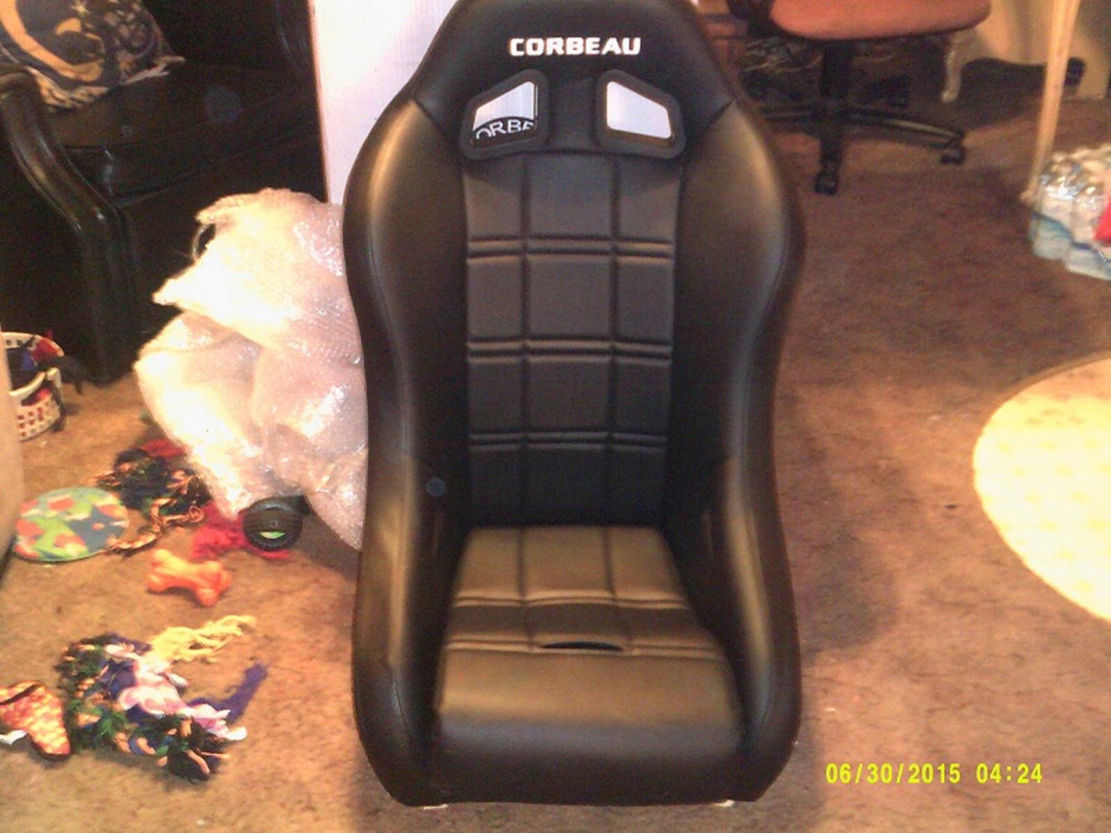

Working on it was kind of depressing so I made myself feel better by ordering a set of corbeau baja xp seats. Trying to get to trans so I can take a ssc and a dsc irs t1 trans to my builder and figure out what to have rebuilt or bought. Leaning towards something with a 4.57 r@p to get in rpm range I want with 31" rear tires.

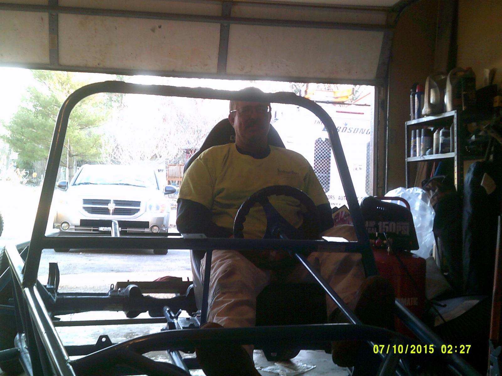

Seats arrived today. My head touches top of seat proper, the harness slots are about 1" below top of shoulders, and the removable seat bottoms mean no more sitting in puddles.

Nice seats! How do they compare to a standard suspension seat?

The xp like I bought are 5.5" taller than the ss , it has a removable seat cushion, seems like the harness slots are higher up than the ss or jp and separated, and weigh about 8 lbs more each. Seems like they also flare out under the headrest a little. That flare falls right at my arm pits,hoping they don,t restrict my arm movement to much. I have a 38" waist and I don't think any larger will fit. The xp seat back is 75 degrees vs the ss at 70 degrees. My kids give them a thumbs up.

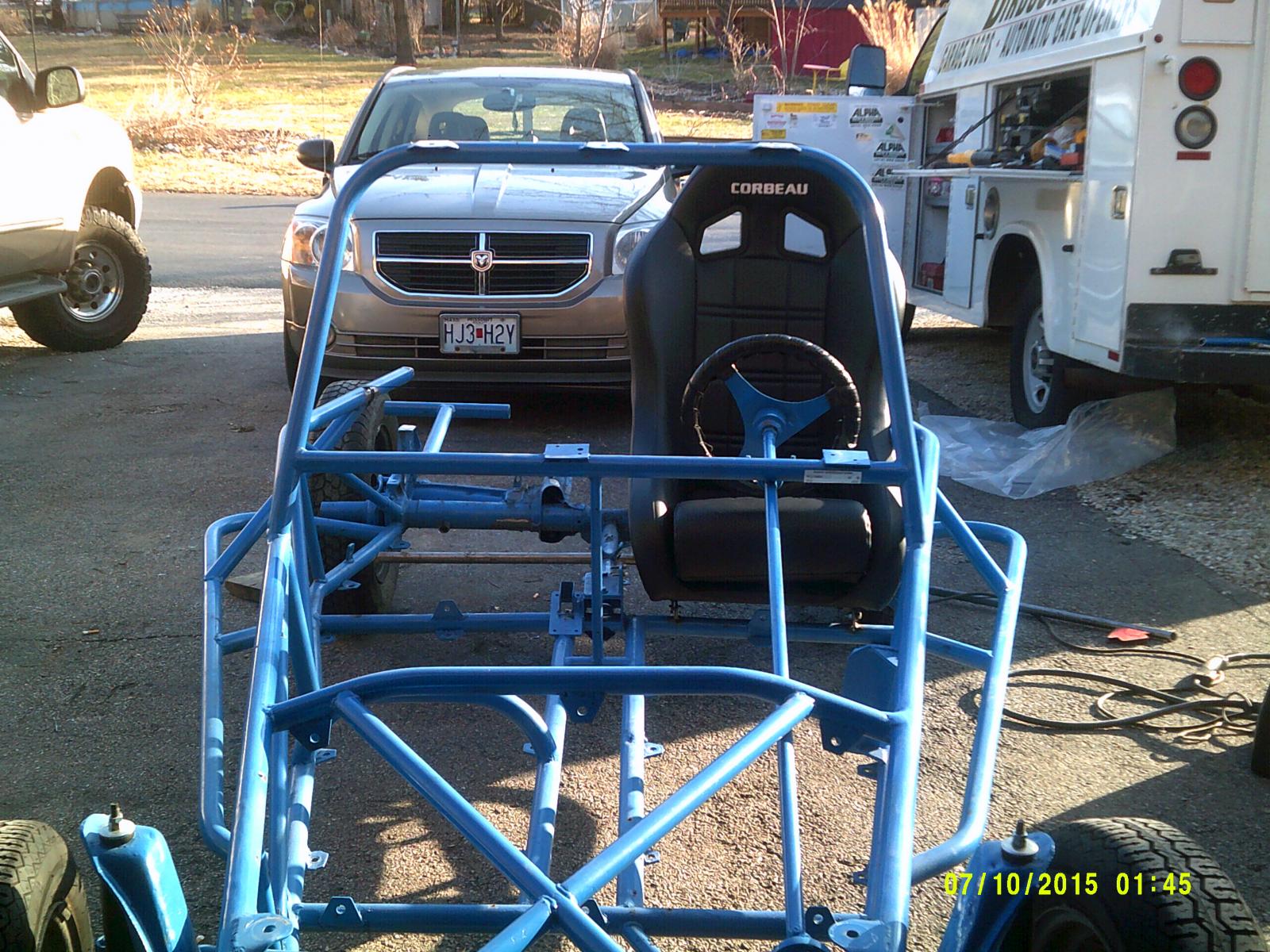

So I did a first attempt at mounting seats. I had the poly seats mounted like sandjunky's. Removed the mounts to get started. These seats seem much larger. Can't move them back due to the frame kicking back in. Won't drop in between torsion and the floor cross bar. Mounting pattern is 14' wide x 18" long. I tacked the front mounts on top of the cross bar and stuck in a piece of 1" x 125 running across the frame for the rear mounts with it being flush with the the bottom of the the frame. It would be quite a bit more work to relocate the cross bar since it is tied into the nerf bars and the double bottom bars that convert to a single bar running to the torsion. After sitting in the seats for a while[insert vroom sounds here] I think I can live with the way they are. With my ass no longer 6" below the pedals, the sitting position seems more natural and comfortable. Guess I won't be the first person to raise the top of the windshield hoop.The dash bar probably needs to go up about 4".
I will be helping? my buddy do the tubing work in his shop. It's heated and cooled. I was hoping I would not have to drag my frame up to his shop for every little thing, fuel tank and cooler mounts, ect.

Just a suggestion. Seats are a real sore spot for me because if I were to put a comfortable seat in I would be staring at the windshield hoop and my legs would be in the steering wheel. This looks like it may be similar to your situation.
As long as your cutting out frame I would redo the windshield hoop and put your steering shaft either through it or above it. You'll be a lot happier later on. I wish I had when I was doing all my cage work.

Going to raise the hoop maybe 3", and the dash bar at least 4". Got to make it fit me. Even with the poly seats the dash bar was too low for me. Short, fat legs and a lot of torso.
