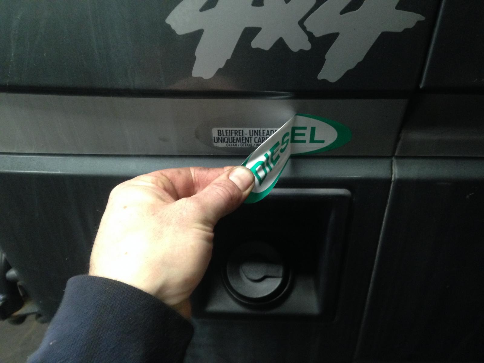

PostPosted: Tue Feb 23, 2016 2:29 pm    Post subject: Re: AAZ Turbodiesel swap into '86 Vanagon Syncro Reply with quote
The peeling away of the Diesel sticker was the best part so far!
I'm so pleased to have this happening. This van will be touring the country, soon as I can stop running to the hospital every 2 weeks as they make sure my brain won't fall out. Wink
Thank you, my friend, can't wait to see what you do to this old girl.
