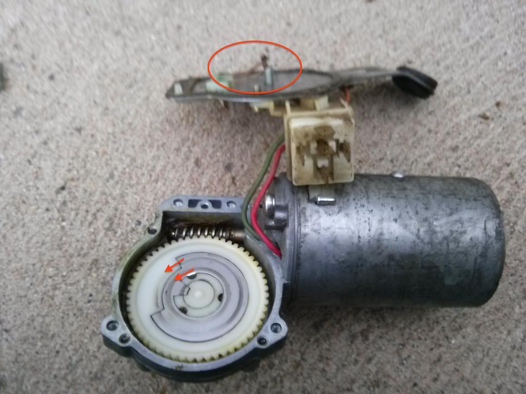

The large plastic gear in there also runs the park contacts, if it failed in any position other than park the motor is costantly trying to get it back to park.
Tight unlubed pivots and linkage put alot of strain on that poor old plastic gear, sometimes just the middle twists out, other times the worm gear chews the teeth off of it, I suspect the latter in your case.

See the small arrows on the white gear in this photo? Those are the 12v tracks for electricity to run your motor. When the switch is in either "on" position, the inner arrow path is picked up by the bruises that are circled and out of focus, (sorry.) When the switch is off, the outer brush path is always activated. It is only when the outer "switch off" powered brush reaches the "blank" spot where the metal becomes plastic that the circuit is broken and the wipers park themselves.
This is my hypothesis:
Your wipers stopped in the up position because the white gear or something else in the mechanism stripped. Now, remember how in any switch position one of the two brushes is getting 12v? The white gear is stuck in a position where both bruises are conducting on the metal ring, but it is stripped so no matter what the motor does the white gear (and wiper arms) won't move.
Please now: take your wiper arms off in case the motor and gears decide to catch, you don't want the arms running down and scripting the heck out of your nose.
Luckily for you, you get to disassemble, troubleshoot, and lubricate your wiper assembly now. It's actually one of the more fun jobs on the bus. Lack of lubrication is probably also what cause the part to fail in the first place. Please let us know how it goes.

This is the part that is Fubared.
http://www.thesamba.com/vw/classifieds/detail.php?id=1344036
Here is how you get to it.
Wiper Motor Tutorial on removing, diss-assembling, cleaning
Good Luck

So things are apart and yes the plastic is done.
I ordered a new one from Bus depot. Will install and fix some leaks around the wiper holes with $1.50 grommets from Bus depot. Maybe even around the windshield too.
