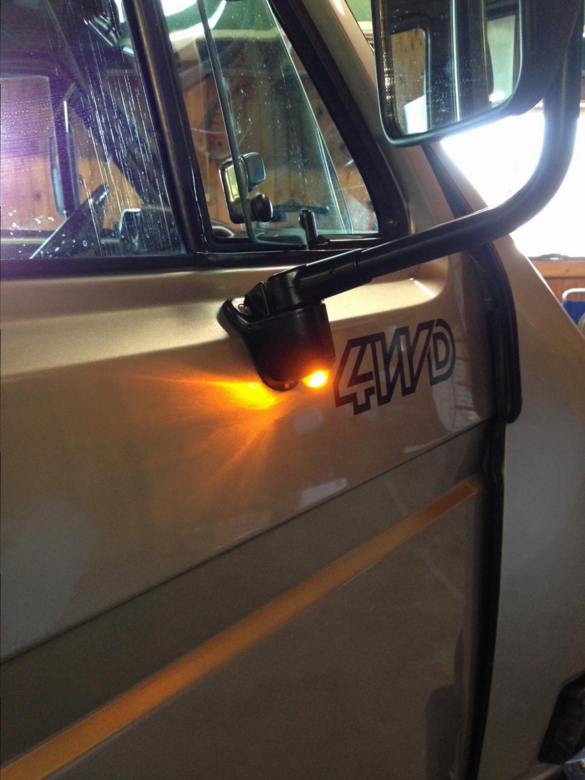

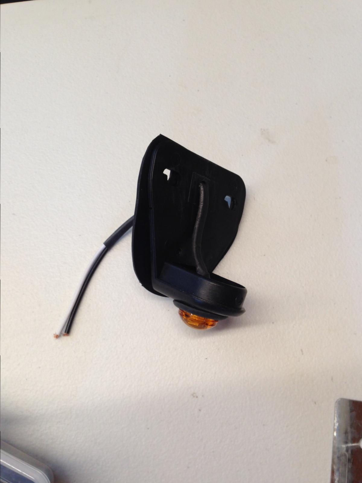

eplater is offline
PostPosted: Mon Jan 25, 2016 6:08 am    Post subject: Re: Mirror mounted turn signal LEDs? Reply with quote
Started this over the weekend - both sides installed. My van was a power window model, LT mirrors have since been installed - so I used the square hole in the door between the two mounting screws to feed the LED power leads thru. Using the front turn signals for power. They'll be on with the parking lights and flash with respective turn signal & parking lights on. Did this mod on the rear markers last year with same type (but red) of LED unit.
Just need to get the leads to the front turn signals - not so easy on the left side!

PostPosted: Mon Jan 25, 2016 10:53 pm    Post subject: Re: Mirror mounted turn signal LEDs? Reply with quote
Nice work on this. Got a part number for those LEDs?

PostPosted: Tue Jan 26, 2016 5:49 am    Post subject: Re: Mirror mounted turn signal LEDs? Reply with quote
I got them on ebay.
3/4" amber LED clearance light. 12v ready w/ 3 CREE LED units per light, water tight epoxy seal and rubber grommet; like $3 each
