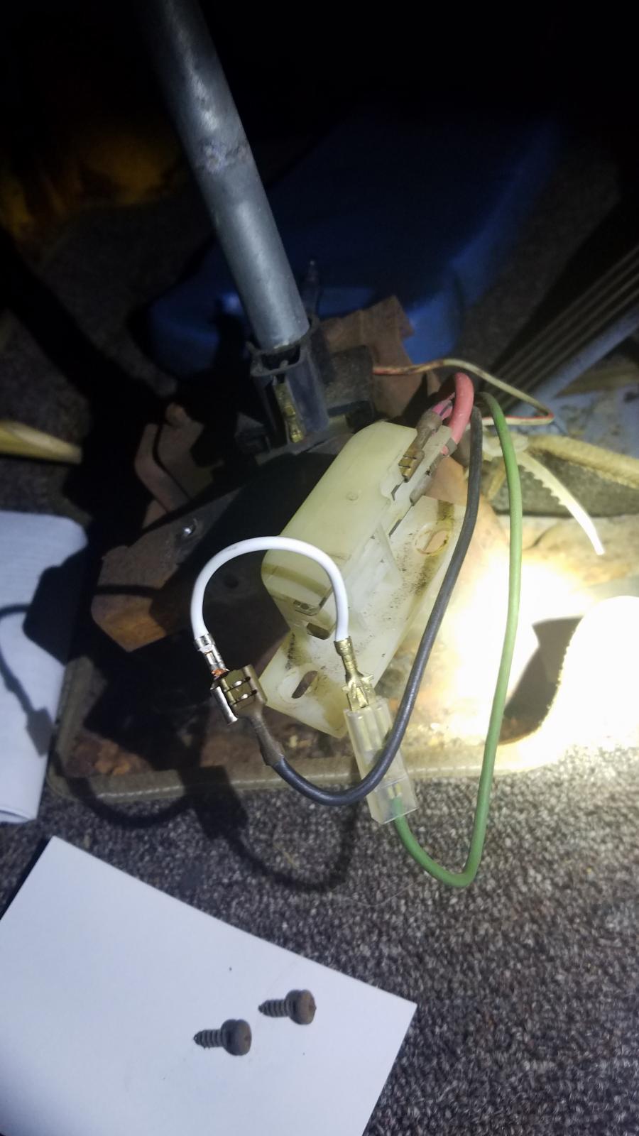

OK I've done some more digging and I think I've figured out my problem. The metal piece that goes between the two points is pretty messed up(pic attached). Does my logic sound good to you guys and where can I get a replacement piece? I took the wires out of the plastic bit and connected them together and they came on like they're supposed to, which to my mind points back to the metal bit.

#12 311 927 147 B park neutral position switch.

it is a safety item and it also keeps you from damaging the flex plate accidently. I would replace it.

PostPosted: Tue Jun 07, 2016 5:04 am    Post subject: Re: Automatic Transmission Reverse Light Question Reply with quote
Ok the switch contact I believe is the problem not the actual switch itself (note second picture). I've got a friend looking into a 411/412 automatic colomn to see if it has the same parts. Part #211919265 is what i'm looking for I think.

yes I understand that is the part #. my question is do you think that is my problem? I don't really want to order the part and it not fix the problem.
May not be the problem, but that thing is worn out.
To test the switch.
Hook the wires back up to the switch and run a screwdriver across the two contacts and see if the lights come on. Lights come on the switch is good.
To test the contact.
Use an ohm meter and measure the resistance between #14 211 919 265 park neutral contact, the one that is all worn out and the shifter. There should be no continuity (contact) between the brass rubbing block and the shifter.
