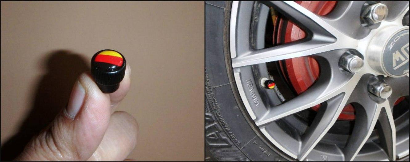

Received a set of good quality alloy Valve cap. Inside it has a O-ring for tight air lock fit. German flag adds character to the Disc.
Product quality is beyond my expectation(yes, China make) Smile .
Now, I’m scared someone may steal it.

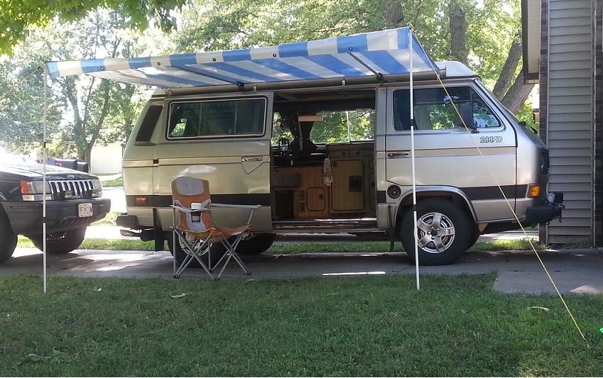

Replaced my boring solid blue awning for one with stripes. Very Happy
1981 AC Westy

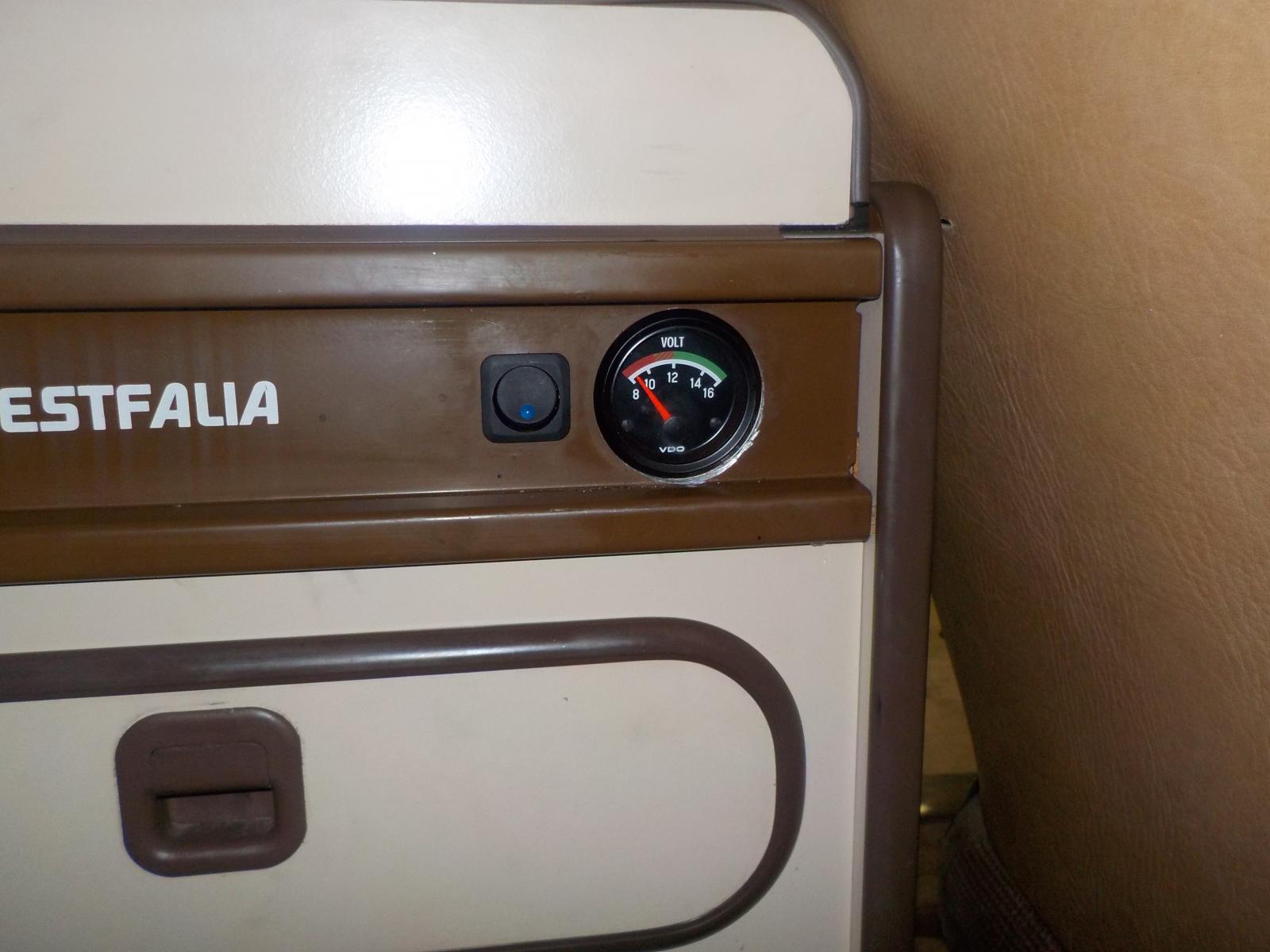

First, I installed three auxiliary 12 volt deep cycle batteries under my front seat using the Go Westy kit. I wired in my Truck Fridge, stereo and all lights on this circuit, so it never runs down my main battery. I also installed a VDO voltmeter gauge in the stove to keep an eye on the aux battery voltage. We took it camping for a few days and it performed flawlessly.

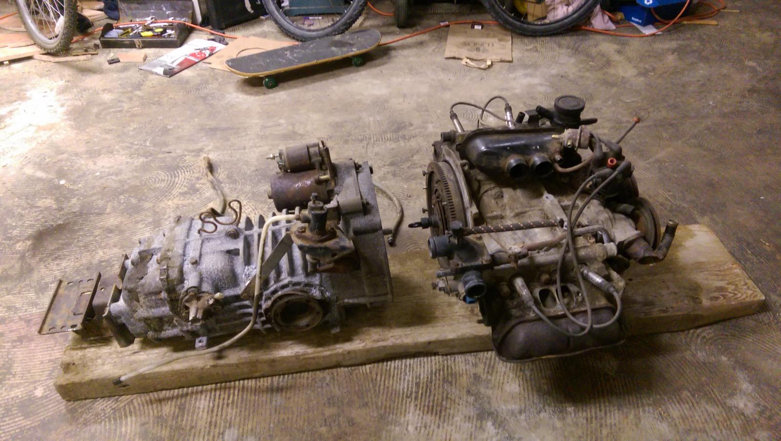

Got these things out to assess. Not too sure where to start, want to know more about them. Out of a '90 according to the transmission date stamp (Jan 10, '90).
Looking for the lowest cost method of getting the engine to run without taking my running engine apart. Just bought this stuff when it looked like my trans was failing, and that turned out to be just a disintegrated clutch disk.
First step, I guess: see if the starter functions with 12V (probably use my jump pack). Next, compression test using starter if working. Next: Not sure... maybe someone has a few suggestions.

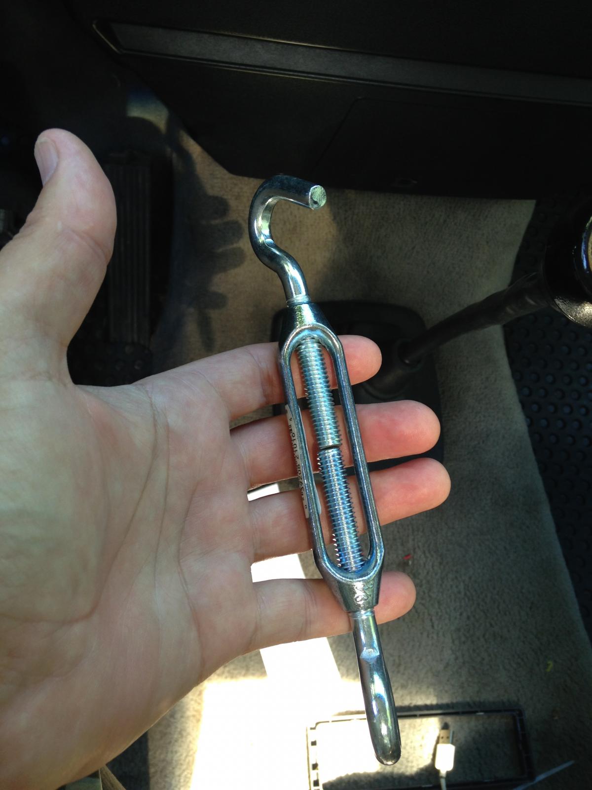

I have seen this — a hatch latch extender you can lock — mentioned a few times and yesterday I wanted one. So while running a few errands, I picked this up:
$5. Probably less $ or a better selection of parts in a different sort of hardware store but I wasn't going to shop around. This came as a unit, indivisible.
I tested it in the parking lot so I could be sure a. it fit and b. I understood how it works, and with an affirmative on both counts, I bought it.

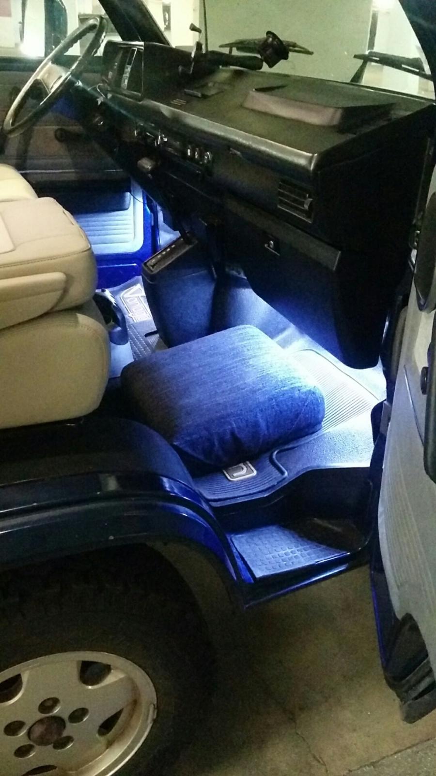

I always look at this thread for things to do to my van. I have done a few things over the past couple of weeks so thought I would share.

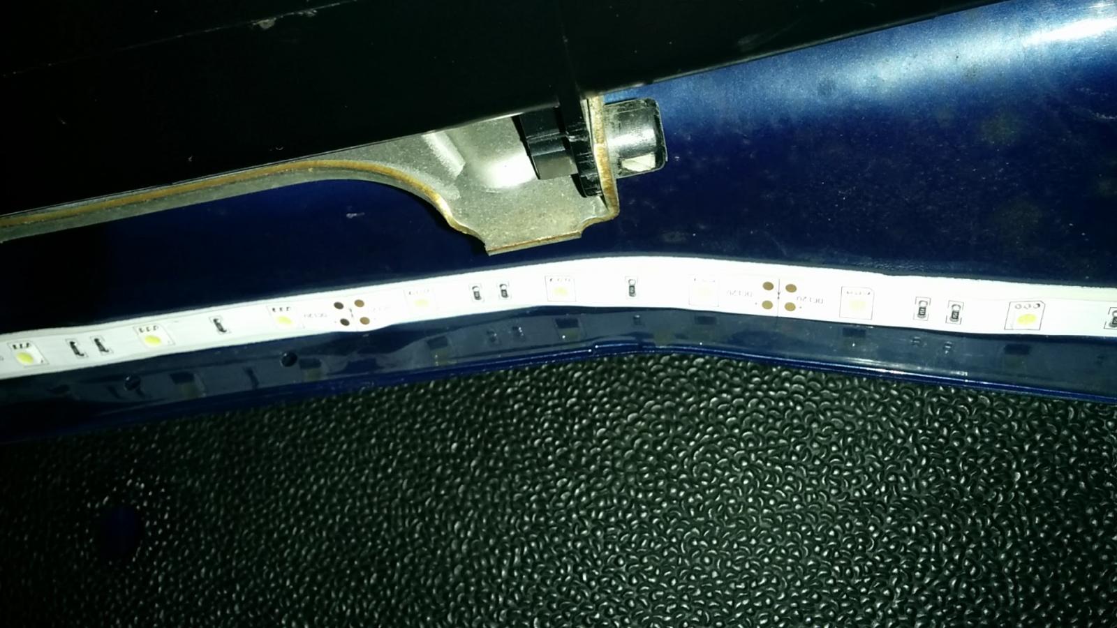

1. courtesy lights for the front floor boards.
I used this LED strip purchased from Amazon and these connectors:
https://www.amazon.com/gp/product/B00JQV6Q9I/ref=oh_aui_search_detailpage?ie=UTF8&psc=1
https://www.amazon.com/gp/product/B00A75USBE/ref=oh_aui_search_detailpage?ie=UTF8&psc=1
I tapped into the passenger door dome light switch (it had an extra slot). I then ran two led strips under the foot wells. The led strips have adhesive backing, but I also used 3m double sided tape because I thought this would help. I also added a rocker switch so that I could turn the footwell lights off when at camp and we have the side door open.
finished product:
LED's under dash:
Rocker switch:
Tied into map light power:
Tied into dome light ground:

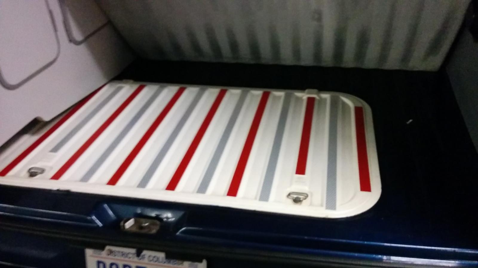

3. added red/white reflective strips to the engine cover
I got this idea from texasvanagons.com. This seemed like a great idea! Now if I ever brake down on the side of the road I can use the engine cover as a reflective triangle for safety. This also frees up some space in my van.
http://texasvanagons.com/deck-lid-safety-reflective-tape/

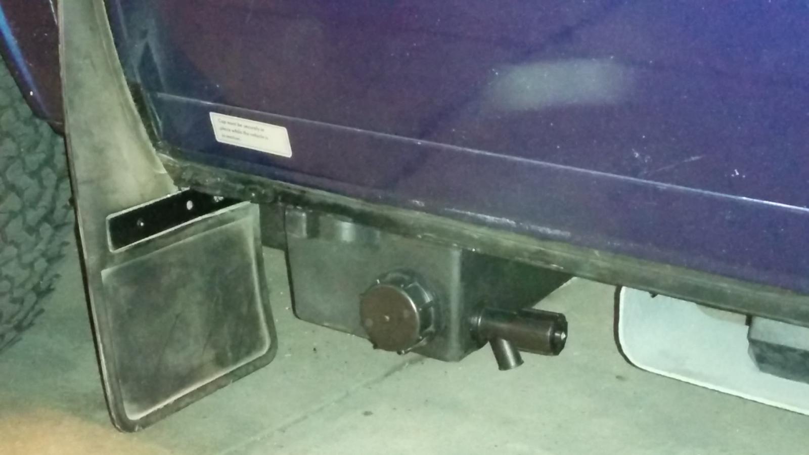

6. installed Busdepot (purchased) waste water tank
This was a straight forward install (fit, measure twice drill once)

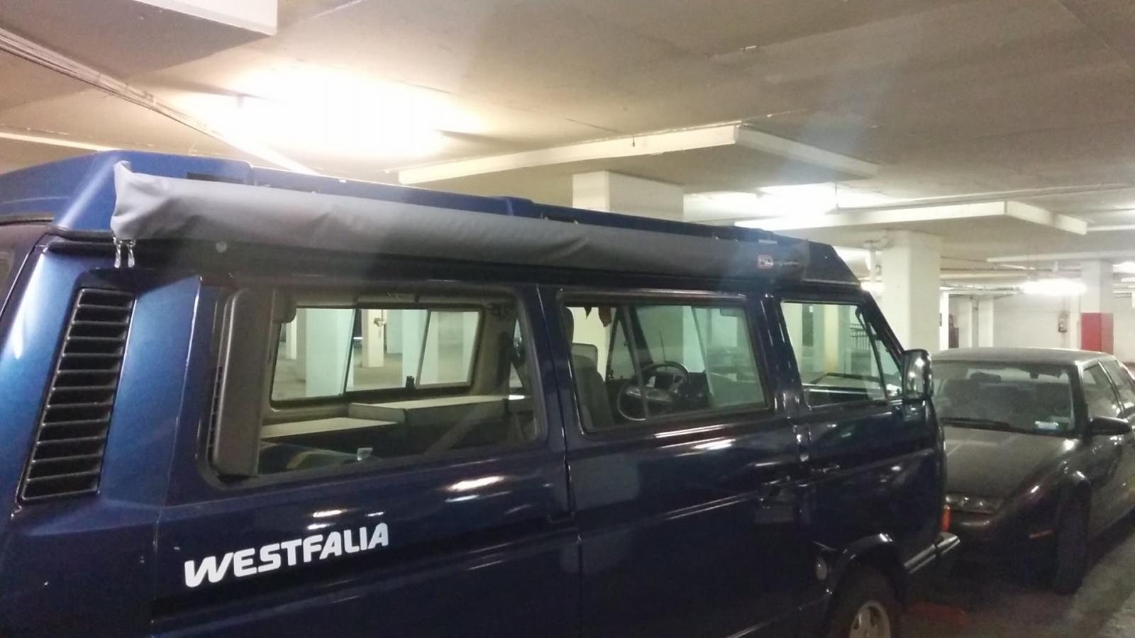

7. installed ARB awning using Gowesty brackets (did not drill in van (yet))

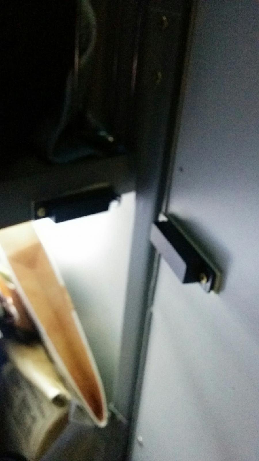

9. installed LED lights in cabinets using same led strip as I did for the front floor.
I used magnetic switches so the lights will turn on when the doors are opened

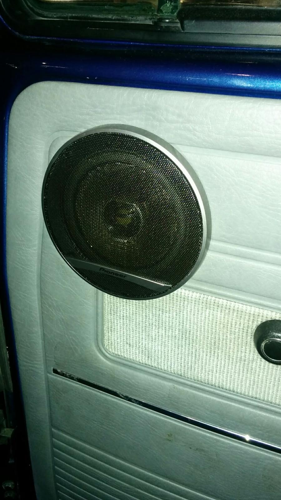

11. installed larger 5.25 inch speakers in the front doors

1 - I've installed the ARB 2500 with GW brackets and haven't felt a need to drill into the van.

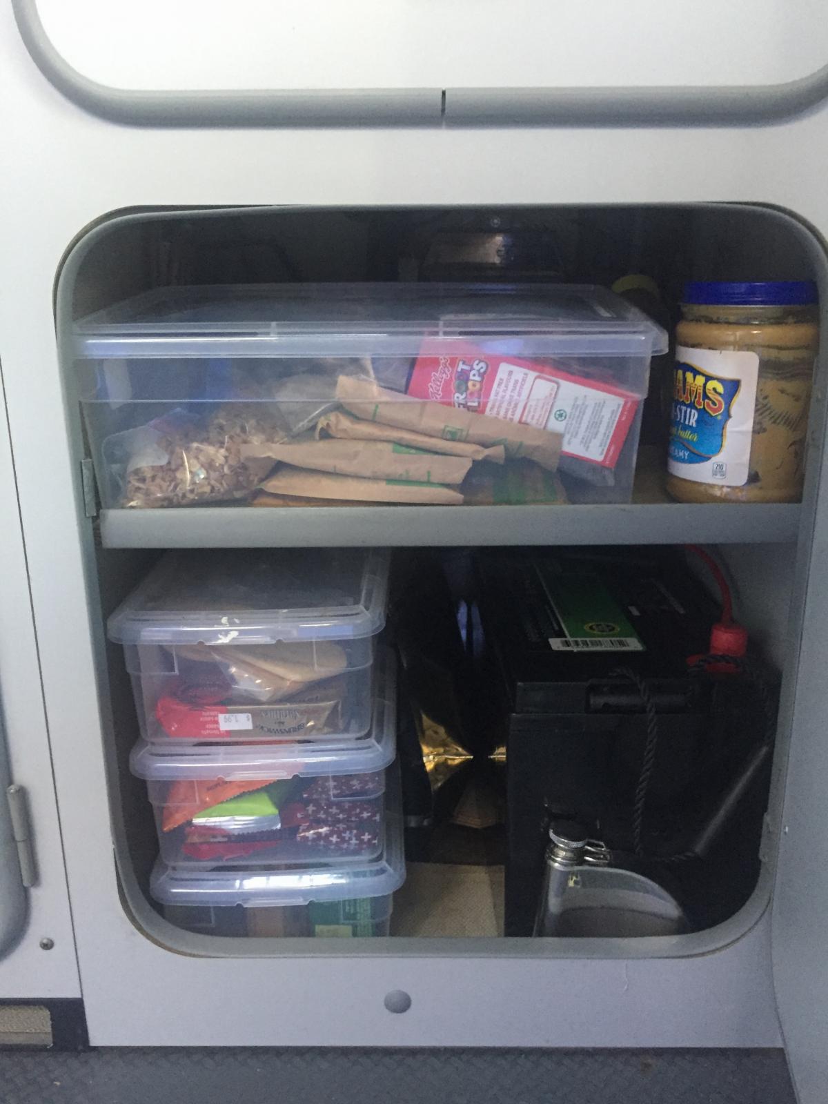

2 - I've found inexpensive plastic boxes from the Container Store can help with organizing stuff. FWIW, YMMV...

Jimf909,
I like the plastic bins for organizing, I will add it to my forever list of things to do with the van!
