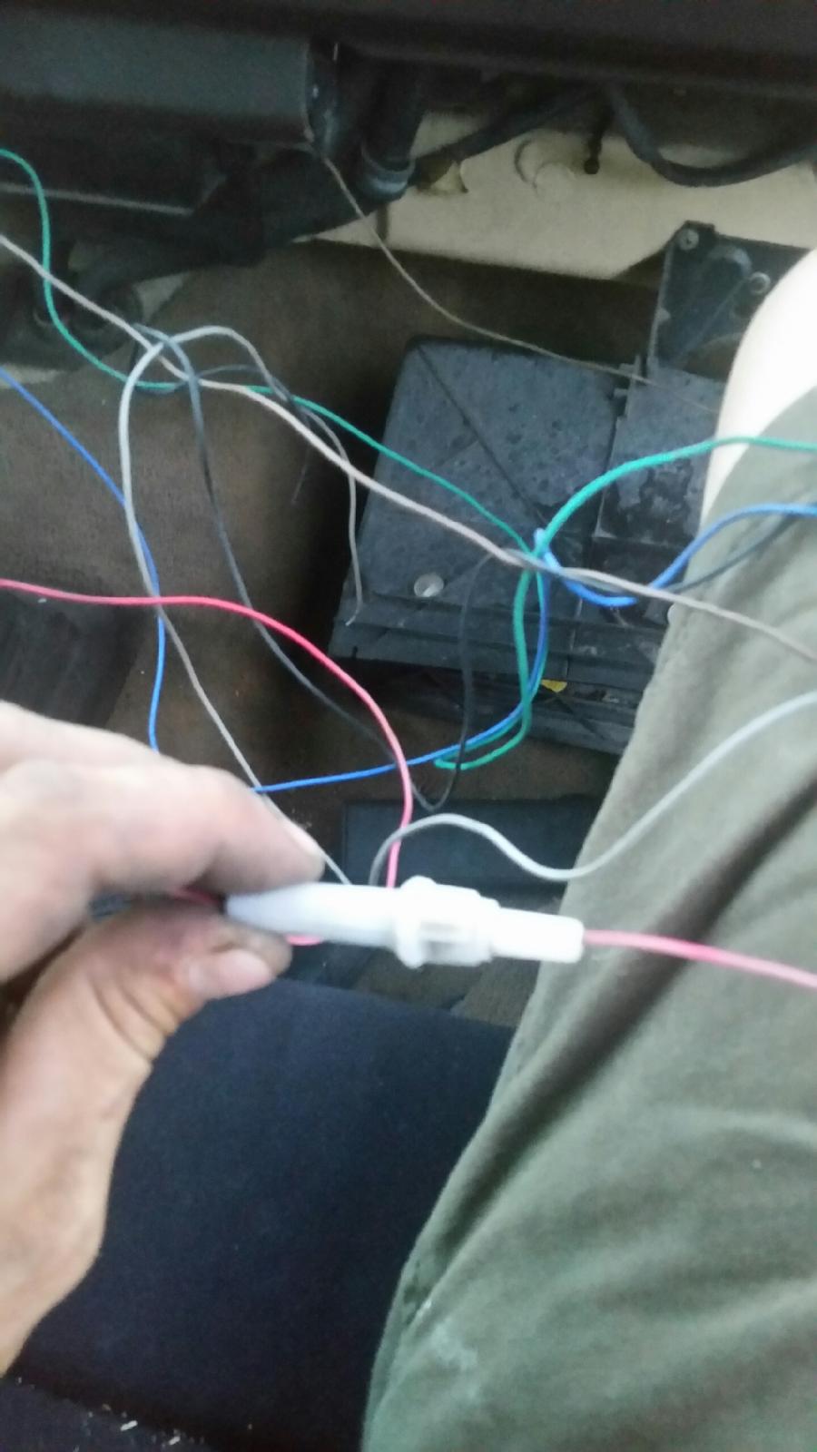

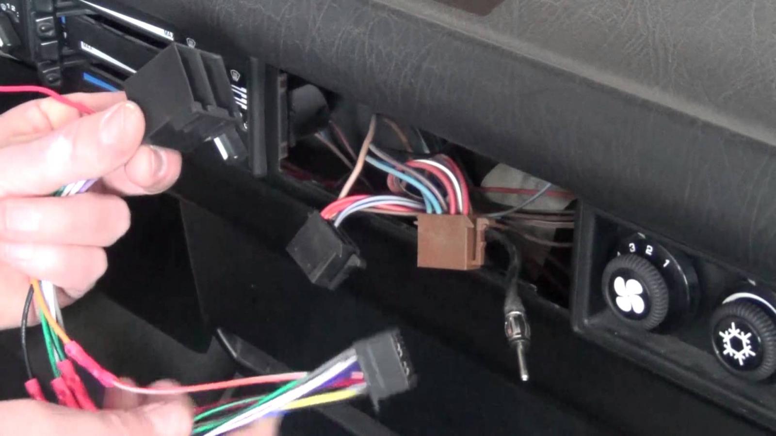

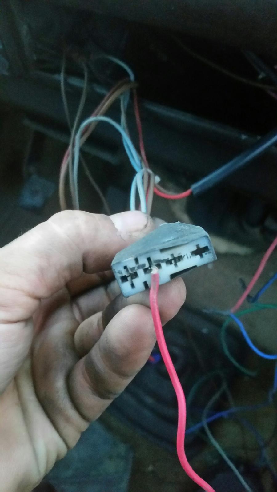

I've searched this topic and see it gets beaten to death 10 times over. I still feel the need to post this. I bought my van with no radio, just a stock looking plastic cover for the hole. I pulled all the wiring out and found this mess. First thing I noticed is I don't have the two plugs other vans have, one brown and one black.
These plugs:

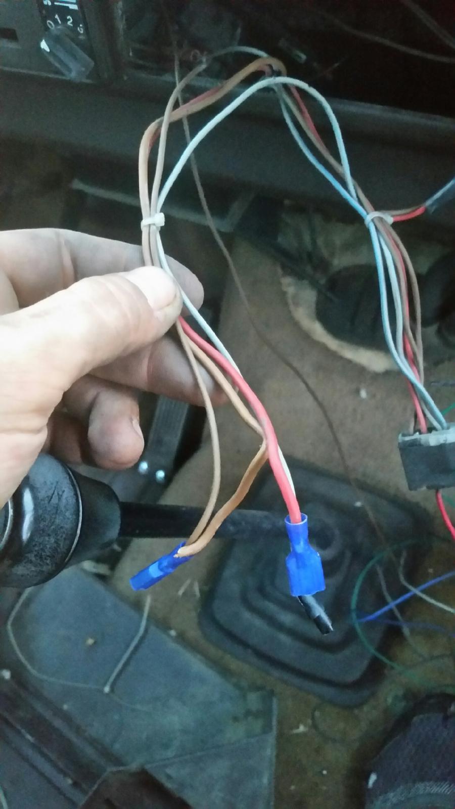

I had a plug for the cigarette lighter that I cut off and wired female spade connectors to.
I also have this weird plug that I can't seem to find a picture of in any other stereo wiring plug on this forum.
That plug has a red wire just shoved into the other side of it. Don't know why it is there.
I pulled that red wire out. That wire runs down to this plug with several other wires. The red wire has an inline fuse.

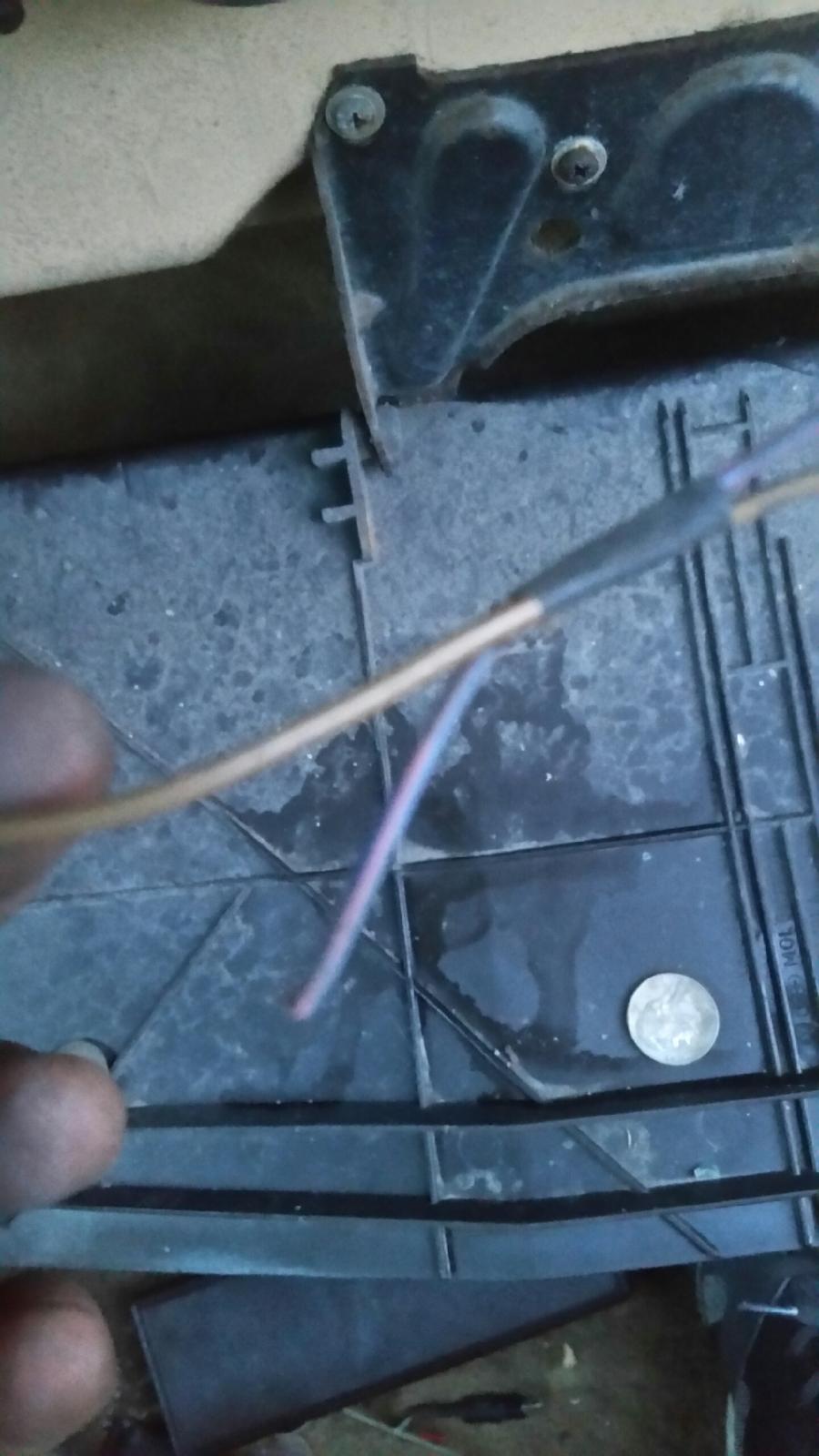

There's also this wire coming from the speaker on the passenger door, running behind the glove box. Not sure why it's cut.

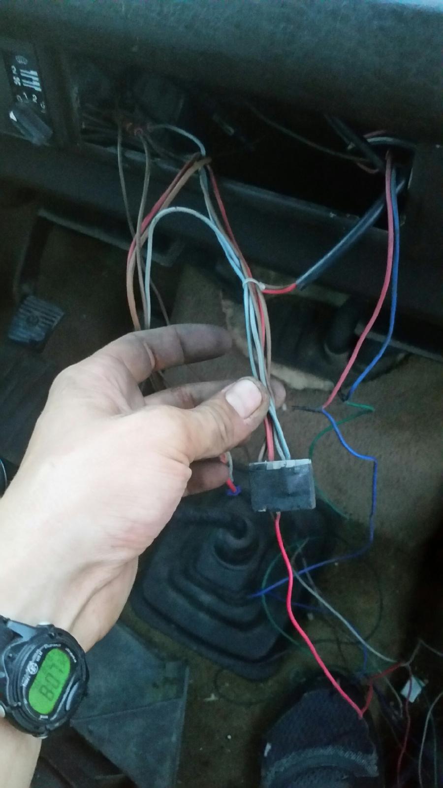

What I can't figure out is what those two plugs are, and why my wires are routed the way they are. Pretty much, I have no clue what's going behind my dash and need some help making heads or tails of this.

The connector at the end of the red wire is the end of the harness of an old (80s), relatively cheap aftermarket radio.
The white plug you have there looks like an older factory one. The only connections you really need to concern yourself with are:
Red - constant power
Brown - ground
The gray/blue wire is dimmed illumination (from the headlight switch) and isn't needed unless your new radio has an illumination connection. Even then, it's not required.
Pretty much all modern radios have a constant power connection, accessory/ignition switched power and ground and assume that you'll be wiring them so they go off when the key is turned off. Vanagon switches don't have an accessory position, so switched power means that you have to have the ignition switch on all the time to run the radio. You can just connect both the switched and constant radio power connections to that red wire but most radios will end up drawing a few hundred milliamps all the time, which will kill your battery over the course of a bunch of days. In order to deal with this, you can either (a) unlatch your radio's removable face whenever you're not using it or (b) wire up a switch somewhere, which you can use to toggle power to the radio's switched power lead.
As far as the speakers go, don't trust that the car matches the diagram. Incorrect polarity, while harmless, will cause your speakers to be out of phase, meaning the cones don't all move in the same direction with each pulse of bass. What this means is that your already wimpy little speakers will have EVEN LESS bass, due to phase cancellation.
On the speakers, the positive terminal is usually larger, and/or has a "+" stamped somewhere or a red dot. _________________ 1987 Westy Camper |

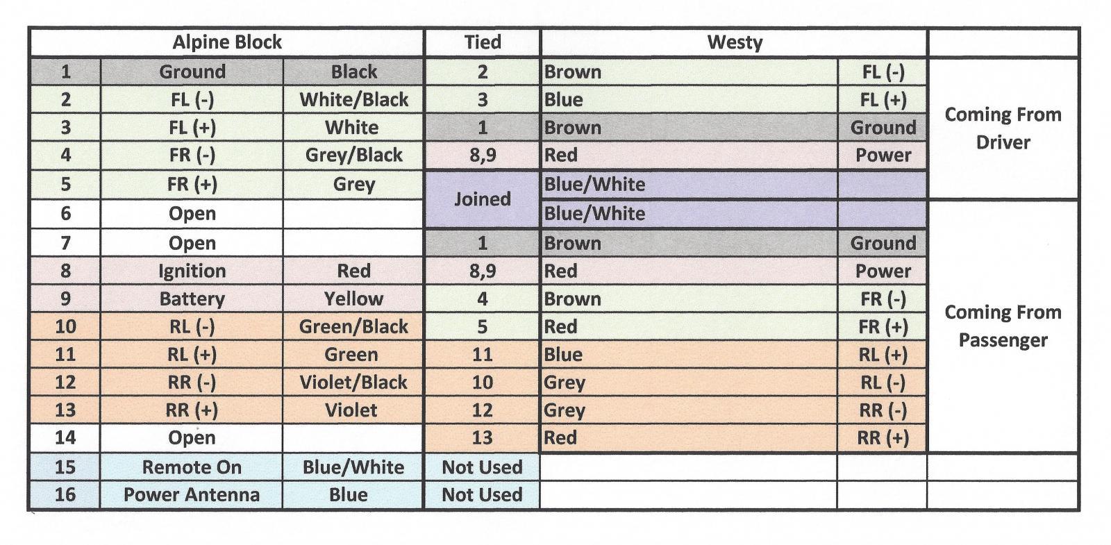

I downloaded these for reference. I don't recall what year Westy refers to but likely 86-91.

Does that splice into my harness to replace the stock one that is usually there already?
And then you could plug those into the pigtail gowesty sells for aftermarket stereo installation? _________________
