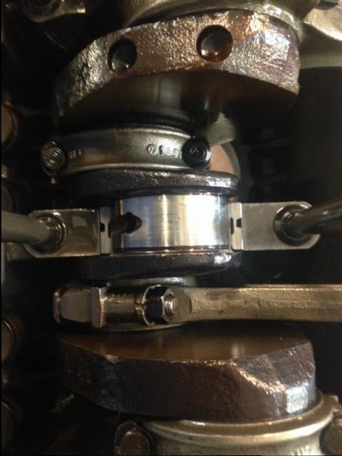

Thanks so much for the help. Now I just need to figure out what size valves to order when I get to that point.
Got the stuck oil pump out by searching and discovering that I should loosen the nuts above and below the pump and then gently wiggle it out. Worked like a charm.

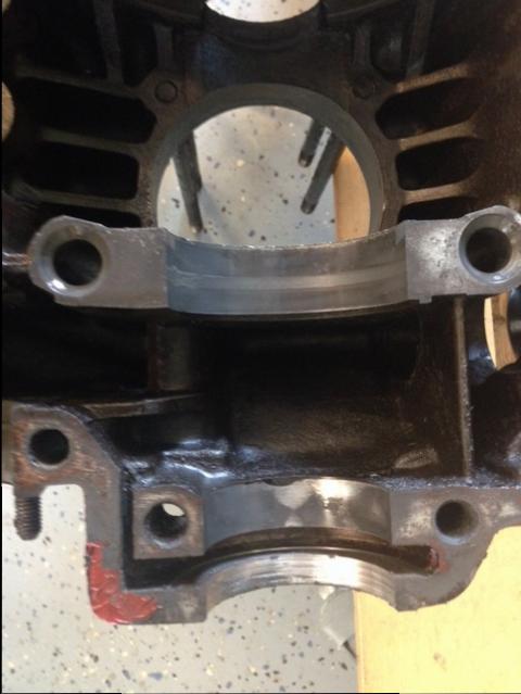

Next I went to the other end of the engine and removed the flywheel. These holes for the dowel pins aren't supposed to be oval are they?
and the same thing on the flywheel:
Please take a look at these and comment. I never had to split the case when I rebuilt my 36hp so this is all new to me.
And I discovered the hole for the dowel pin for the bearing next to the flywheel also is ovaled out.

The flywheel and crank are junk.
The case may be able to be saved. But a VW machine shop is going to need to inspect it.
Search YouTube for VW thrust repair.
Good luck
