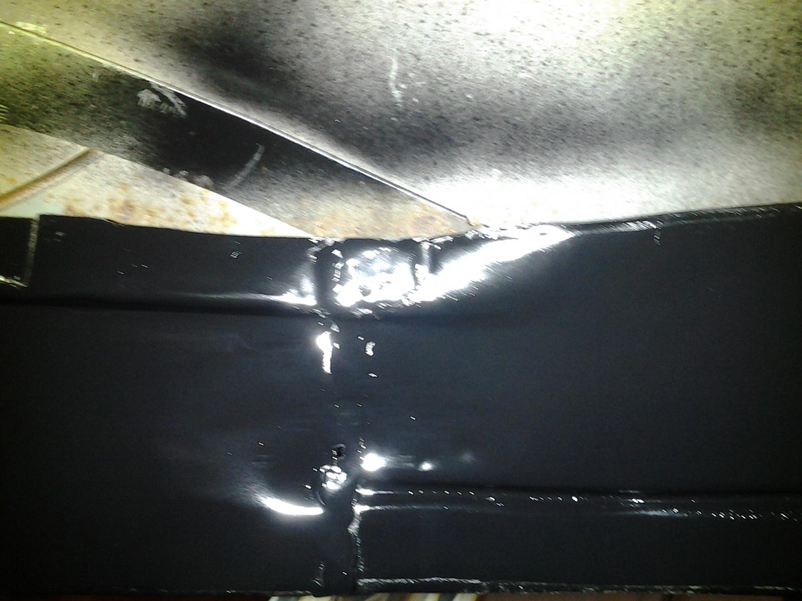

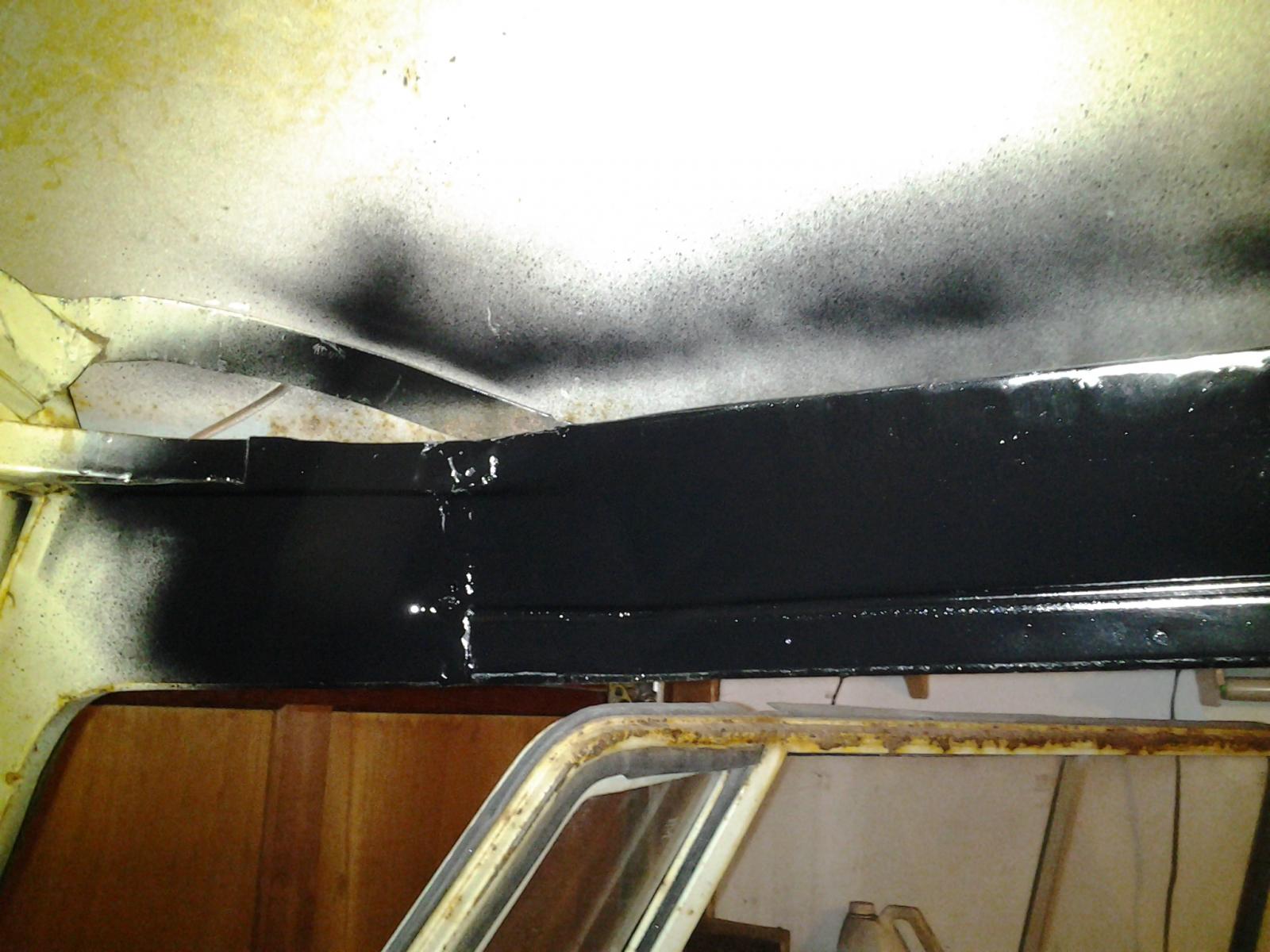

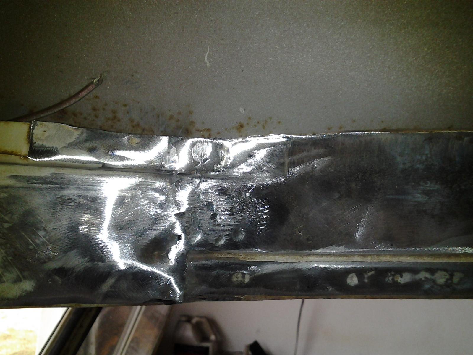

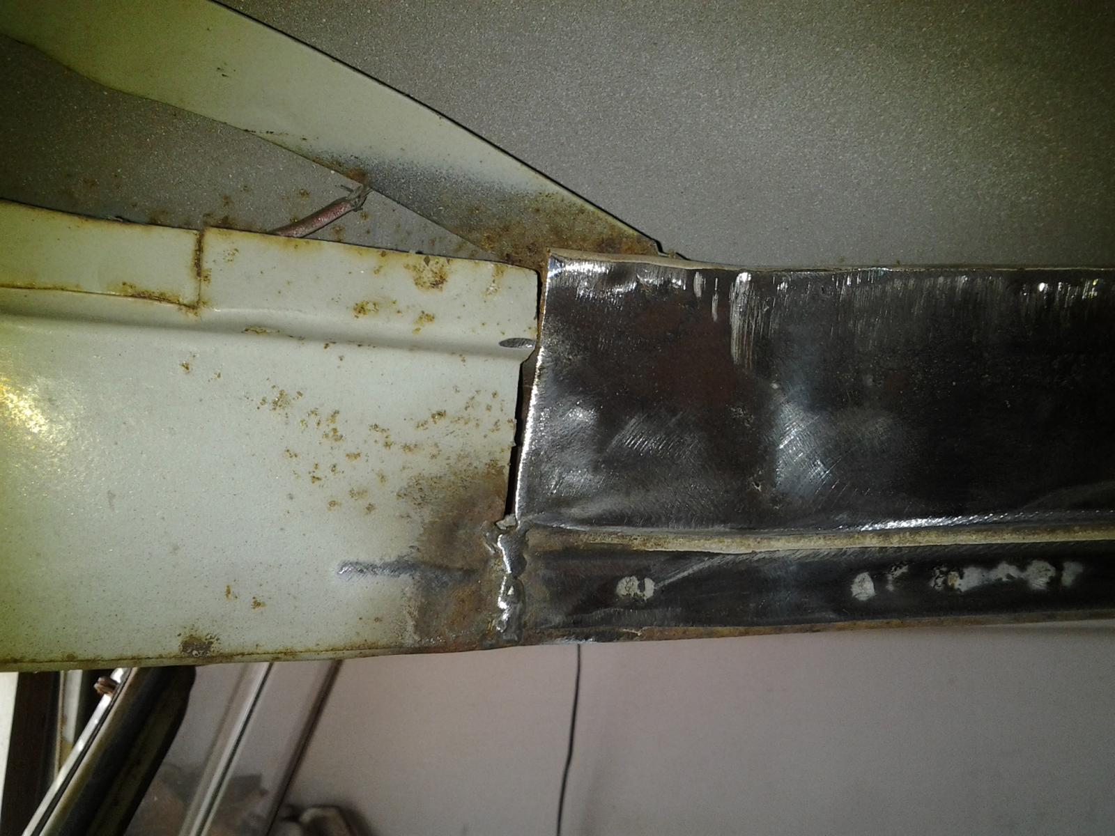

been awhile since I have felt good enough to work on this
the guy who did the roof graft set it up to have a headliner in it so he didn't complete certain parts of it
but since i'm doing a camper interior in it and these parts are going to be seen I have to fix them
first issues was the difference between early '60 and late '60/'61 pressings above the doors
I didn't like the option of having to cut out and replace the whole section so I modified it to blend into each other
this is what I start with
first I welded the flat part up to the bend
then I bent the metal to match the front part welding it as I went
also had to even out the top so it was level then I just gently hammered the rest to blend into each other
still have some work to do with a die grinder and maybe some all-metal but this is good enough for now will complete it when it comes time to do final paint job
also had to complete the weld on the b pillar from the graft

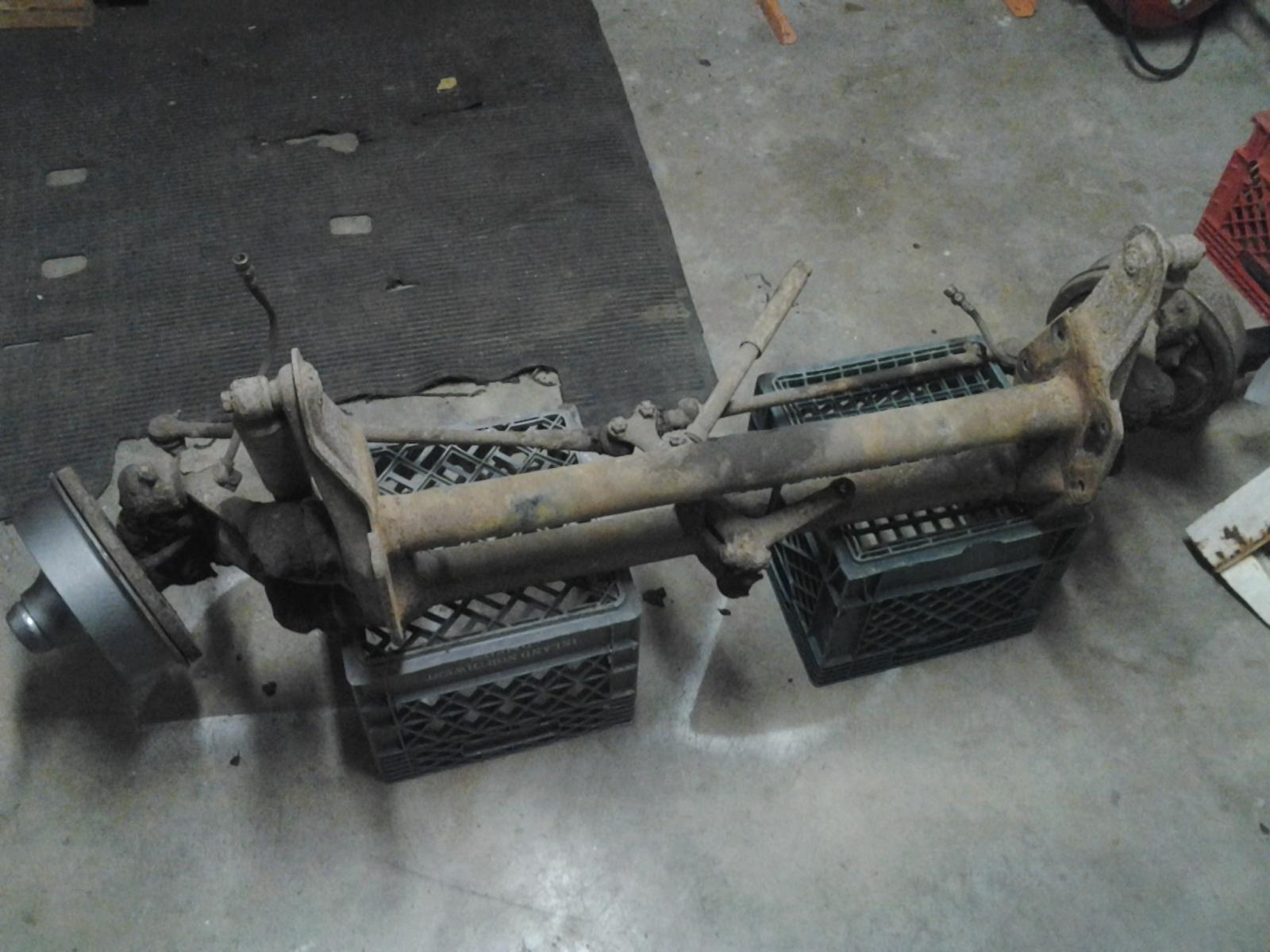

since physical therapy has been going good I have been feeling good enough to work on this again within limits of course
over the last few weeks I have spent a few hours trying to get the beam out
it fought me every part of the way though since it had never been removed before. even the drag link was the original style with the grease fittings on it and since it's stuck on the steering box arm which is also stuck on the box itself I guess it's coming out next Rolling Eyes
old one out ready to be used as trade, the new beam will be a 1 ton with drop spindles and adjusters

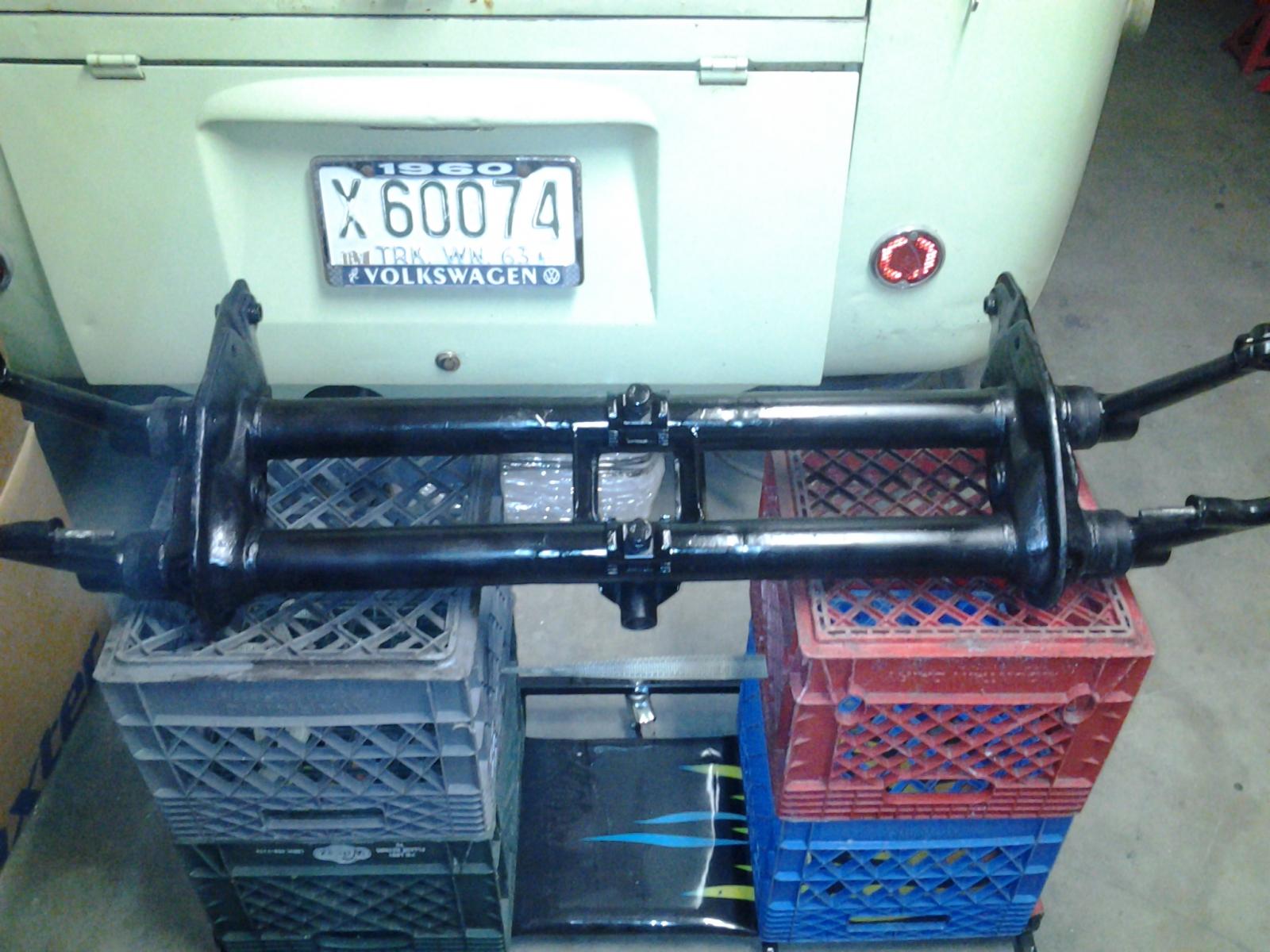

I did get a 1 ton beam with all the goodies I was missing
since I like the look of the early center section and I had to cut the beam anyways to clearance the center block for the adjusters I mated an early center section with nates beefcake adjuster to a 1 ton outer section with good roller bearing and a nice set of trailing arms
also picked up a set of 1 ton dropped spindle rebuild by greg (campingbox) that I will be installing soon along with all the brake parts

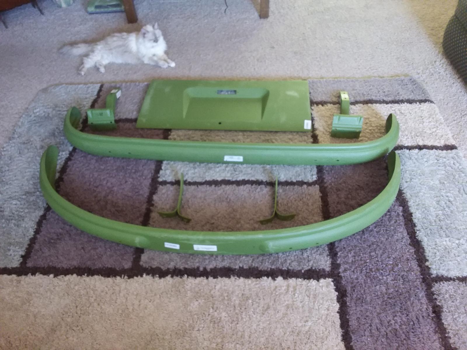

Got my wagenswest bolt on irs kit with adjustable springplates and e-brake adapters
Also got some KF pressed bumpers, brackets and a '58 decklid to cut a brakelight into since the brakelight ones are out of stock everywhere infact this was one of the last 3 flat decklids i found Rolling Eyes
Of course Princess Zora has to inspect all parts shipments for quality Laughing
Also found some smal spoons latches at vintagemeet and some other chrome goodies
Got several sets of pop-out for super cheap locally and out of all 10 of them i think there are enough good pieces to makes 6 nice ones
May have to cut and splice a few of them together though Wink
