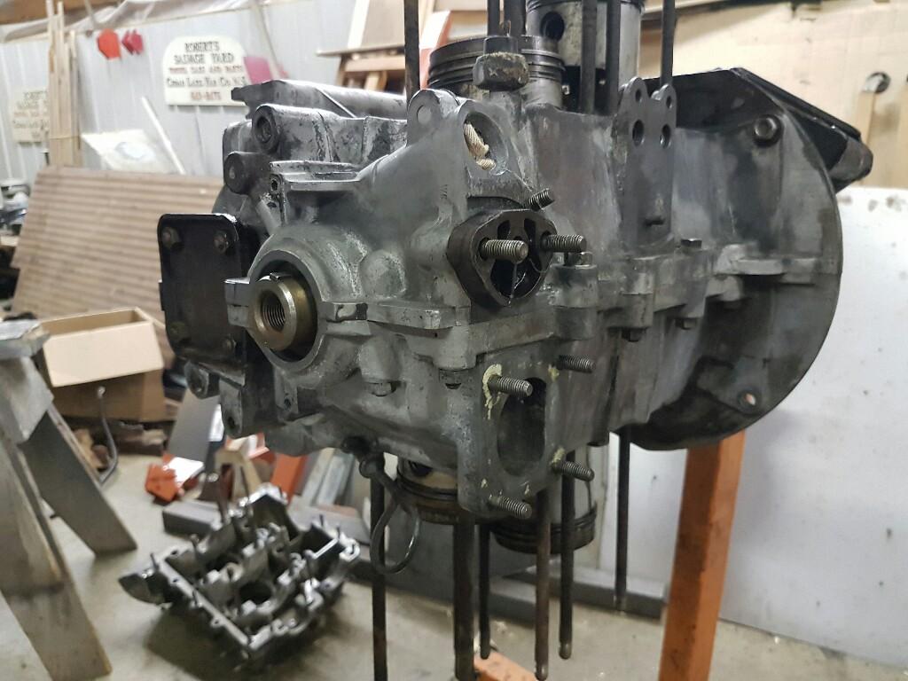

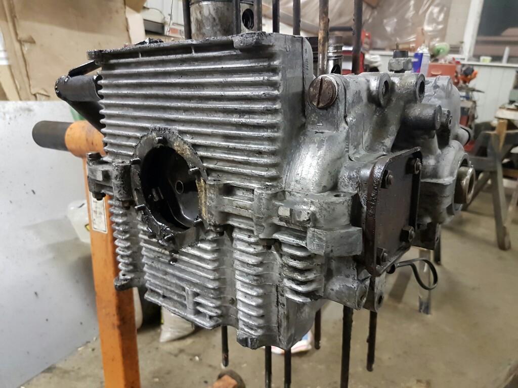

Put the engine on the stand. Much more solid than I expected.
Good news. End play look good. The pots are nice and smooth. Pistons tight. They are 1500. Heads look great. Will inspect the oil pump.
So will get valves done, new rings, crank seals, pushrod tubes, oil pickup screen and new oil cooler. Oil cooler is bent and damp.
Probably should have cleaned the block before the head came off...

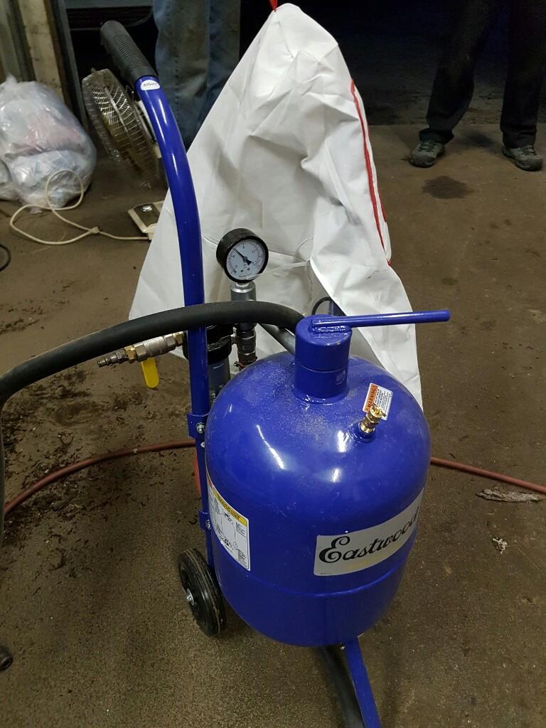

Sandblaster finally arrived today. Assembled and tried it out. Very happy. seams well built.
Going to get a pressure regulator for it though. Seems to work best at 60-70 psi with 80 grit.

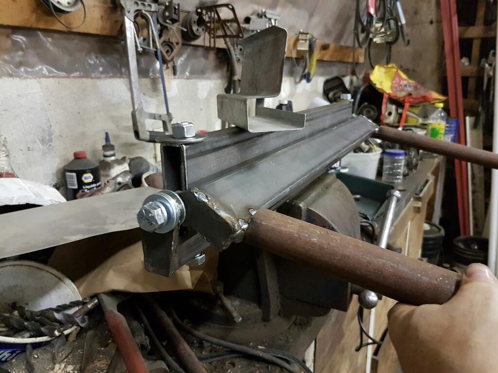

Finished my brake tonight. Made out of 1"x2" tubing and 1/2" bolts. Bends 18g very well. It is 24" wide but not sure how well it will work full width with 18g. The top tube flips over for a larger radius bend.
Kind of wish I hadn't purchased the outriggers...

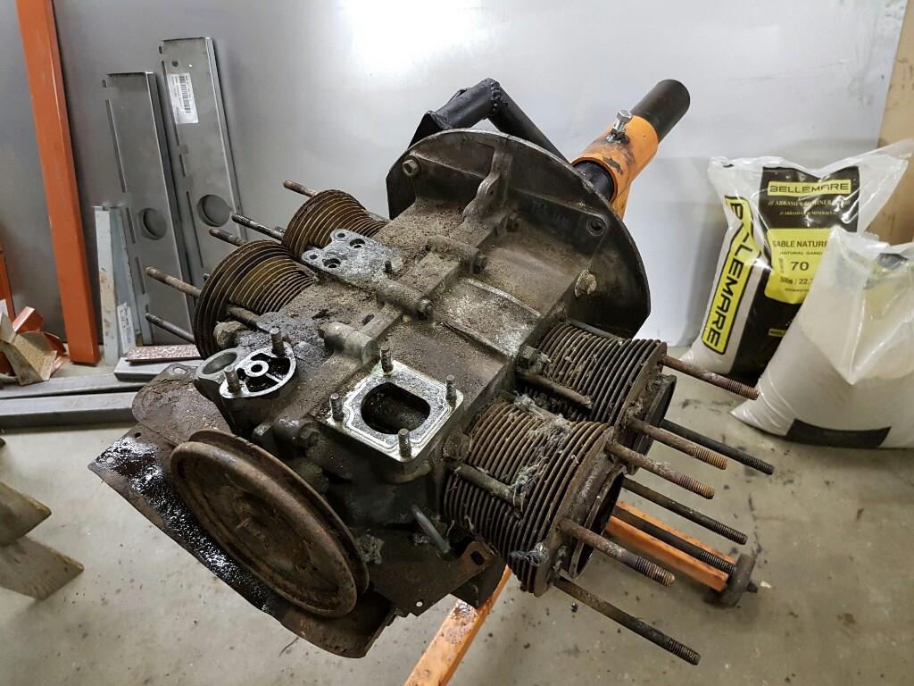

Ordered my engine parts so I can get it out of the way. Blasted the pots with 70 grit and sprayed them with a bare metal treatment. I will pick up some flat black high heat paint and give them a thin coat.

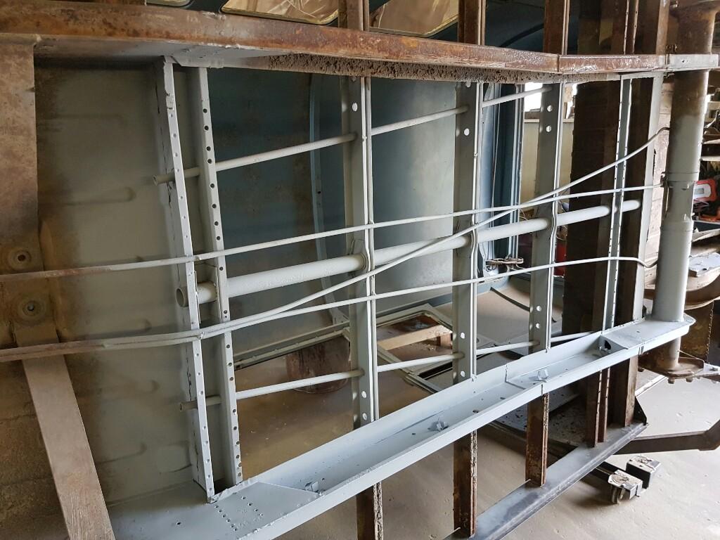

PostPosted: Sun Oct 23, 2016 1:01 pm    Post subject: Re: 64 Kombi partial restore Reply with quote

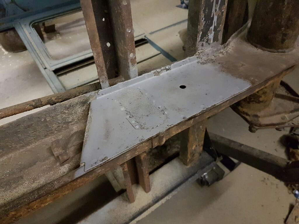

Think this is the worst part done. Pain to scraped all that undercoating off the cross members. Getting the hang of the blaster though. Using a smaller tip gives it more cutting power where the rust is deeper. Used another bag and screened and reused it twice. It seams to work well.
What to do with the pitting? Think I will just paint over the small pitting. The paint should fill in a lot of it.

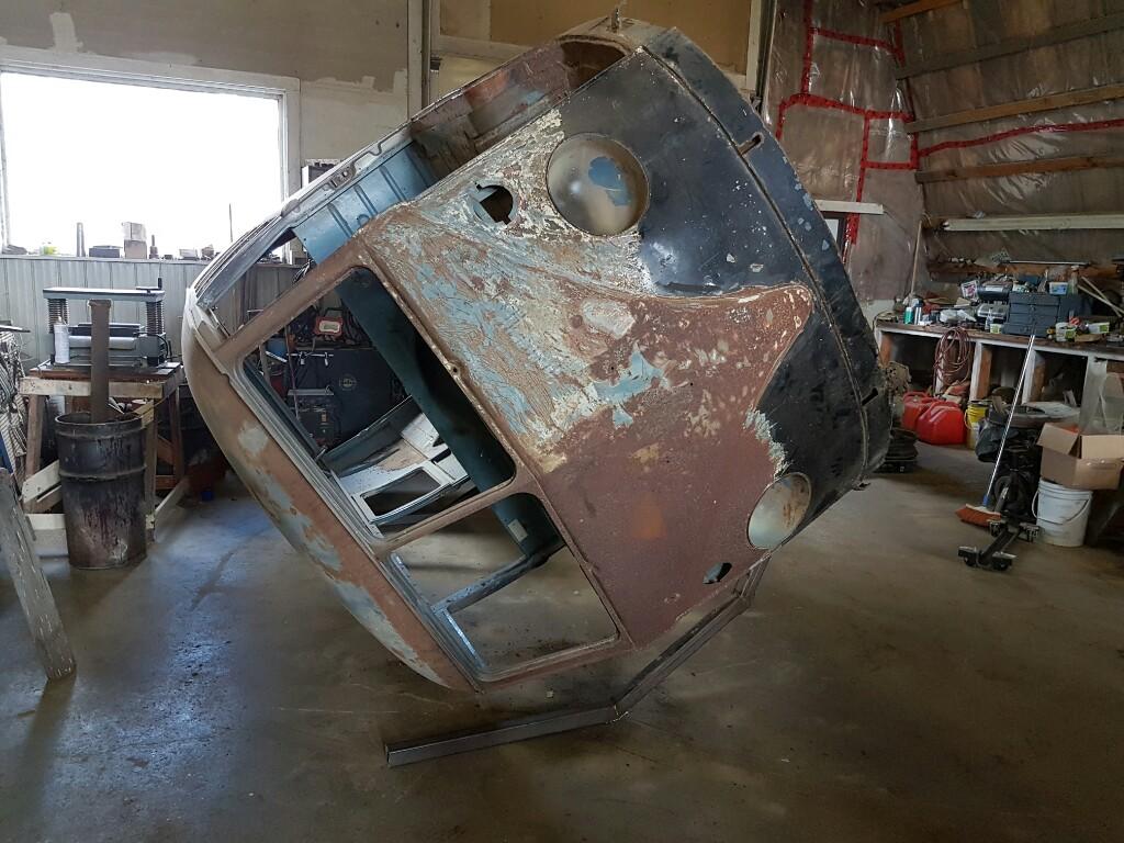

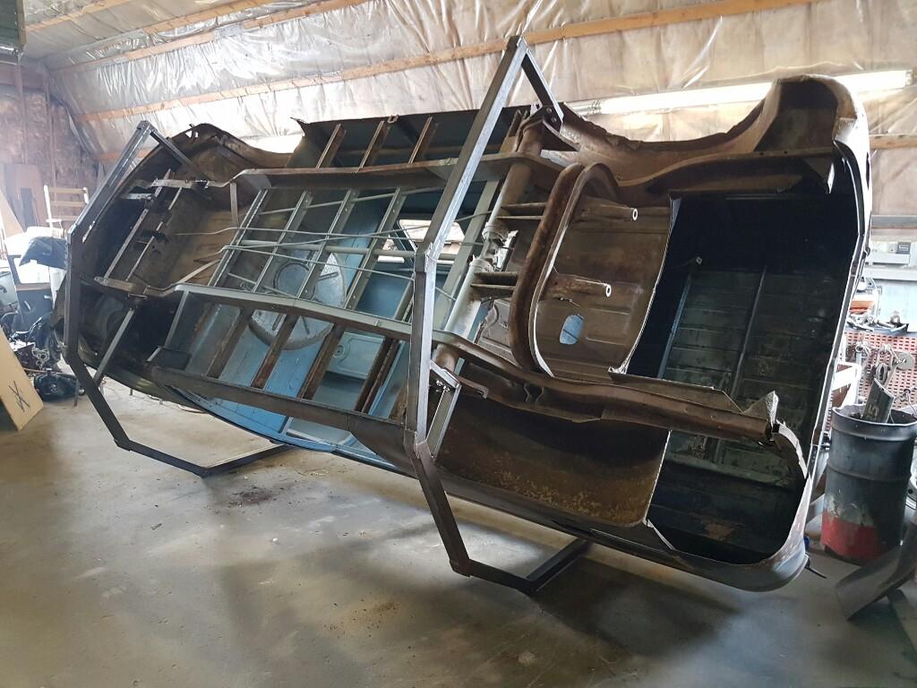

Added last piece to the rotisserie. Realized the extra rotation will be useful.

I put on a thin layer of high heat paint. Have all the parts to assemble the engine just need to clean the heads.

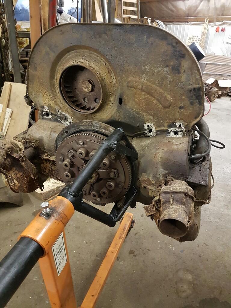

Heads cleaned up. Started to blast the valve covers but the fist one was a little thin. Will need some new ones.
Almost time to assemble the engine. Considering splitting the block and giving it a good cleaning. Had a lot of sludge in it...

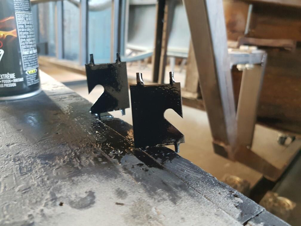

Been a busy couple weeks so haven't made any progress. Did get some blasting done today though. Using fine glass grit and it seams to work very well. Will see how it does the second time around.
My shear finally shipped so I will be staring reassembly of the bottom soon.
Nuts were ripped out for pan. I will remove a small section, straighten and weld a nut on the back before welding it back in.
