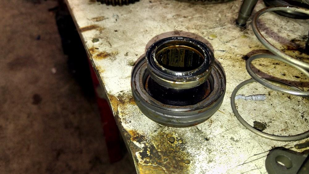

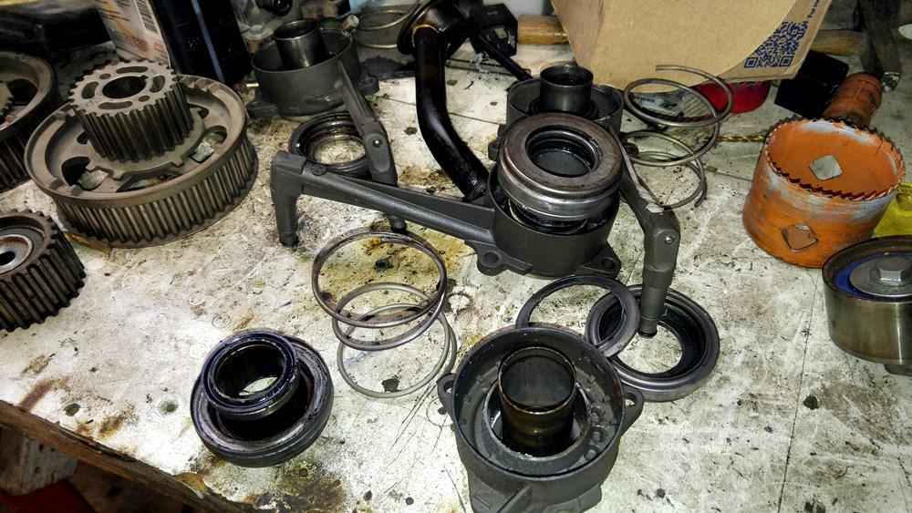

I have 7 broken slave on my desk....
I'm a bit pissed off. This WAS NOT happening before, something as changed in the bell housing design.
All slave went simply to far = the spacer is not long enough.
Thanks for the drawing, I will find a solution and take picture.
For now, admire those... (pissed)
Broken.... seal
No more beveled edge to stop the slave to go further
How many do you want????

The SS Bell Housing Slave is a VW stock part used in many VW cars.
It's NOT a problem part IN the cars. Even If I'm no fan of internal slave it's still not a bad parts.
I just don't get what as change over the months / year

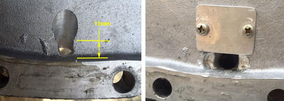

Folks say that the mis-match between the Vanagon master which expects a 19mm slave and the Golf slave (being linear not a linkage - plus a volume mismatch) causes the clutch action to be abrupt.
I had a problem with the clutch slave belching its fluid out at the very beginning, 1,000 miles from home. It was not a happy moment. But now 36,000 miles later, I've had no problems with the clutch slave (knock on wood). It's possible that I had "air in the line" protecting my slave. Smallcar eventually learned the spacer was required, but never contacted me.
But now I have limited the clutch pedal throw with a crude device. I will do the Fred mod to my clutch pedal someday, and am looking forward to restoring proper clutch pedal feathering (modulation).
There's a pretty significant problem with Smallcar's drain hole placement that leaves 1/2" of contaminated oil in your trans. Your big engine is generating more metal in your gear oil, and at the same time, the Smallcar bellhousing has a "dam" on the bottom that prevents you from draining this steel out. Not good.
Smallcar has a strange way of satisfying customers. If they would jump on these little problems immediately they could be the heroes, for all their innovations. But they've been pumping this KNOWN error out for 7 years now. It can be fixed in 5 minutes but most customers don't find out about it until the new engine is all bolted up, then start the expensive process of dooming their transmissions.
With the RJES bellhousing you can drain the bottom to get the funk out. And the magnet is at the very bottom too, it can pull more of the stuff out. Smallcar method puts the magnet pretty high up, and in a 'hole' where it can't pull stuff from the bottom.
I covered the top of the hole because I have a cooler/pump system, I wanted to suck ALL the gear oil out with as moch velocity as possible to get the trash out. For a simple drain you wouldn't have to cover it as I did (but it's easy to do).
It's easy to finish their job (modify it) if you have the bellhousing OFF. Impossible once it's put together.
Broken.... seal
Well there goes my "metal body" theory I posted earlier.....Just out of curiosity what brand are the slaves? Any OEM VW?
VW/Audi part # :05A 141 671 F (metal version)

I did a lot of testing today, calculating the amount of oil in both the SC internal slave and the OEM master. Here is my test system, a big thanks to Sodo. This will not be the final product, I find it big a bit for nothing.
