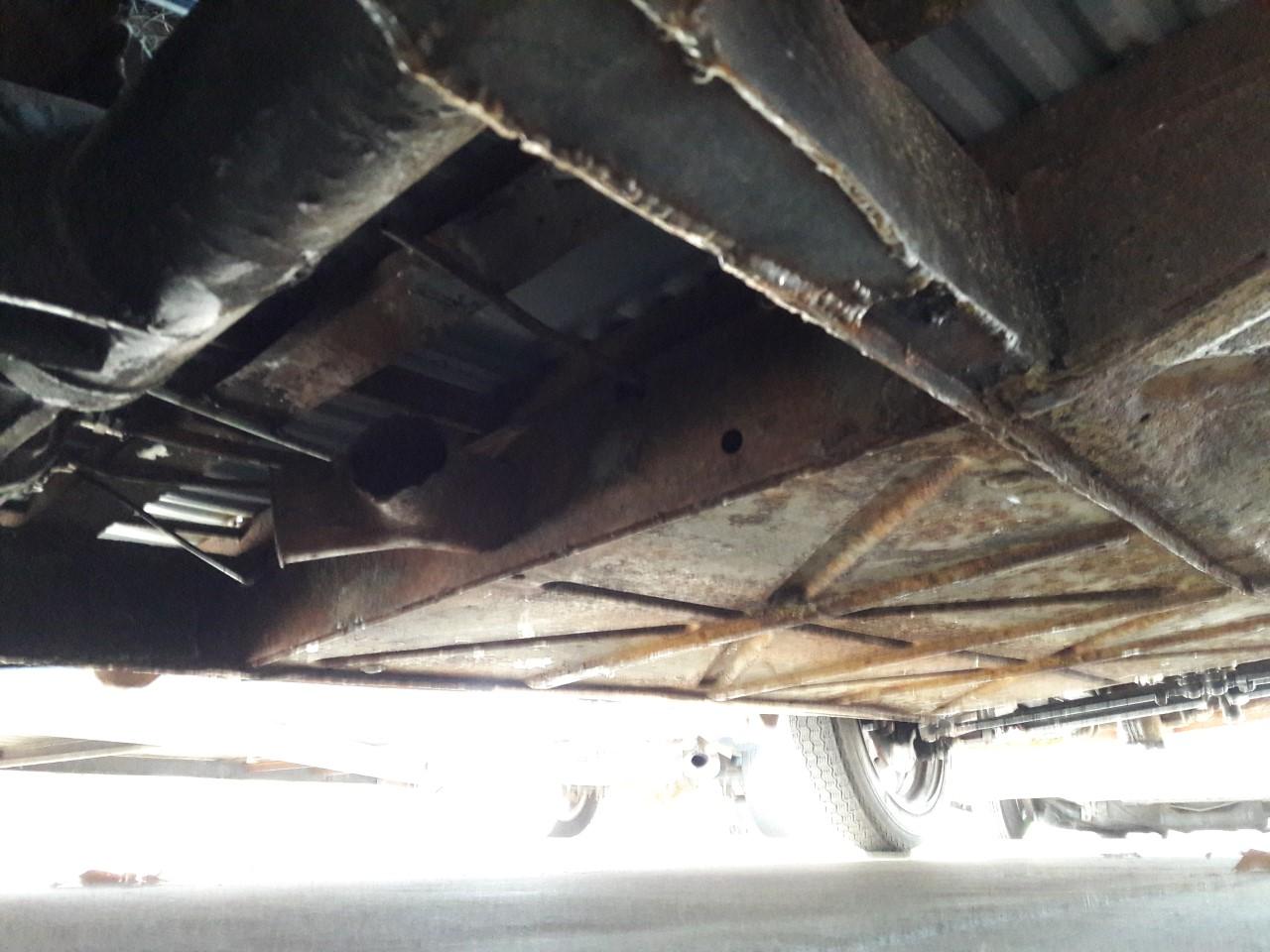

PostPosted: Thu Dec 29, 2016 5:41 pm    Post subject: Re: VIN Plate for true identification of bus type? Reply with quote
Does anyone see anything here that says this is a true 21 window bus?

PostPosted: Thu Dec 29, 2016 7:21 pm    Post subject: Re: VIN Plate for true identification of bus type? Reply with quote
Hard to say aside from the belly pans appear to be OG. But the rest of the rust repairs are BRUTAL!, I'd be very afraid to peek under those belly pans, if the frame needed that much work ahead of them odds are good the same demons are hiding behind as well. If that many corners were cut underneath look at the rest with a very suspicious eye.

PostPosted: Thu Dec 29, 2016 8:17 pm    Post subject: Re: VIN Plate for true identification of bus type? Reply with quote
I hear what you are saying. Looks to be some poor patches here and there. However If the rest of the frame was in poor shape, wouldn't the belly pans be heavily corroded before the frame would suffer?
The rest of the bus per the current owner and supplied photos looks fairly solid.
Thoughts?

ugly repair work. Do your homework on this one, real or not....
Almost looks like a whole front clip.
