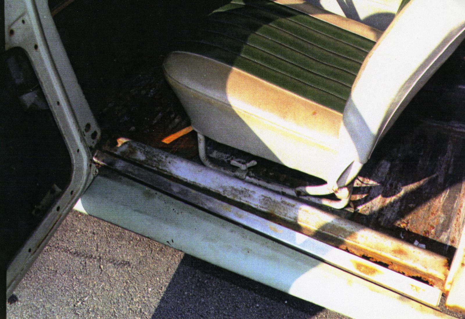

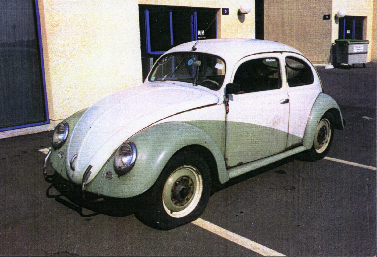

are you sure this is the same car? i only ask because the VIN plate is misding in these photos, and in the new photos it is there and looks OG; also the rust/rot in the lower drivers threshold area is not evident. Also almost none of the interior paint looks the same. Jesse "claims" most of the interior paint is original. Also in the old photos the car doesnt appear to have the 82E running gear. the stance is more like standard beetle. And seller claims all running gear is original to the car, not just "correct" for the car.
someone else in this thread also mentioned that the car used to be blue in that same person had another 43 KDF I think that was green and white, so to me it seems like this is the green and white kdf, not the 82E...?

It does appear that the ride height was of a normal sedan in the old pictures. It could have been converted to standard suspension and then converted back to 82e specs at some point.

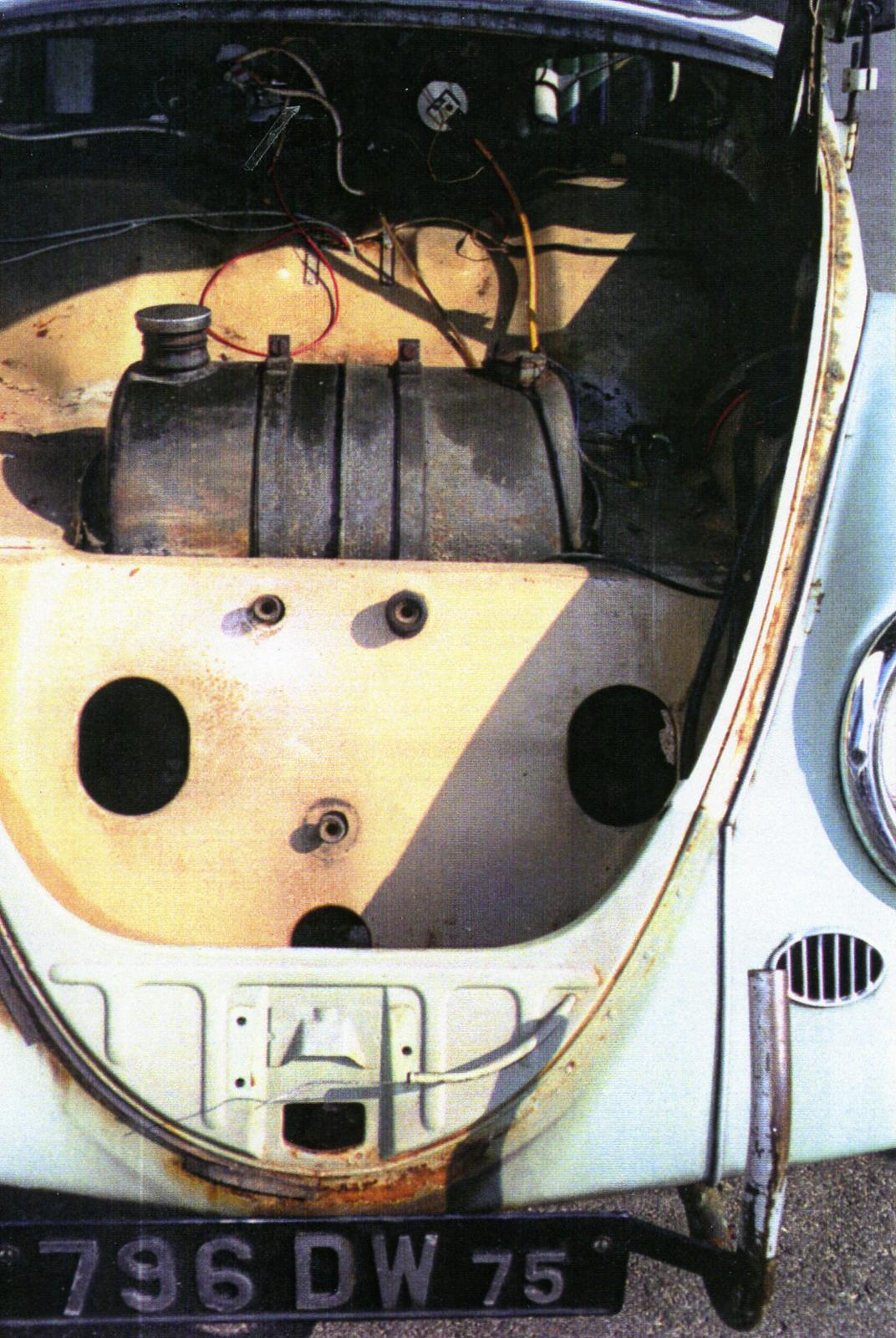

VWmeister wrote:
I took these pics just after the auction sale. This is exactly as it was when I've got it. The first VW Cal Look ever including T bars !
It was advertise as a 46 model because it was not registered before ! Nobody knew anything about KdF at this time. I was the first to spend 3 full days in the VW archives with my wife Cathy, to hand write all chassis, engine numbers, production dates and delivery, name of owner of the 1200 and so KdF made during war time. This because I didn't want to hurt the original VW books that had never been opened flat.. Dc Pidoll did the same some years after me but as a german, he had the permission to photocopy all the books in which you have also 40 000 Type 82 because the KdF were built in the same sequence !
