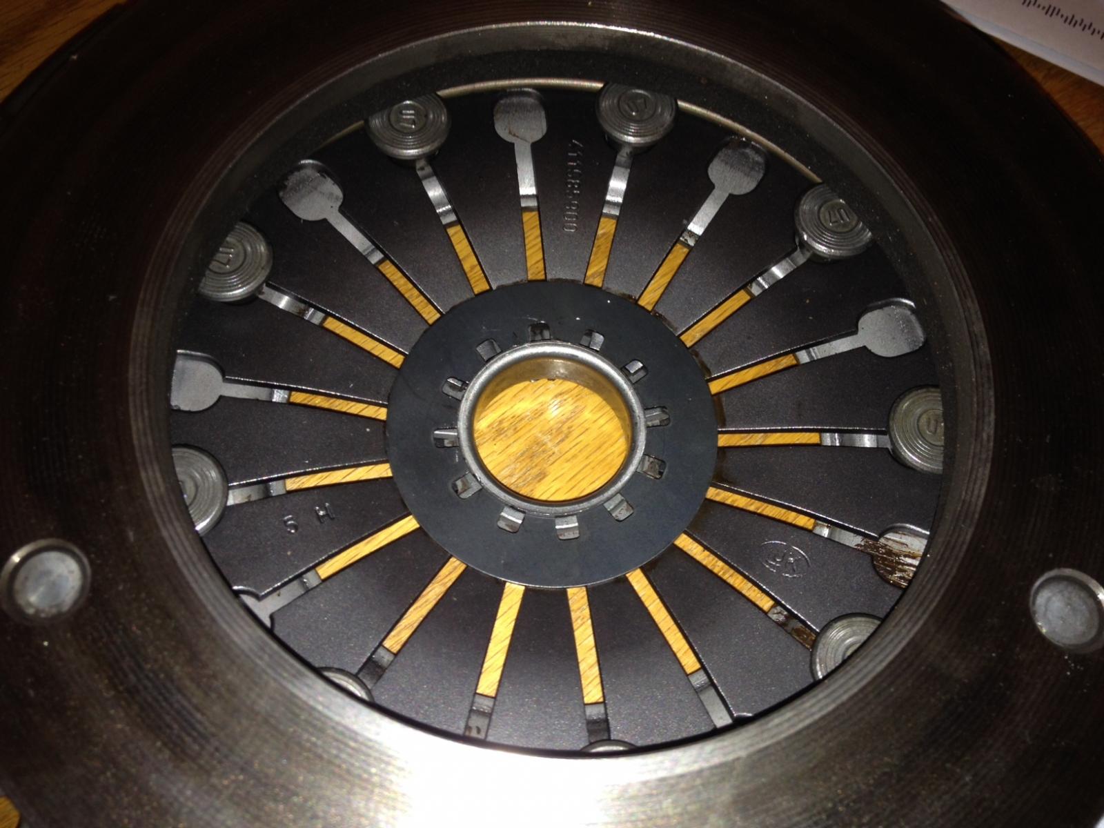

How do you remove the centering ring?
Photos of my PP.
On the inside of the PP (as pictured above) the dark colored ring is a large "starlock" similar to this, but larger:
It is pressed onto the outer ring which passes thru the center of the diaphragm. Using a screwdriver, pry it off from the inside and you can then slip the outer ring off the diaphragm.

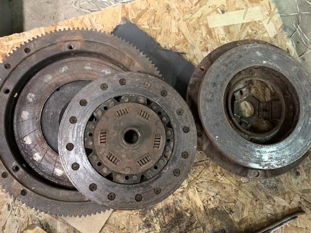

This thread is great. So I’m going through on early 65 trans setup with a 68 engine. I owned this since 1984 but it’s been sitting since 93.
As you can see it has the old style parts and a 9 spring heavy duty pressure plate (from a bus at the time I think). This setup was great and I’d like to keep it.
While rusty the pp looks ok and springs are all still ok. Looking for specs on pp thickness as well as flywheel thickness to consider just resurfacing. Obviously the clutch disk will be replaced. Since these parts don’t mix well and I’d really like to keep the 9 spring this might be best if possible.
