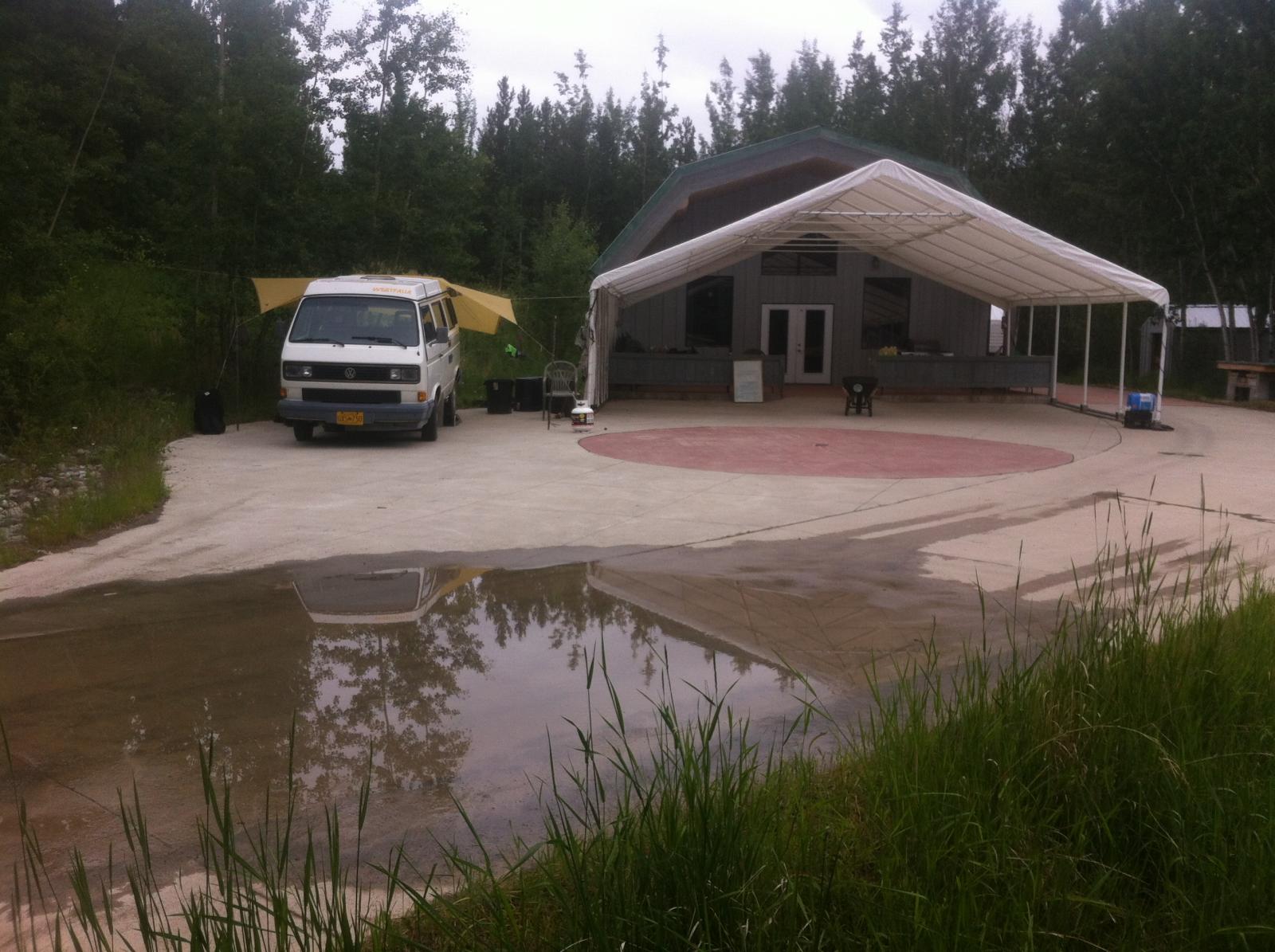

Here's the set up, at the NOLS base in Whitehorse, YT: It was pretty nice to have a concrete surface to work on...

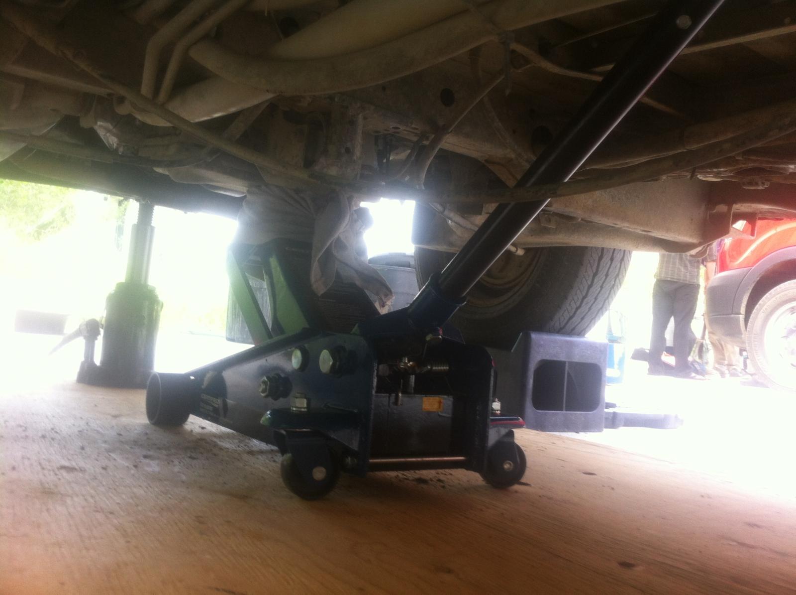

Went to Walmart, bought a 3 ton jack, 2 jack stands, and a boat winch - I kept them all clean, kept the boxes, and returned everything 4 days later... moral? maybe... thrifty? yes... the whole operation cost me about $50: TC Seal ($12?), Puller, Fluids, and a few trips to town...
One thing to add to Kourt's list would be to support the engine! - I didn't know that and luckily a friend told me to do so... I know, it's a no brainer, but I just didn't know... I used a bottle jack and plywood to support it gently...

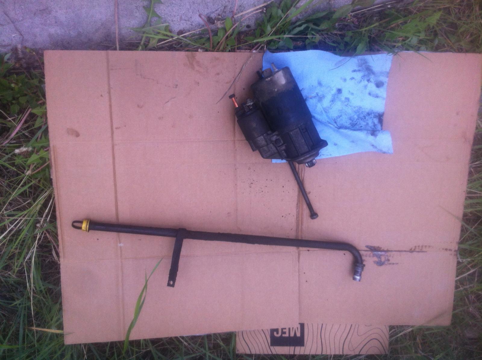

Starter and AT dipstick - Beware of the copper post! I stripped the last few threads on this puppy removing the nut, clean it first... had a bear of a time getting everything back on there, almost didn't make it...

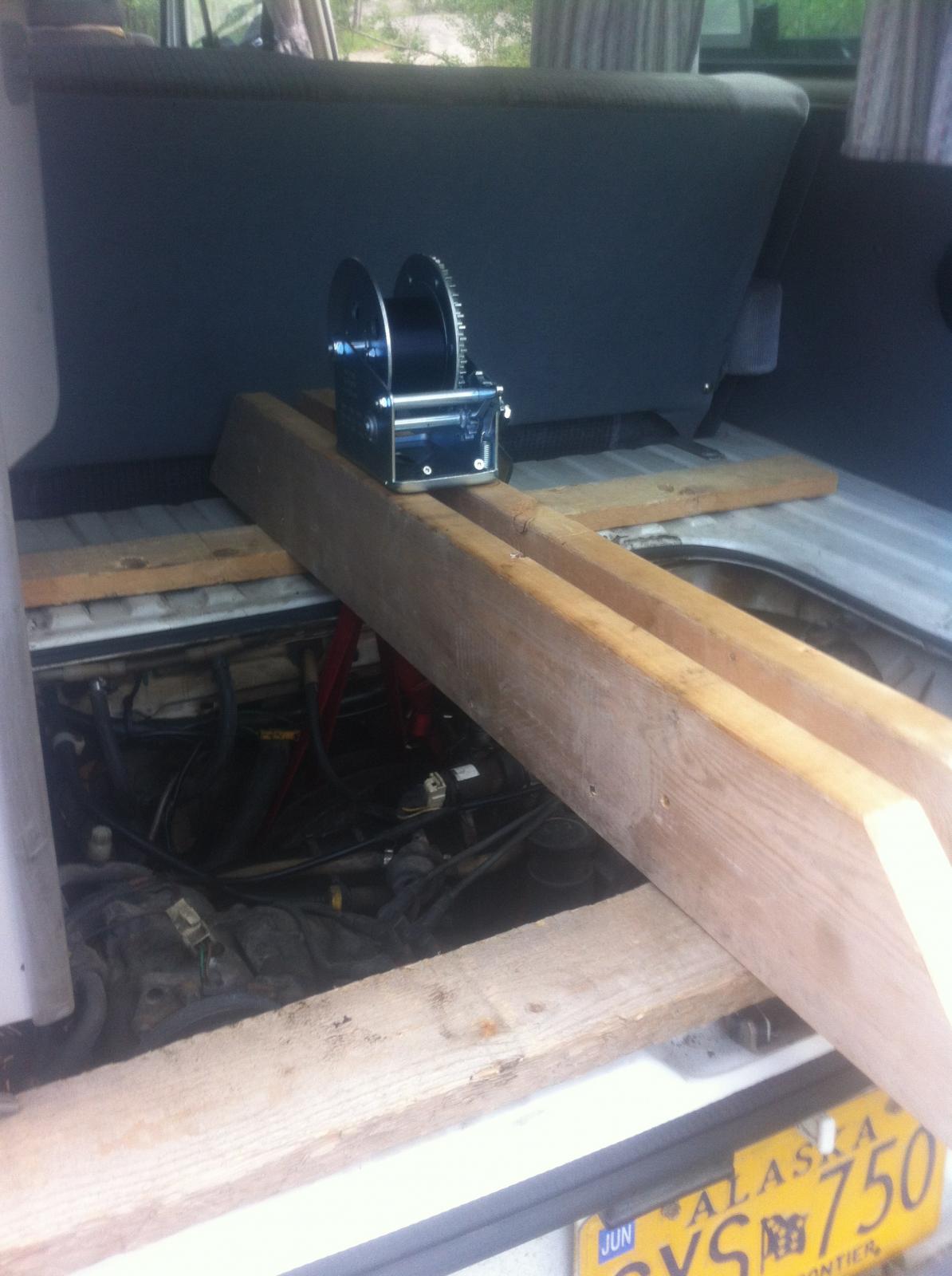

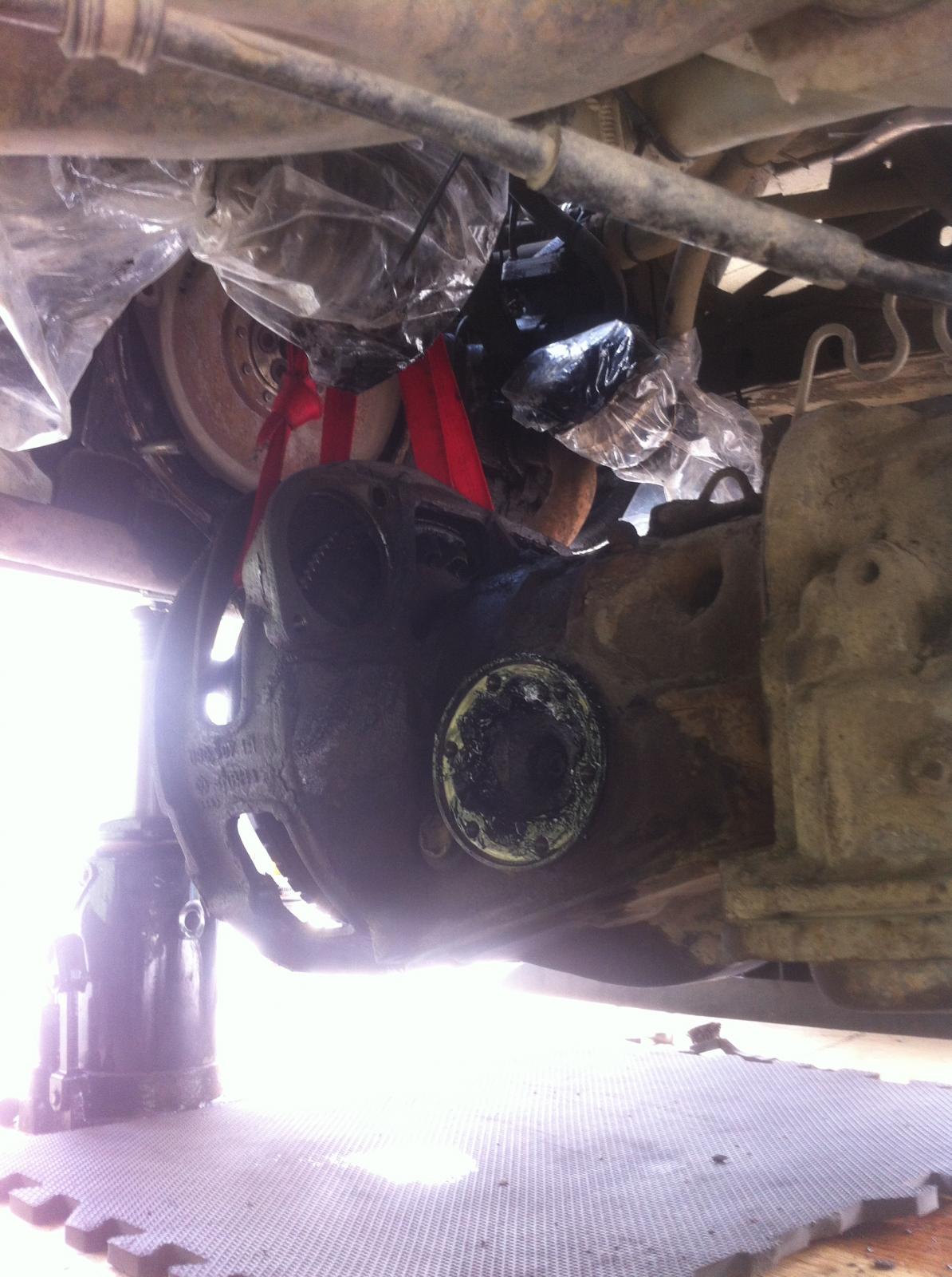

Kourt's set-up, only I used 2x6 on edge as it seemed I needed the extra space to get the right tension on the webbing...
Webbing through the bell housing

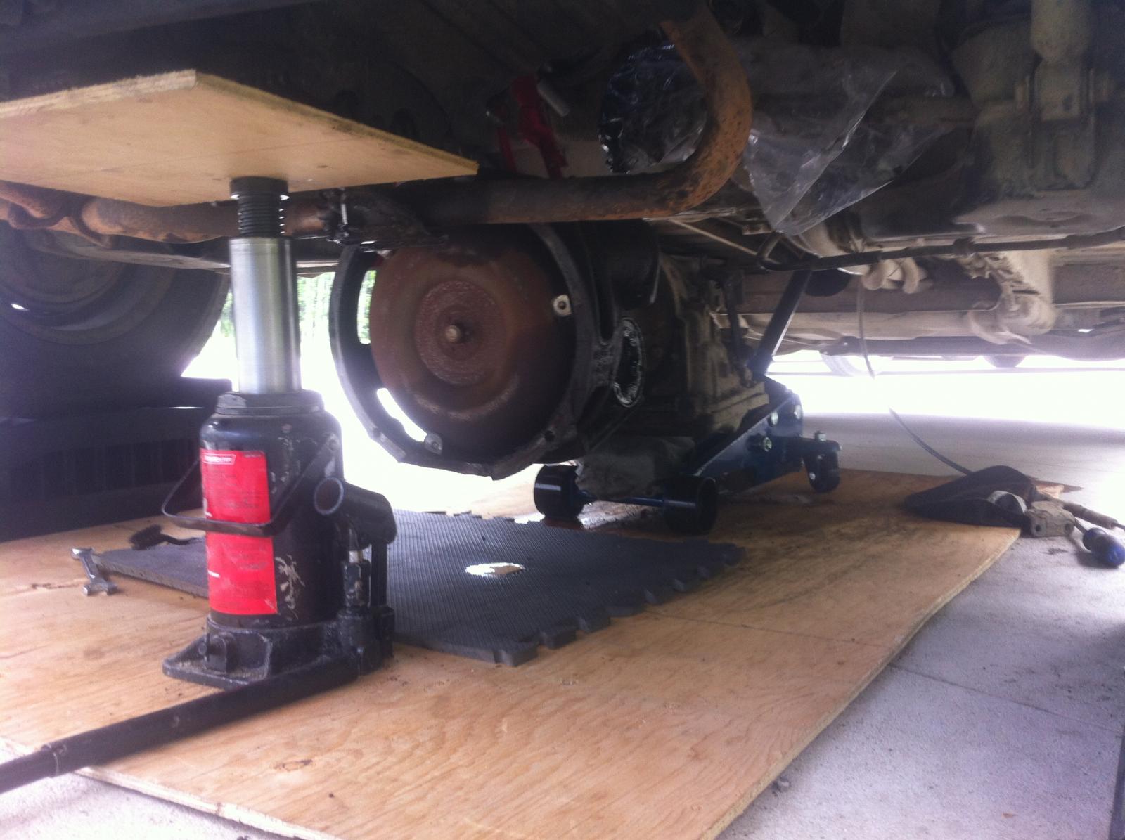

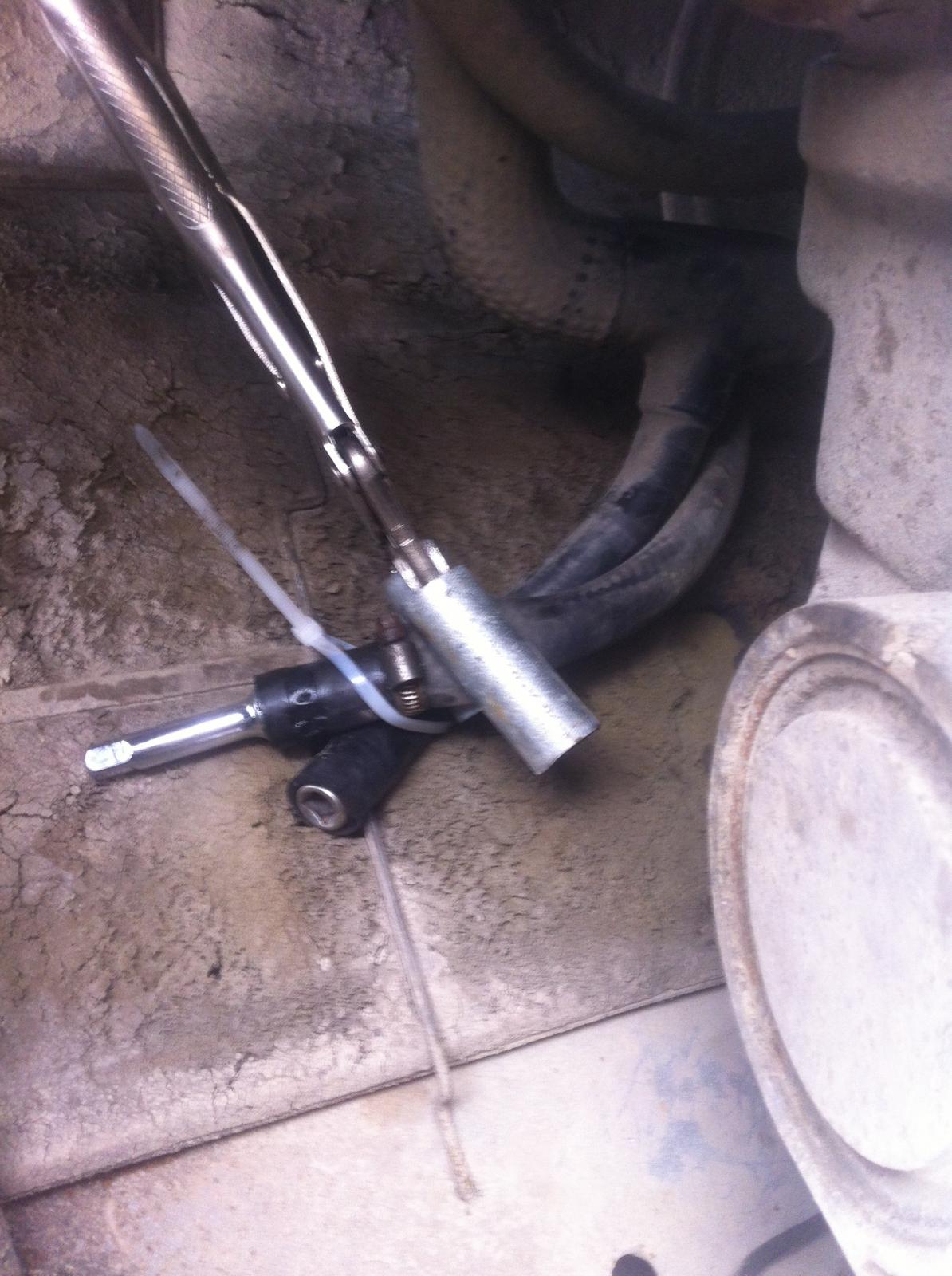

Took me a while to figure out how to get the oil cooler removed; I ended up using vice-grips, some pipe, and then discovered that a 3/8 socket drive made the perfect plug... this was a pain to get to, and I had to drop the front end of the tranny just right to get at both the hoses...
One more shot before the TC came off... Sorry I don't have more shots of the actual removal, but they're out there...

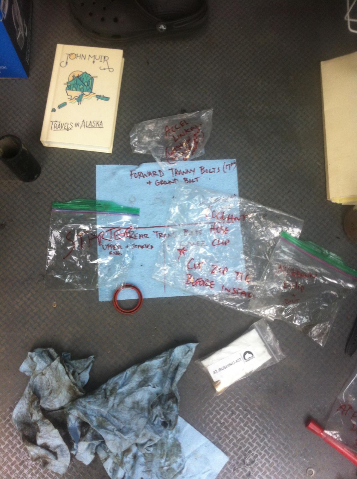

Here's a look at the whole set-up from underneath and this is where I left it to replace the TC - The actual replacement went smooth with a puller, and I used a 2" PVC female to female connector to pound it in, worked great...
this was the only way for my ADD not to totally screw things up...

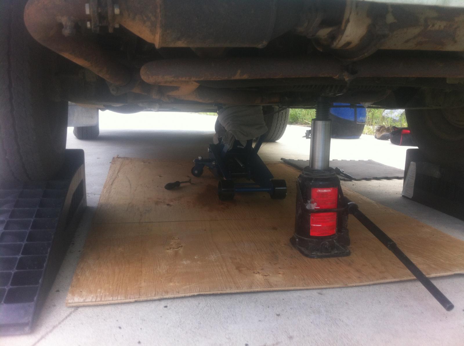

PostPosted: Sat Jun 20, 2020 1:38 pm    Post subject: Re: 1rst time auto-tranny drop - Replacing TC seal/bushing Reply with quote
I know this is an older post, but about to do the same thing. In the photos, why is there a jack under the trans if the wench is doing the same thing from the top? insurance? Could I accomplish the same thing just using a jack and no wench? likely harder to get it out from under the van that way.
ALIKA T3
Joined: July 30, 2009
Posts: 7263
ALIKA T3 is offline
PostPosted: Sat Jun 20, 2020 3:31 pm    Post subject: Re: 1rst time auto-tranny drop - Replacing TC seal/bushing Reply with quote
Physics. If it's only held by one end, it ain't gonna stay flat....

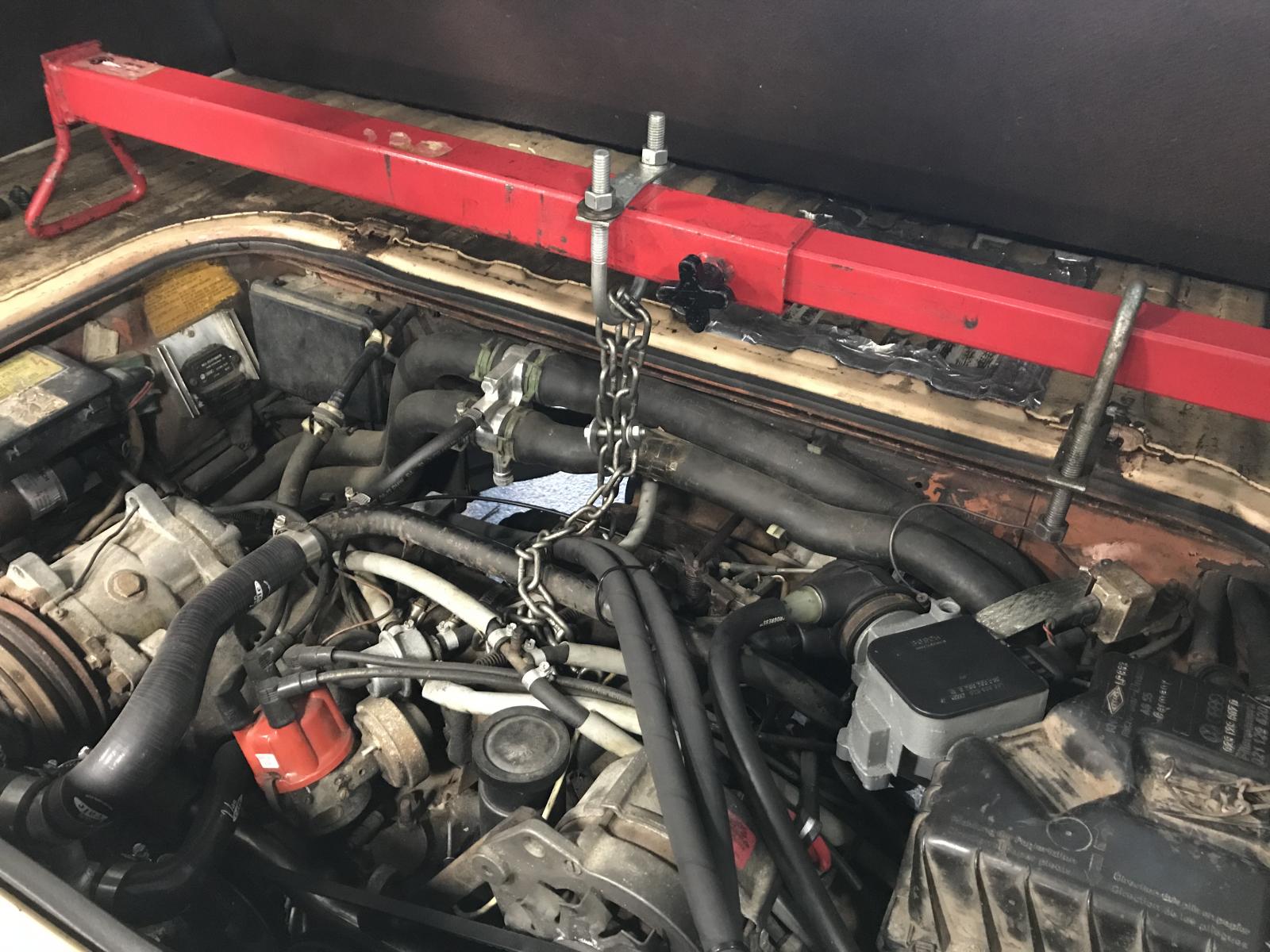

PostPosted: Sat Jun 20, 2020 4:03 pm    Post subject: Re: 1rst time auto-tranny drop - Replacing TC seal/bushing Reply with quote
This is how I supported the Engine from above while working the transaxle underneath.

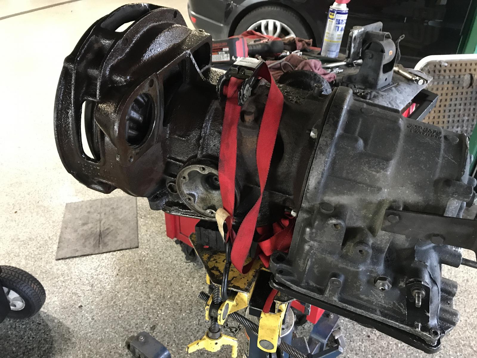

PostPosted: Sat Jun 20, 2020 4:08 pm    Post subject: Re: 1rst time auto-tranny drop - Replacing TC seal/bushing Reply with quote
Simple, rough reference of when your Torque Converter is fully installed/seated - Use a bar across the face of the transaxle to check the depth of the TC.
It’s only a few millimeters shy of the transaxle face/edge, .
The torque Converter bolts are flanged hex head , 8mm x10mm long. 10.9 or better grade .
I bought a bag full from McMaster Carr, Van Cafe was out of stock when I was ordering my Torque Converter Seals and Rear Main Seals.
‘84 Tin Top - Hilga....Auto

The Jack is to support the back end of of the transaxle which is mounted to the frame while the winch allows a nice controlled lowering of the from end (or back end I guess, ha)- replacing those hex bolts is a great idea, I did not and am afraid for my sanity the next time I have to back them out... good luck!
