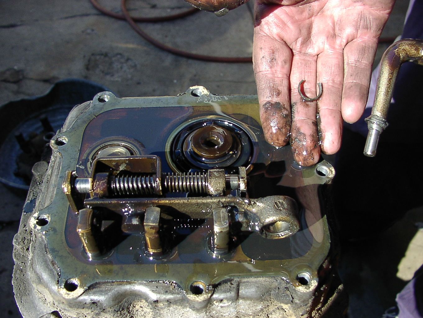

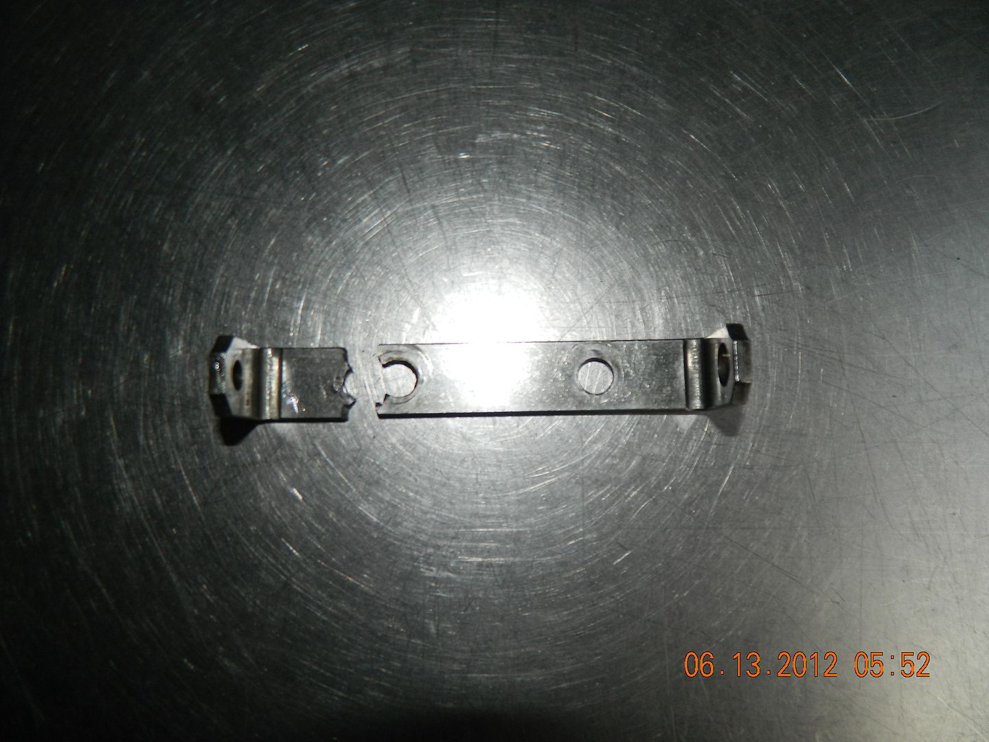

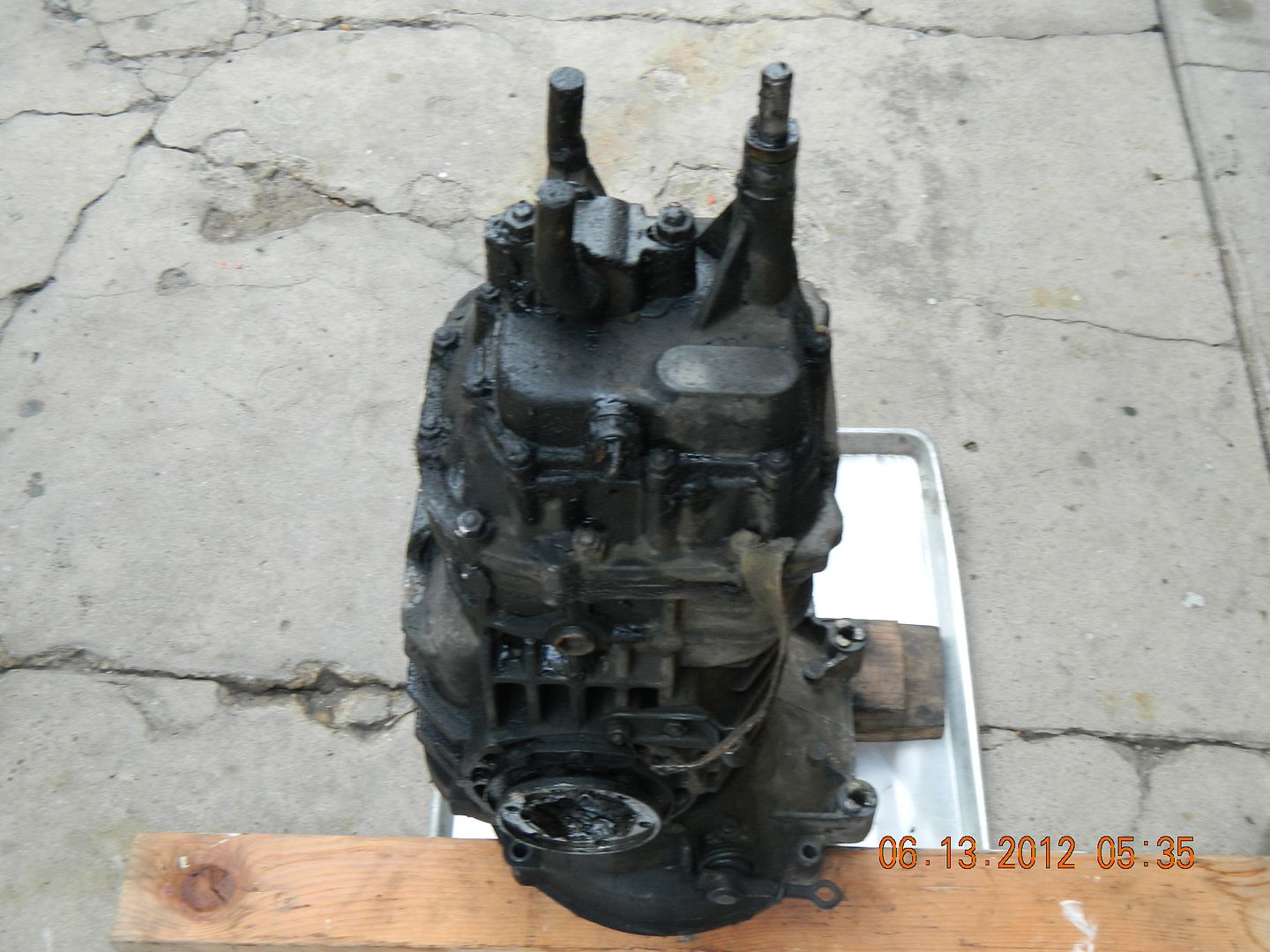

I've repaired about three transmissions where things went wrong in the nose cone. Here's a 1974 where the bracket broke and was welded
Nose cone
Broken bracket
Here's a different bus where the plastic ball wore out
New metal ball $10
Here's a different bus that has a worn ball. It was having shifting problems

It did ended up being the intermediate shift lever bracket that was broken.
