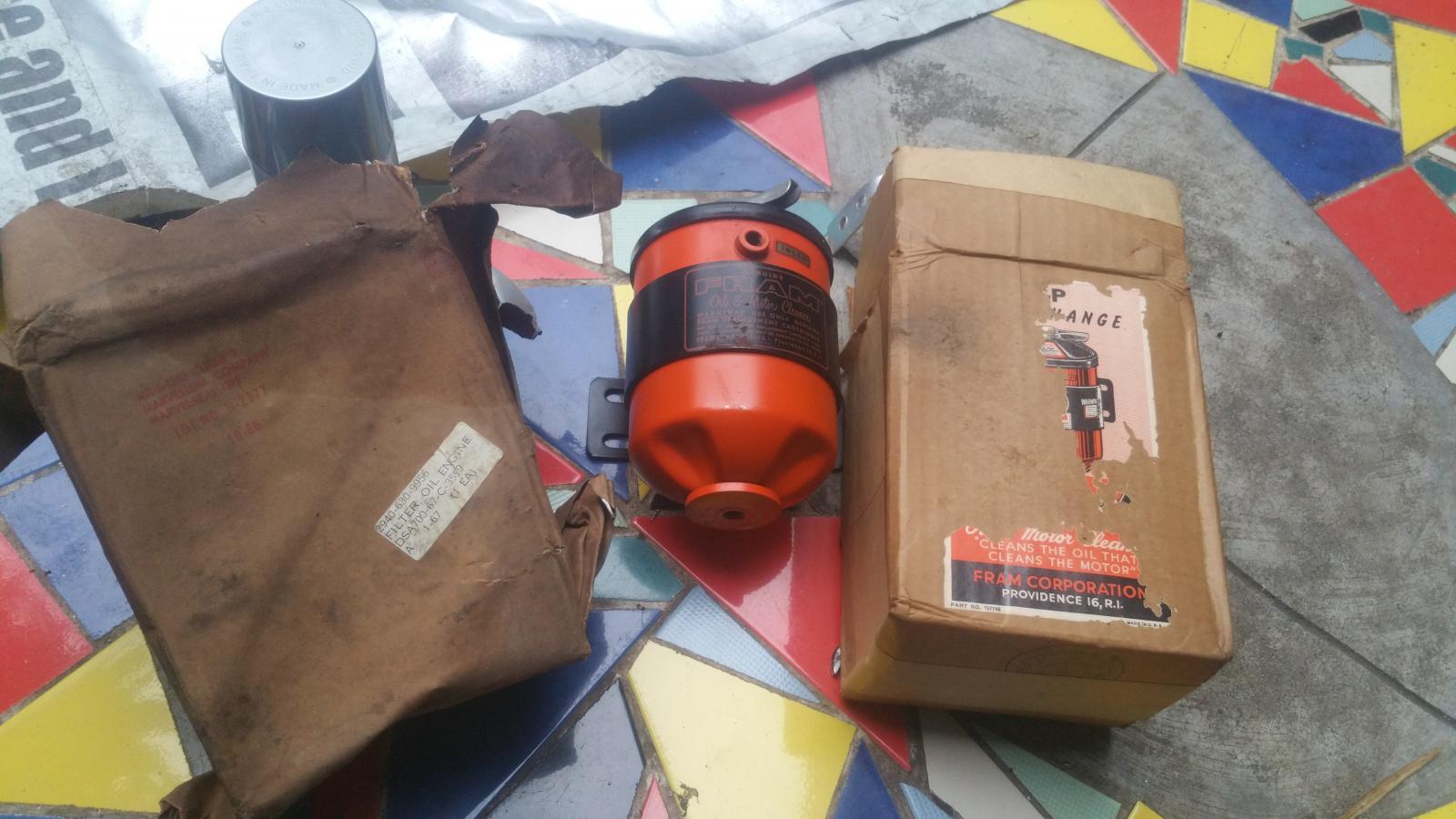

I recently overhauled the engine of Mickey and it proved that the engine had about two loose lower head studs that was causing some unexplained noise. Luckily, the engine was still in good shape. I also installed a vintage Kadron Dual Carbs. With some application of flat black paint ont he engine tins, it looks neat and clean. Mickey has a 1776 cc engine.
But I was thinking of using the bigger one for extra oil capacity.
This was the NOS Fram Filter that I just opened.
After opening the NOS Fram Filter, a NOS instructional manual appeared.

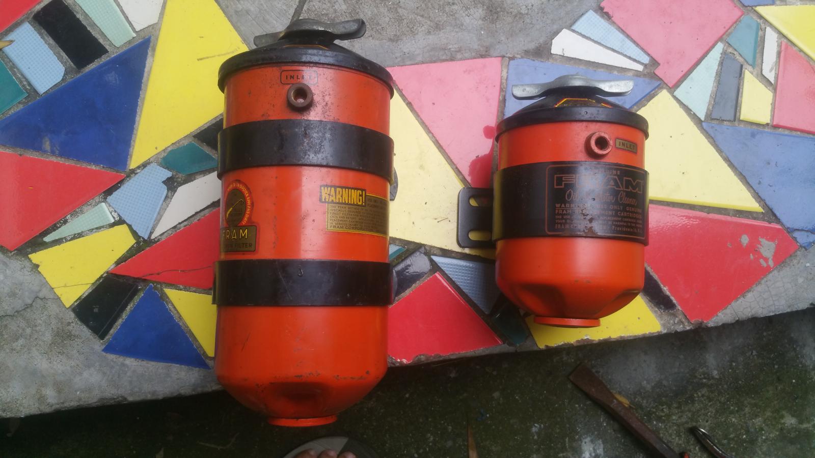

I also installed an external NOS Fram oil filter. At first I used my extra small canister.
But, later on, I installed this bigger Fram Filter. So also, the hose I first bought were old and they blew off. Hence, I went to the hydraulic machine shop and asked then to make me a new steel braided high-pressure hoses that worked pretty well.
But, then again, after using the small Fram Filter, I tried using the bigger fram filter for extra oil capacity and still checking it if it works well. So far so good, the bigger Fram works perfectly and I am opting to have it permanently installed with some new brackets to be made later on.
