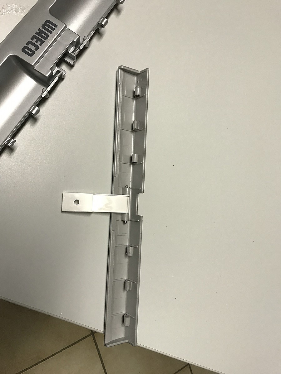

I started to take the fridge apart for the paint job. Some exterior parts and the door latch are held by some screws. The rest I intended to cover and paint.
As I had all the exterior parts removed and the old RM184 fridge already out, I thought I might have a look how the fridge fits inside the Westfalia cabinet.

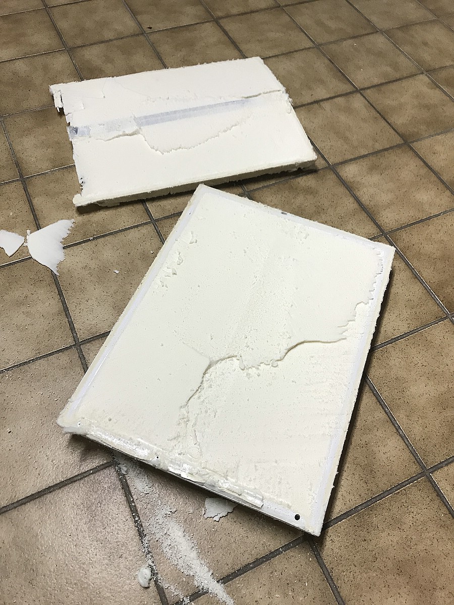

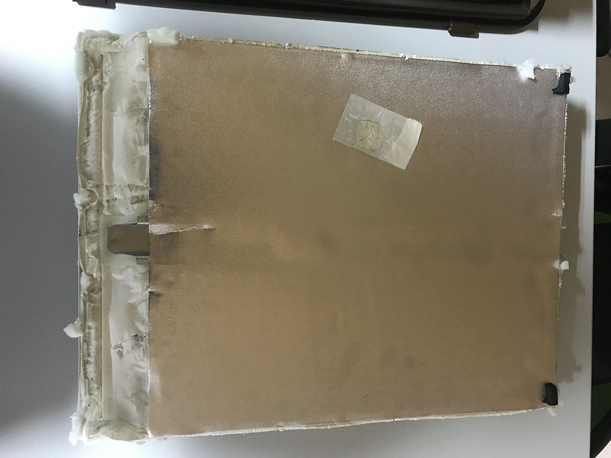

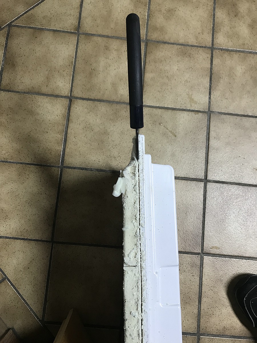

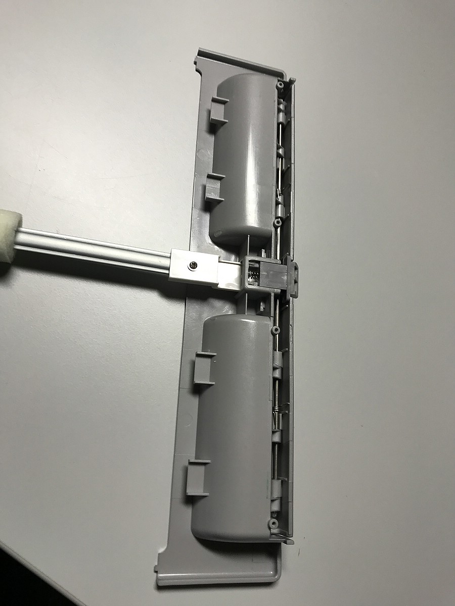

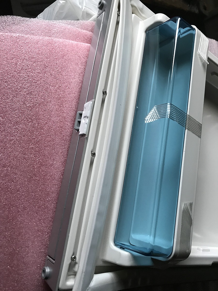

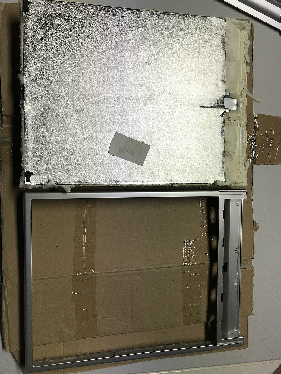

So I took the door apart a bit further:
The frame is held in with some screws behind the seal and some hot glue, nothing that a sharp knife couldn't solve...
Then I cut the insulation that extended behind the plastic part of the door, which left the plastic part of the door with the
inner insulation:
I know there will be some loss due to the missing insulation, but a part will be gained again from the wood of the Westfalia door.

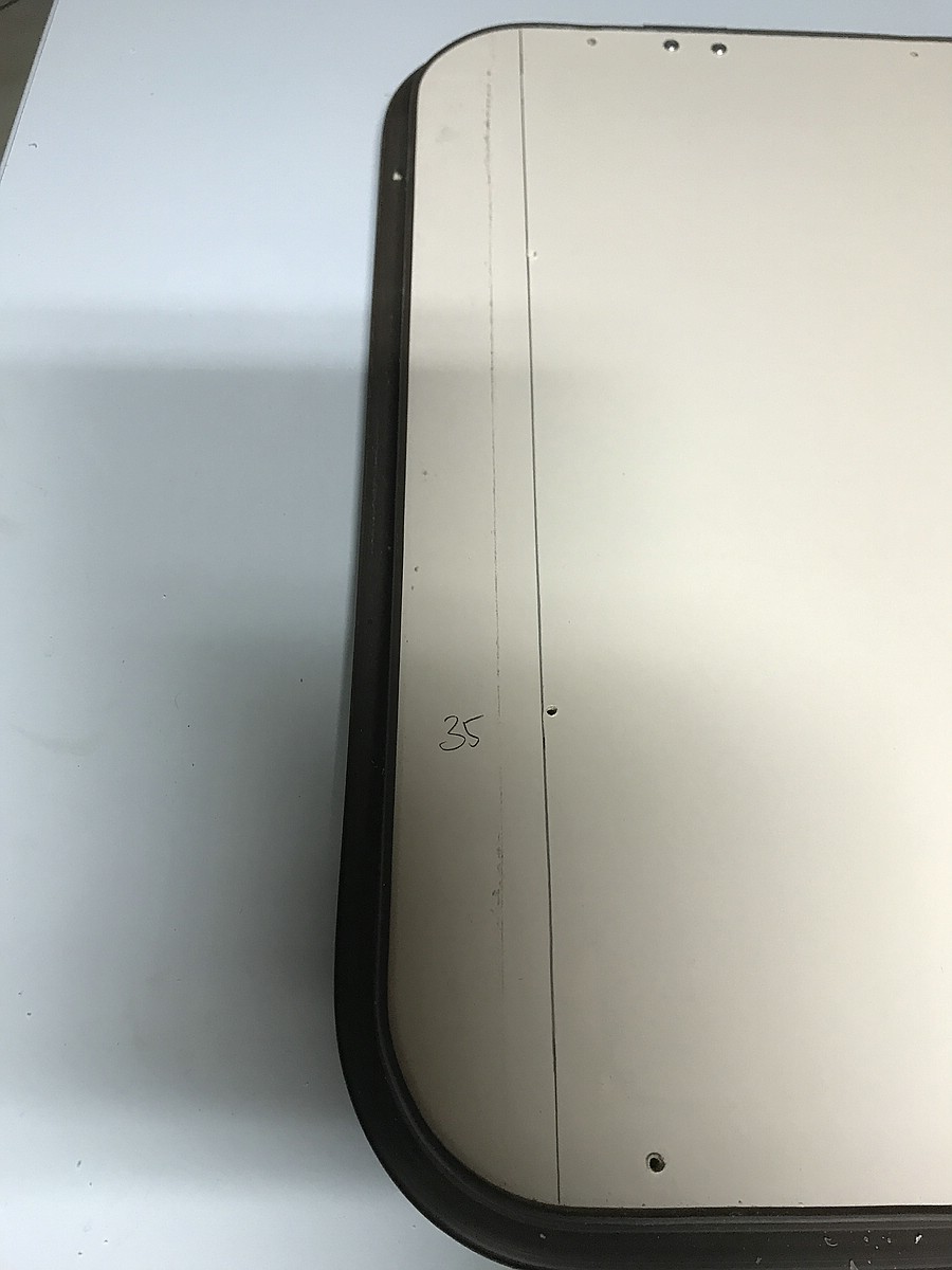

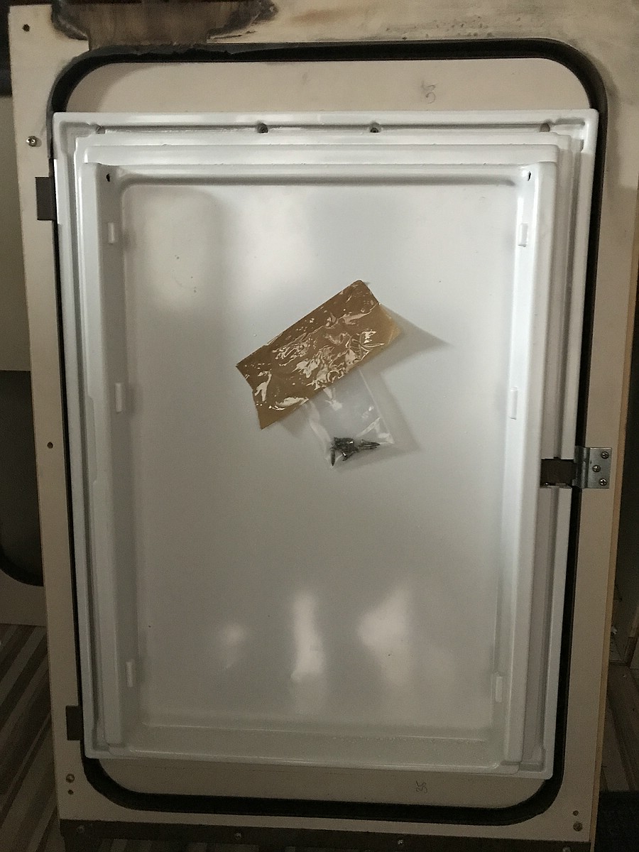

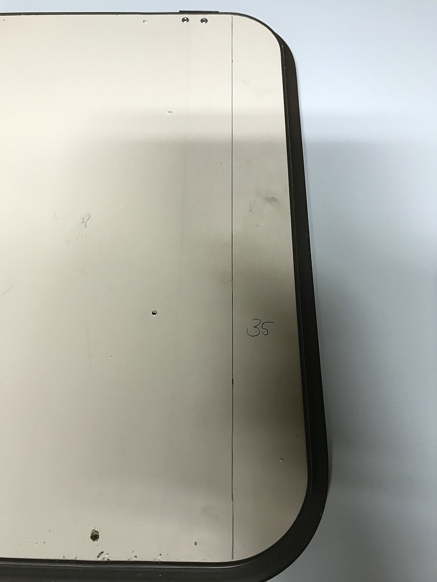

Then I measured and marked the height of the CRX50 door on the cabinet door:
35mm on both sides
Screwd to the cabinet door loosely

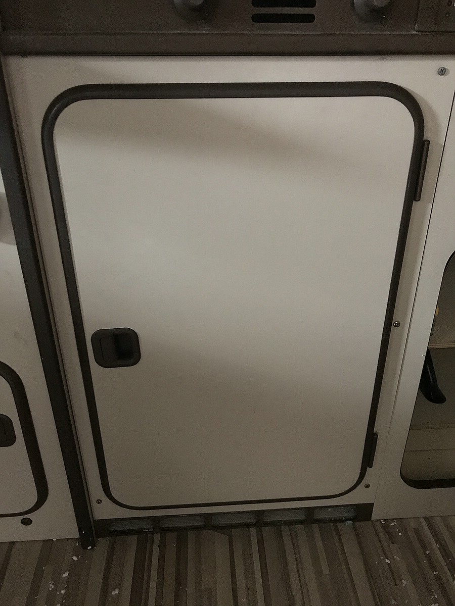

Compared to the old door:
Via trial end error I found the correct horizontal alignement. (Same as in the Samba-thread above - some mm to the font of the car.)

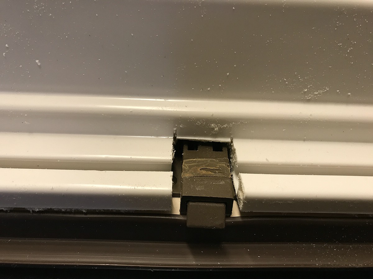

The fridge door must sit aligned with the inner corner of the cabinet door at the hinge side, so it's 2-3 mm over the corner of the font door side.
Had to cut out some at the cabinet door latch (The seal just slides out)
Fits.

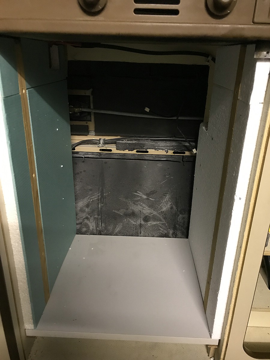

Now I made a liitle board to set the fridge on. (The rubber feet are ~2cm high)
Took some time to get the correct height, so that fridge an door are aligned well.
I had to cut out the thin back plate behind the kitchen at the upper right corner just a tad...

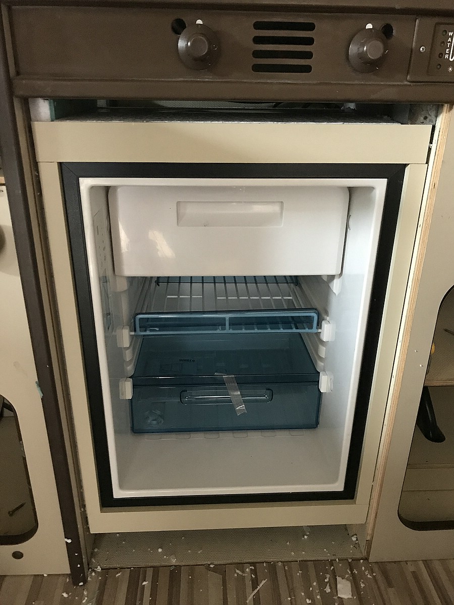

Everything aligned well - as you can see, the fridge sits a little to the front of the car.

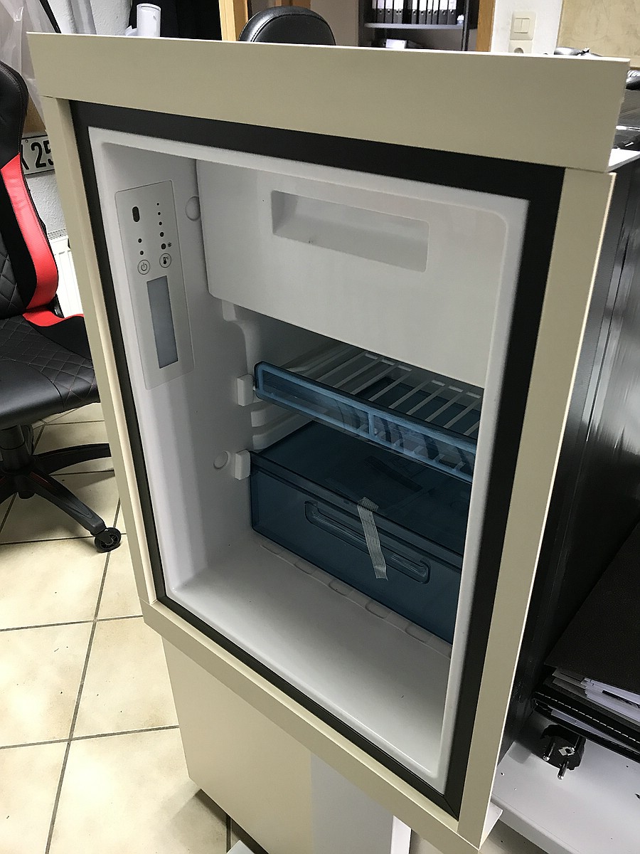

Now there was a little hole at the bottow and the top and smaller at the sides of the fridge to the cabinet.
I bought some L-shaped aluminium at the local home depot (like) store (top and bottom 40/40/4mm, sides 20/40/4mm) and made a frame
attached to the original frame and door mounting points of the fridge.
I wrapped the aluminium frame with the adhesive wrap - see above:
The frame has to sit exactly 1cm in front of the fridges edge - that way the seal to the door is perfect.
The rubber seal has a magnet inside - that way it holds to the fridge very good.
I put some more insulation to the sides (left side 25mm, right side 20mm, bottom 20mm (removed the rubber feet), top 40mm.
I also put some wood bars to the sides of the cabinet at the points where the fridge gets screwed on.

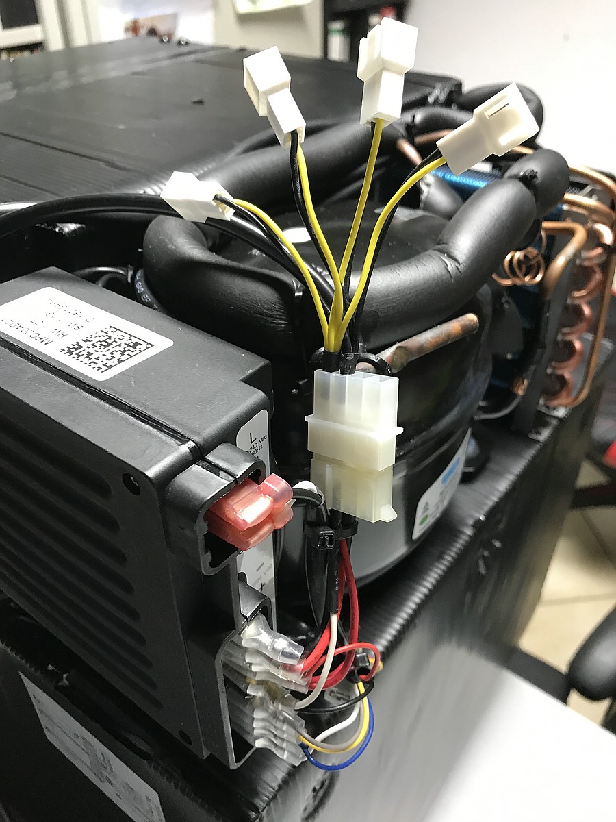

In a previous attempt to get my RM184EGI to cool correctly I put two comupter fans behind the vent at the kitchen side of the van.
I wired some commentors for them to the fan wiring of the CRX50, so the hot air gets sucked out of the van, as soon as the fridge fan ist running.

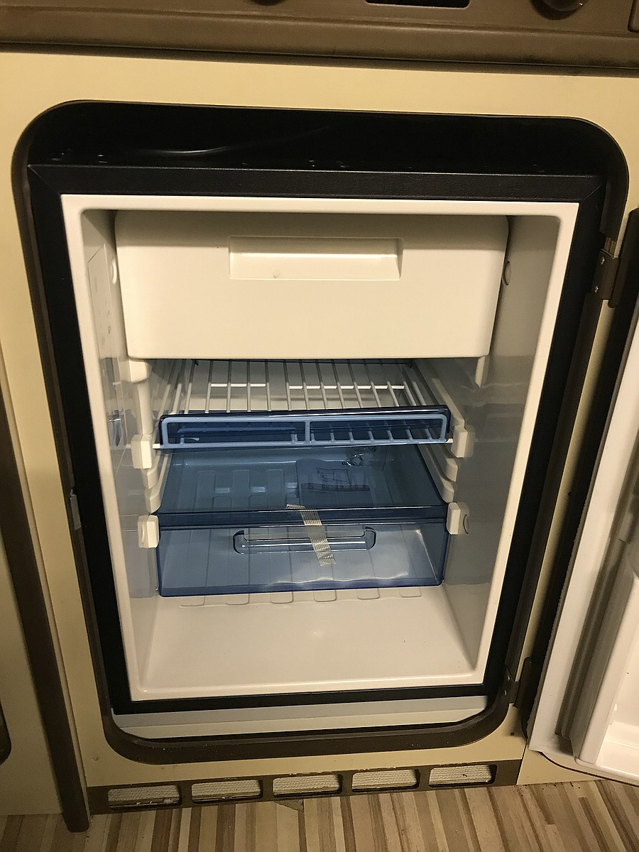

Now- put the fridge in...

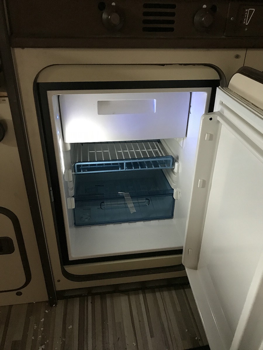

Attach door:
Fits and runs:
With the Westfalia I already had the 230V wiring in the car - for the 12V part I ordered some 3-way FastOn connectors (like the original fridge has) and connected it to the original 12V connector. (the always hot part)
So in the end I got what I want - a nice compressor fridge with the OEM Westfalia looks...

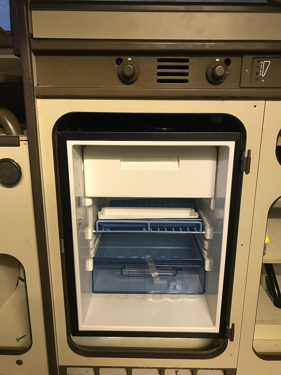

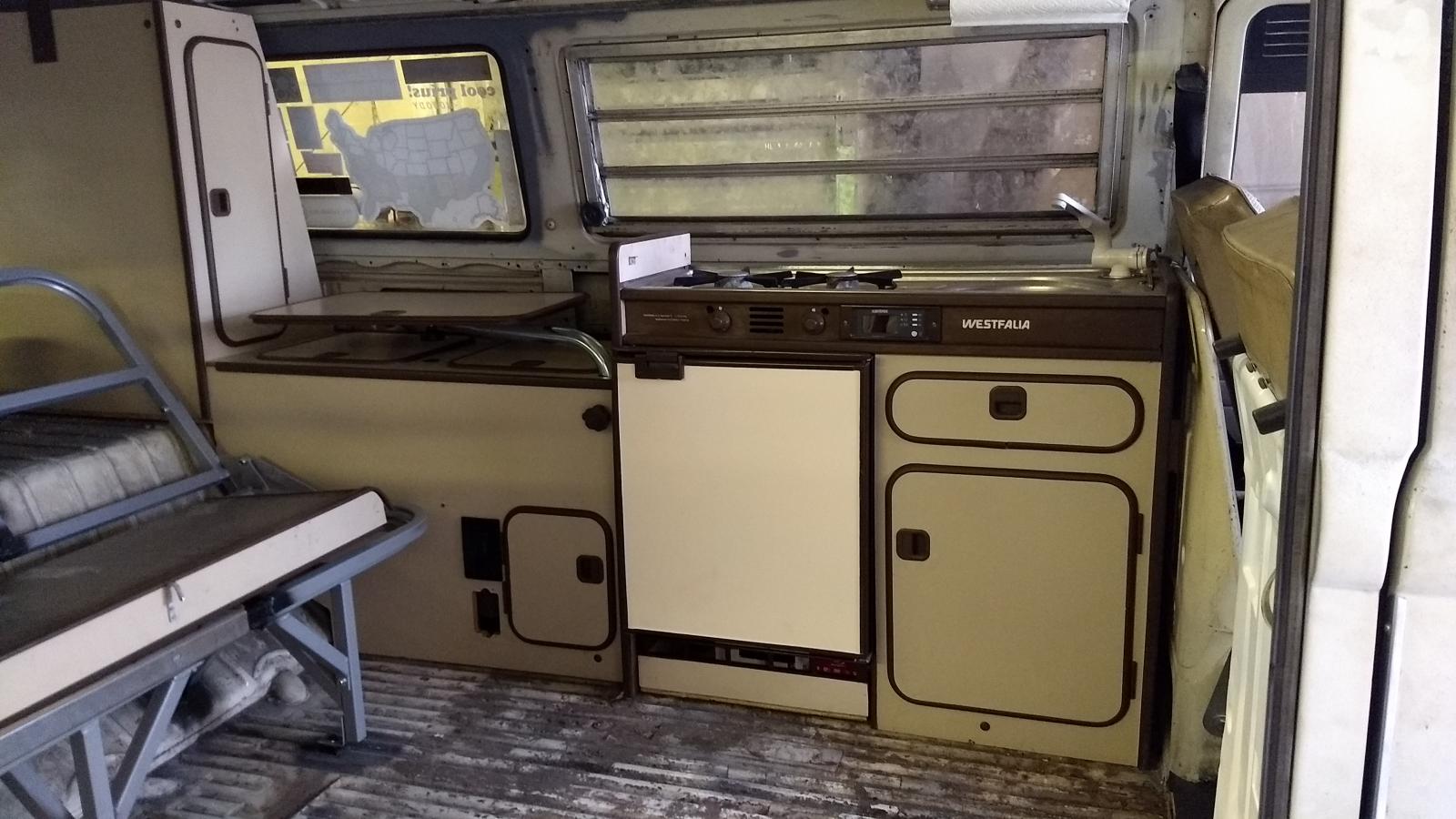

Here is my Dometic CRX-50 swap.
Just need to fix the bottom frame.
Photoshopped to westfalia colors.
