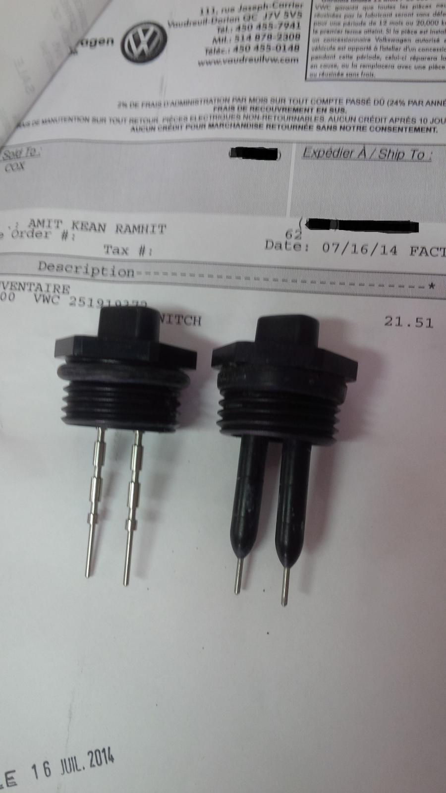

PostPosted: Thu Jul 17, 2014 10:41 am    Post subject: Reply with quote
djkeev wrote:
He is how my sensor failed. Original 1986 unit (date molded in).
Coolant seeped up the metal rods via the cracked plastic and oozed out from the top plug.
Dave
I removed my sensor the other day during my system overhaul and found the same thing. Plastic prongs were cracked ( LED blinking until engine warm). I went to the dealer to get a new one and to my surprise thankfully VW has redesigned the sensor now. It no longer has plastic surrounds on the prongs! Have a look (old vs new picture), its a really nice quality part now. Hopefully it works as well as it looks!

PostPosted: Thu Aug 18, 2016 10:02 am    Post subject: Re: coolant level sensor? Reply with quote
I was just looking at my old sensor compared to the new one pictured above. I noticed when I pulled my off that I have no O-Ring. Are the older ones without O-ring?
Also, any tips on the correct tool to use to remove/install this sensor?

PostPosted: Thu Aug 18, 2016 7:34 pm    Post subject: Re: coolant level sensor? Reply with quote
Man o Man....I can't believe I wrote that prev post. In fact I do have an ORing on there- It's just smashed flat after all these years.
Anyhow....replaced with a new sensor today and no more seeeeeep.
