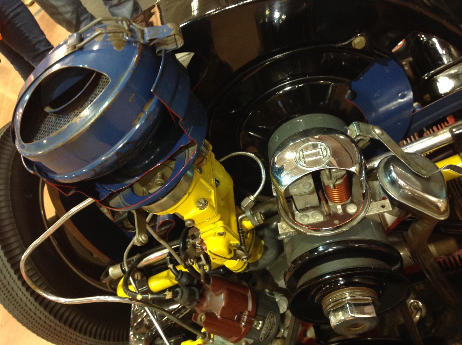

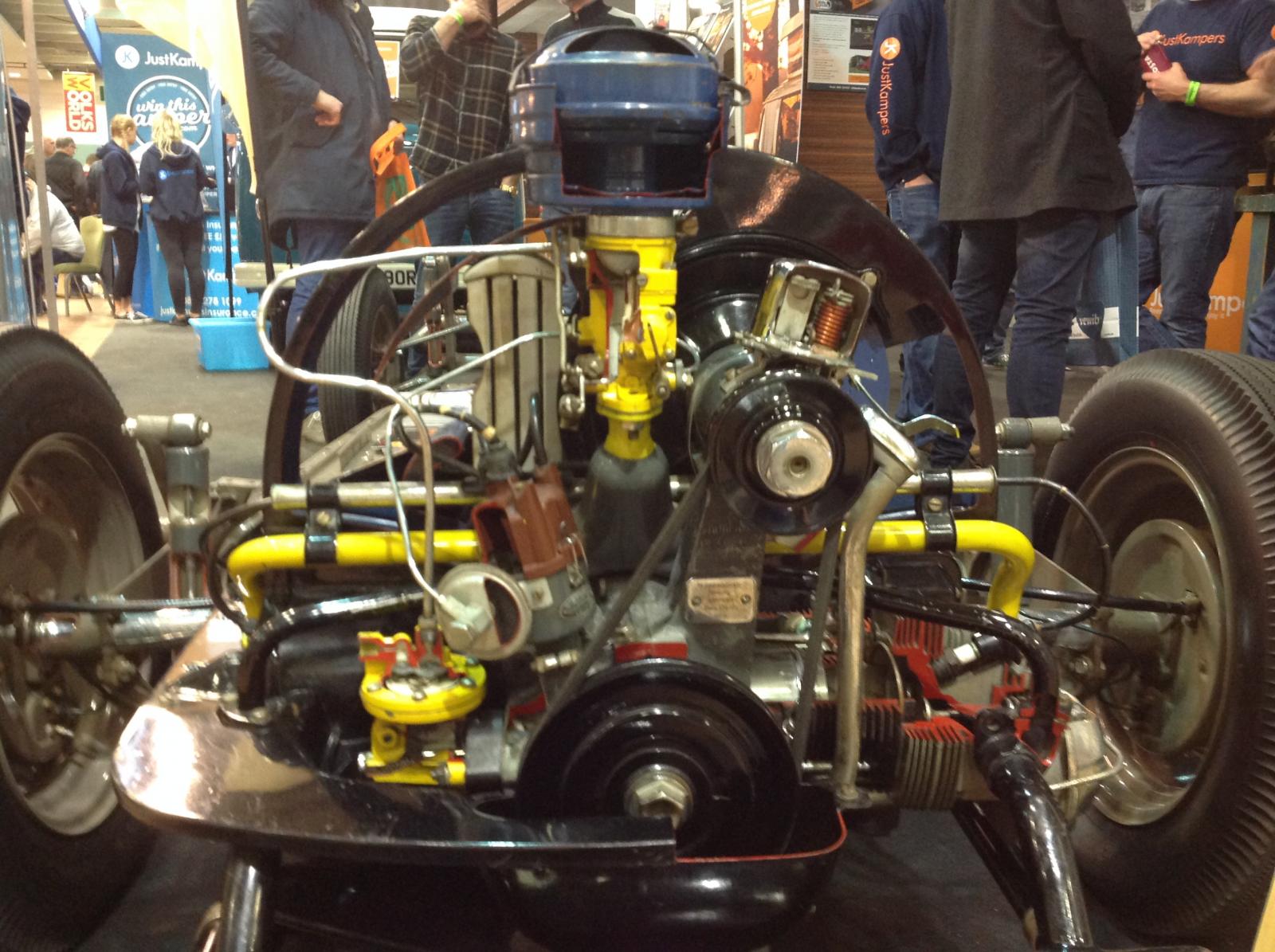

RockStock
Joined: November 26, 2004
Posts: 4209
Location: England
RockStock is offline
PostPosted: Mon Mar 26, 2018 3:42 pm    Post subject: Re: 1954 & 1955 engines whats not correct! Reply with quote
Right, pull it apart lads!
(note regulator lhs reverse screws...cool detail)
-StockRocks-

Posts: 71434
PostPosted: Mon Mar 26, 2018 11:13 pm    Post subject: Re: 1954 & 1955 engines whats not correct! Reply with quote
The engine above looks like a '54 engine but it has a '53 air cleaner and oil filler.
Maybe left-over parts they used for cutaway purposes?
A lot of the colors are wrong. Smile

56samba
Joined: June 25, 2015
Posts: 274
Location: Germany
56samba is offline
PostPosted: Thu Mar 29, 2018 6:49 am    Post subject: Re: 1954 & 1955 engines whats not correct! Reply with quote
In my opinion, they used some left-over parts to build these cutaway engines. There was a very similar chassis for sale in Germany (but I doubt it's the same), it also had the uterus manifold...
It appeared to be a 25hp engine and they also mixed late 25hp and early 36hp engine parts.
splitjunkie
Joined: April 04, 2006
Posts: 4192
splitjunkie is offline
PostPosted: Thu Mar 29, 2018 7:55 am    Post subject: Re: 1954 & 1955 engines whats not correct! Reply with quote
A lot of these cutaway engines had the Uterus manifold. VW probably had a lot of stock of those since they rotted out from the inside so they put them on the cutaway motors rather than trashing a good one.

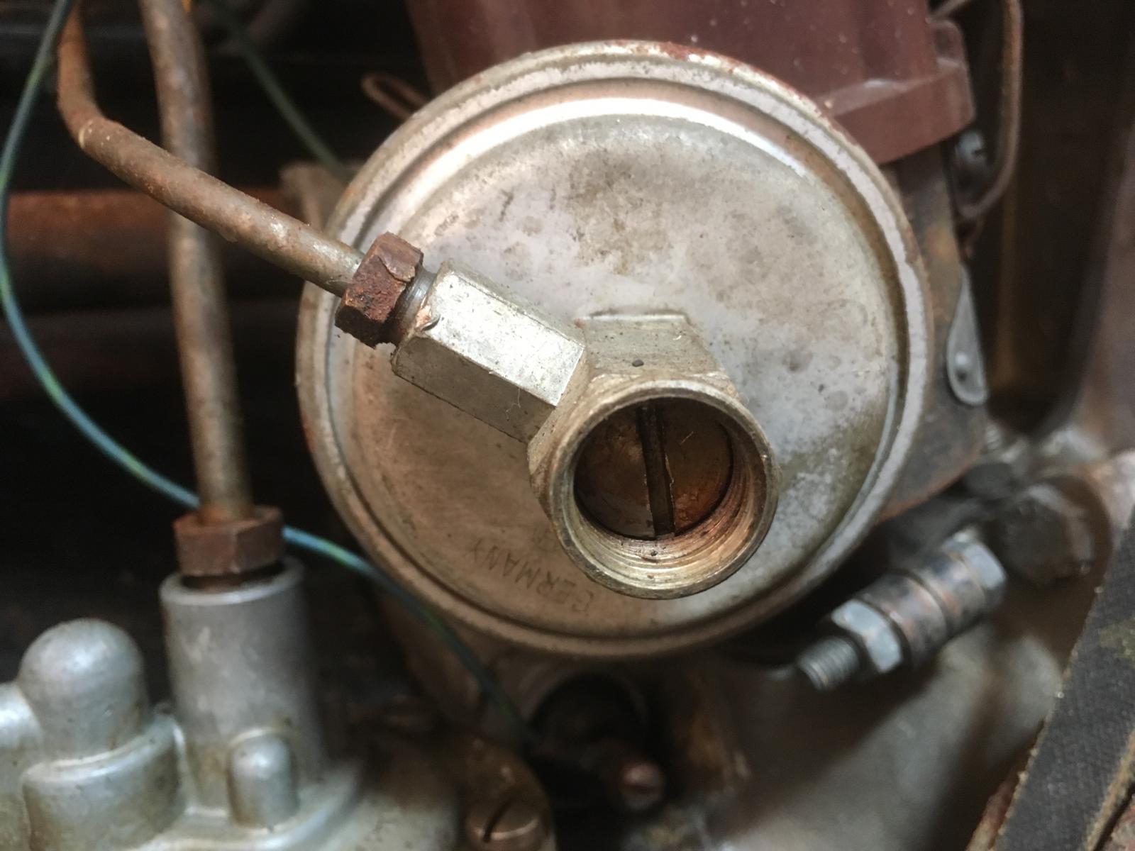

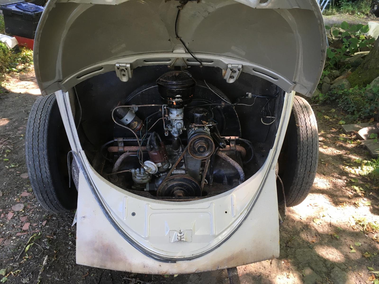

Hi,
I recently bought a Swedish 55 Oval. This is the engine:
The distributor is a Bosch VJU 4 BR 8. The vacuum canister usually looks different to mine. Is it just missing the bolt? What is the screw for?
Also, I have a screw missing from the carb, I think its the venturi locating screw, can anyone confirm?
Thanks, Neil
Posts: 71434
PostPosted: Sun Jun 24, 2018 9:17 am    Post subject: Re: 1954 & 1955 engines whats not correct! Reply with quote
Your engine looks very original to me with all the correct parts.
Yes, the bolt is missing. The screw is for adjustment. I've never used it myself.
Yes, there is a screw there. I found this photo:
mabbo
Joined: October 13, 2004
Posts: 216
Location: United Kingdom
mabbo is offline
PostPosted: Sun Jun 24, 2018 10:59 am    Post subject: Re: 1954 & 1955 engines whats not correct! Reply with quote
Thanks for the reply EverettB
Do you know if either will affect running?
I have a couple of later 40hp engines spare. Not sure if if the carbs are identical. Ill have to dig them out and have a look.
Cheers
Posts: 71434
PostPosted: Sun Jun 24, 2018 5:43 pm    Post subject: Re: 1954 & 1955 engines whats not correct! Reply with quote
I am making a guess but I would say both will affect it from running correctly.
The bolt on the distributor has a metal washer so I think this acts a seal and it may not advance correctly.
The screw in the carburetor I am sure needs to be there for proper running.
