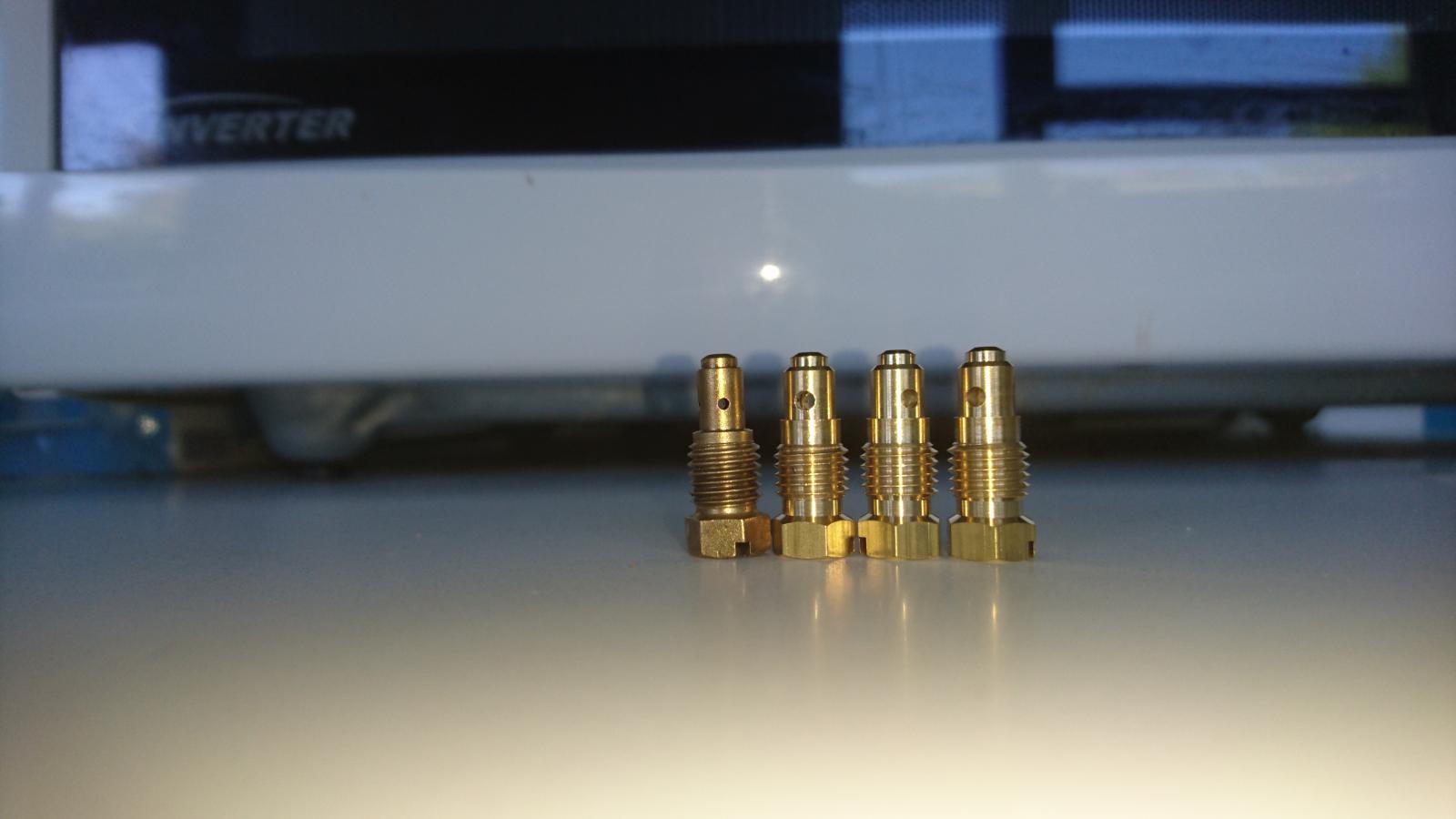

I also had a look at the end of the idle jet. It looks OK, as does the seat, but I noticed that the shape of the jet body and size of the holes are very different from the jets that I've bought here. I ordered 2060 jets in 57.5, 60 and 65 sizes to try, but haven't fitted them because they're so different to the g55 jet that is in the carb now. The hole sizes around the sides are much larger, they have a 'shoulder' in a different position and the ball bearing inside each jet is much further down. The jet that I took out is labelled SOLEX. The new ones are labelled RCA.
I've attached photos below - the jet from my carb is on the left in both pictures.
Have I bought or been sent the wrong jets, or are these interchangeable?

Idle jets from different manufacturers will rarely be identical. No way to tell how they actually function just by looking.

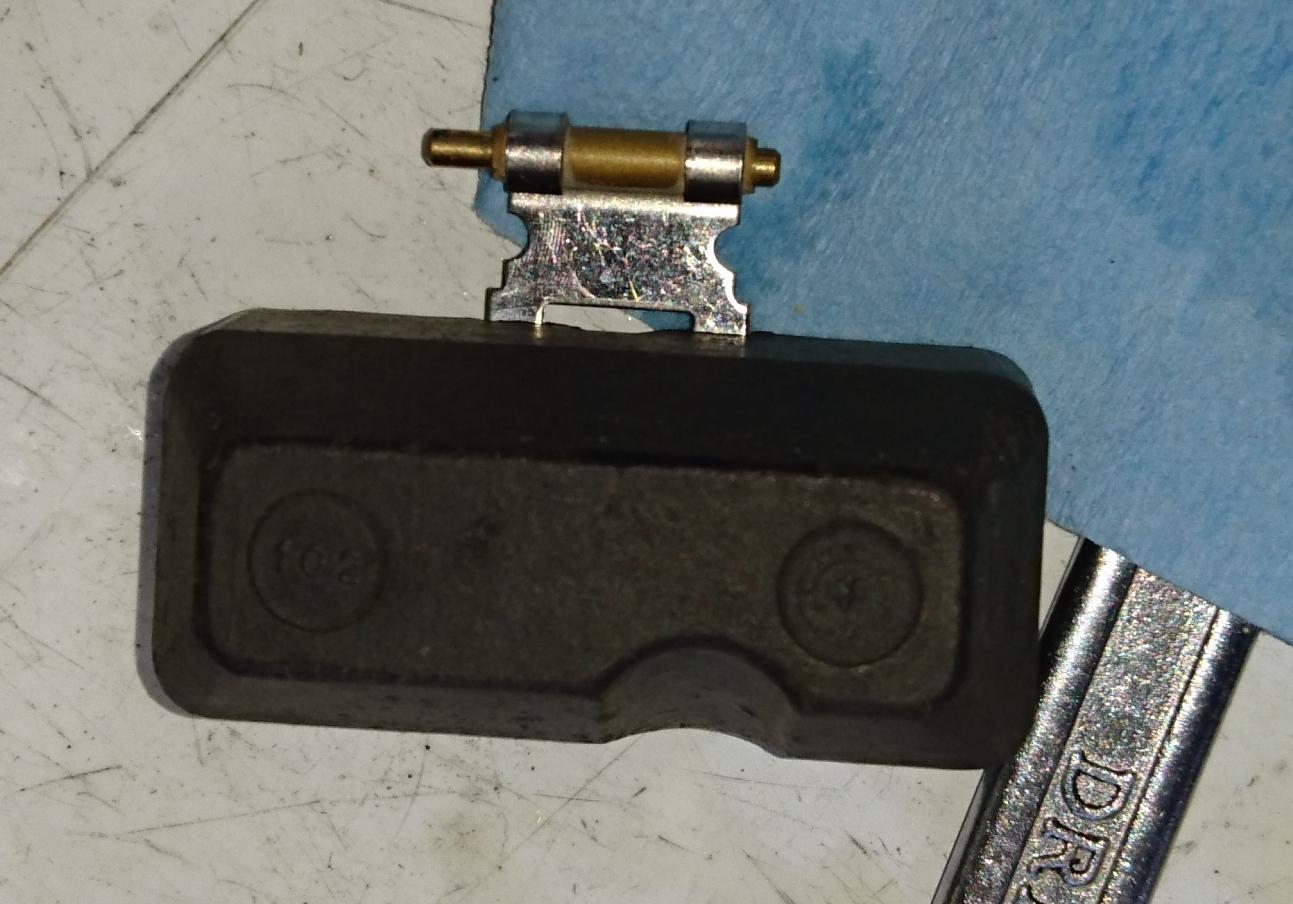

I think I may have found the reason for the low level though. I thought I had a normal float, but after reading this thread...
https://www.thesamba.com/vw/forum/viewtopic.php?t=573583&start=0
... I realised that I had a solid foam float. I swapped it for a hollow one from my old Bocar carb and with that and the slightly thicker gasket that came with the rebuild kit, the fuel level came out at 19.25mm with the washer that was already in the carb.
I'm hoping that will help with the apparent lean condition. I'm going to try tuning it again at the weekend. If it's still not idling properly I'll also change up the idle jet.
This was the rig I made to test the float...
And this was the float that I changed out...
I never knew that solid floats existed. It sounded hollow when I tapped it. Confused

SGKent wrote:
normally a saturated float will cause a higher bowl fuel level.
I see what you mean.
Either way, switching it for the hollow float seems to have done the job.
I was surprised that there was already a spot worn on in to the metal arm on the old float from where the valve made contact. The running issues mean that I haven't put many miles on the truck.
Andy

Did you try the new idle jets you purchased? Even though they look different to your original they are the same. Your original .55 may have been reamed out too big, try the 57.5 that should work.
