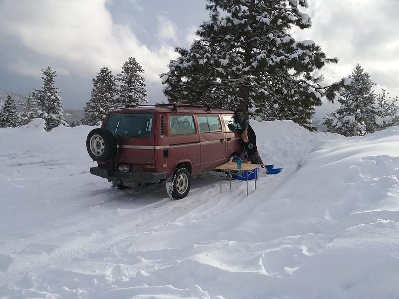

I finally decided to create a thread about my Vanagon.
Here is a ten year old pic from back when I was pushing the limits and learning the van. I baby it a lot more now. That pic is on the way to my friends cabin at War Eagle mountain above Silver City. I plan to put a Westy top and kitchen in it. My wife and I go camping a lot so I'm working on making it as reliable as possible and setup for our needs.
The basic rundown as it is now;
87 Tintop Syncro non locker (plan to add peloquin dif upon trans rebuild)
I have a RJE 2316cc Rocky Jennings custom engine in it with the Tencent/RJE vacuum switching throttle switch module. AA Trans sport viscous coupler. CLK Alloys, RMW swing away carrier. I'm working on getting all the mechanics fixed up before I tackle the front seam rust and rear 1/4 dent.

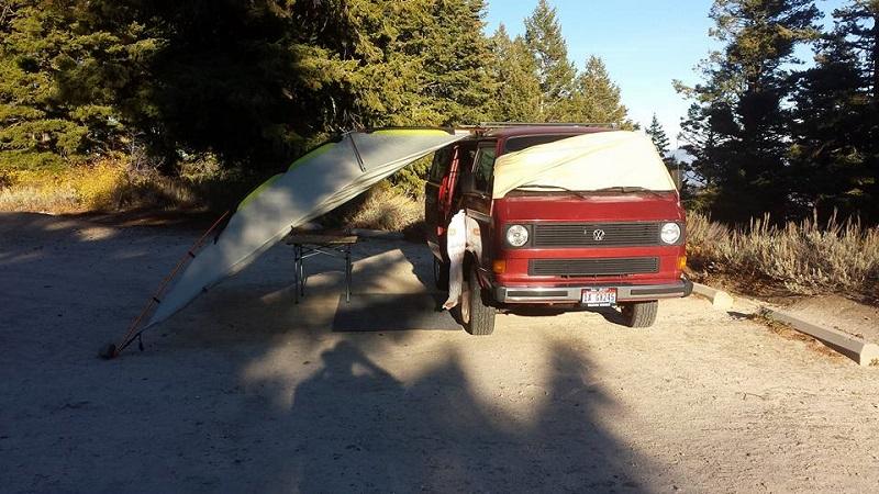

I have a Kelty carport tent. Once setup I can move it easily and put it on the side or back of the van. It takes some time to setup but is nice once up. I want an ARB someday.
Since that pic I have a SA headlight setup and truck mirrors added.

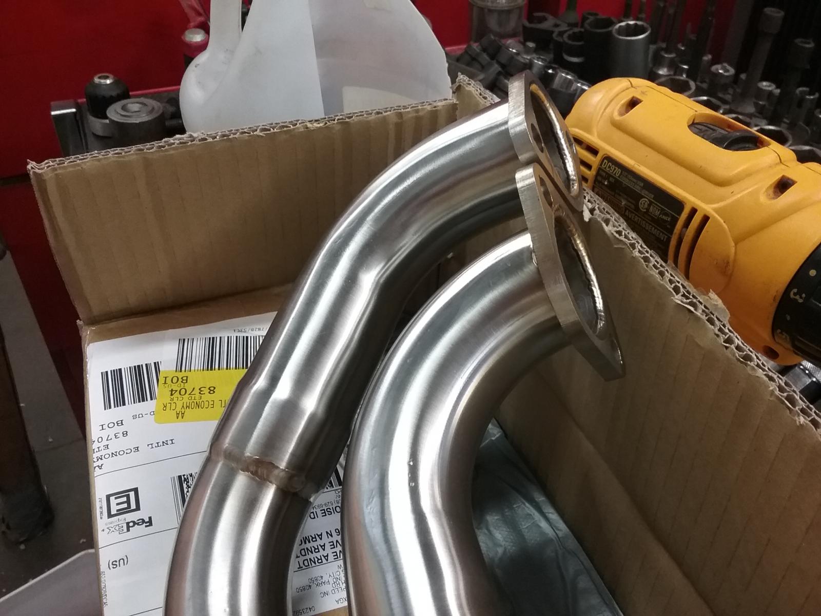

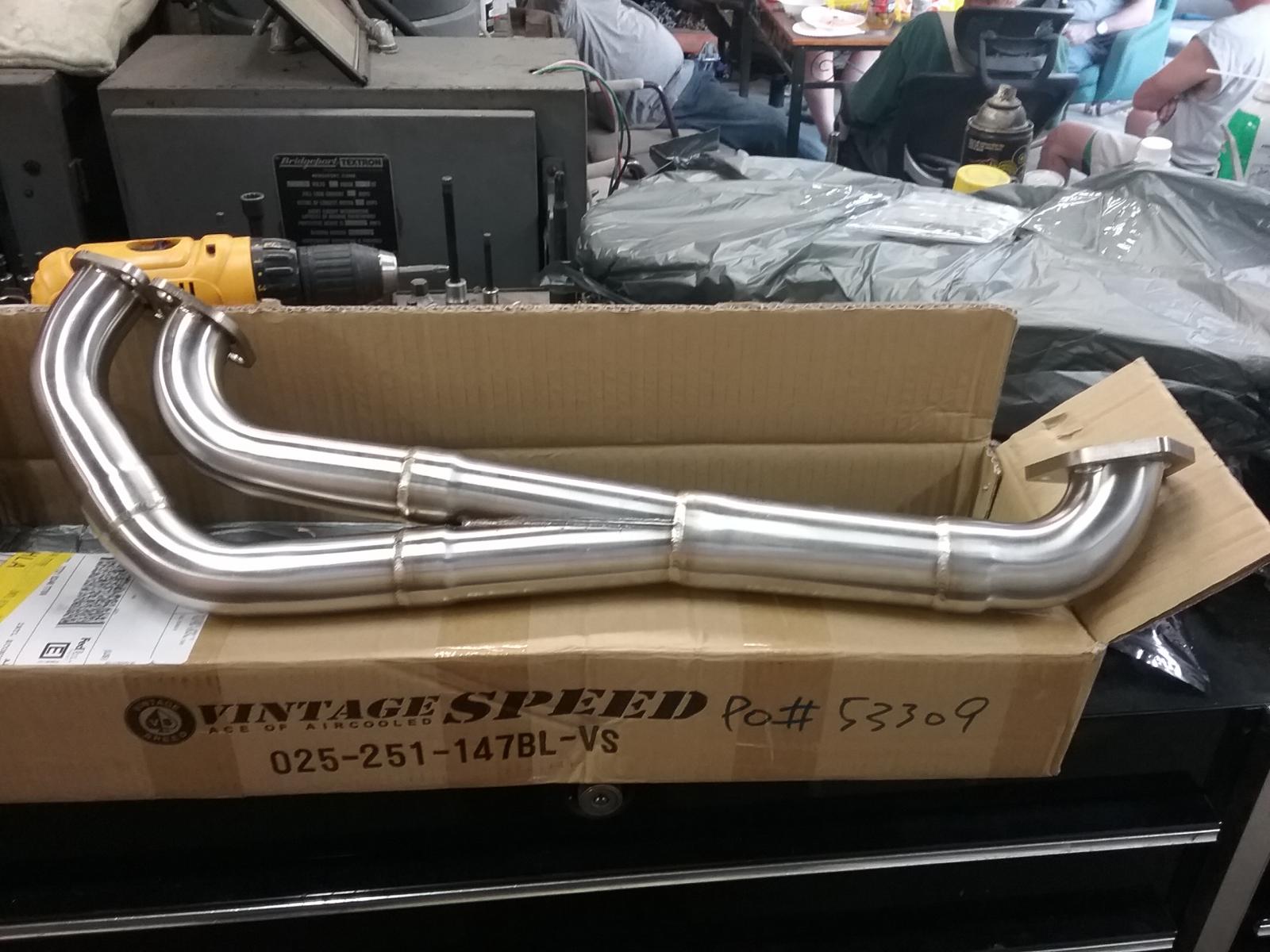

Received the Vintage Speed torque elbow. This replaces the J pipe and 2 into 1 cast merge. Real mandrel bends, perfect tig welds, nice smooth merged design. Should add a couple horsepower across the board. I bought it from aircooled.net they are the biggest vintage speed reseller.

Gees...how much is that pretty lil' thing from Vintage speed?
http://vwparts.aircooled.net/Vintage-Speed-SS-Elbow-To-Cat-025-251-147BL-VS-p/025-251-147bl-vs.htm
https://www.thesamba.com/vw/classifieds/detail.php?id=706872
Here is their advert where I first set eyes on the setup. I didn't buy their muffler system because I already have a high flow 2.25" cat and straight through custom muffler.

Damn, that's a very reasonable price for such an object of beauty!!

Long merge installed.

It looks beautiful, but is there a noticeable performance improvement?
I've been having a b*tch of a time eliminating a tiny exhaust leak at that junction.

PostPosted: Mon May 14, 2018 8:12 am    Post subject: Re: Steve's 87 Syncro project Reply with quote
It has more mid range punch. I've only taken around the block not to my dyno hill or any top end runs yet. It is louder and I can feel more exhaust pulse out the tale pipe. This leads me to think the timing of the exhaust pulses is stronger and better. A try Y 4-2-1 exhaust benefits from long secondaries like this pipe has.

CB ratio rockers, RJE cam. Runs great. I can easily feel a difference in pulling power and acceleration since adding the vintage speed 2 into 1 torque elbow last month. Best 200 bucks I've ever spent from a performance standpoint.
