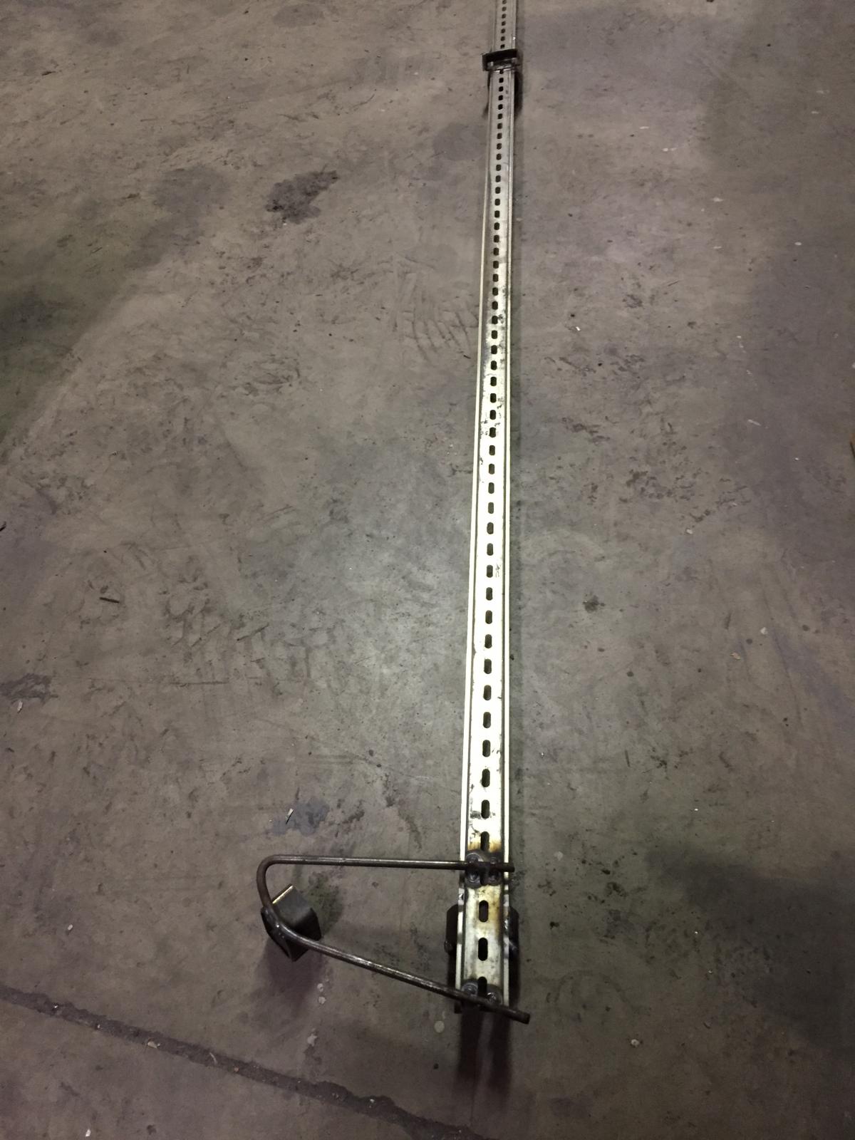

So I messed around with link shins awhile ago. Thus making my front tire point in different directions. In a bad way. So as I am working on this thing not at my place of employment and also alone. So I made a toe gauge. May not be perfect but should be close enough to allow me to drag it into town

That's the best use for DIN rail I've seen yet LOL. I did alignments for a few years using just a scribe and a toe bar on everything from Mercedes for clapped out Ford trucks. IF you know what you're ding it works just fine. I should post some pictures of the tire scribe and toe bar I made for home use.
brad
it was long enough and light. it work well.
a little redneck engineering and things can get done

Toe in setting tip: Magnetic laser level.
1. Remove front wheels and attach level to one of the wheels and set it to 0 degrees.
Note - I used the rear wheels as a non-moving reference - remember to add an offset for the height of the laser level
2. Carefully move the level to the opposite side and measure the toe in/out desired
Note - first time I tried this I used the outside edge of the rear rims - it was a way too much toe in (like 2"!)
Basically I am using the wheel mounting surfaces as a common plane and making toe in adjustments in relation to each tire.
- Jeff

For a "few" dollars more a 2nd later lazer level will minimize the error possibilities that moving the setup side to side invites.
I used 2 from Lowes when squaring the near rear housing on our motorhome. If I can find the picture I'll post it.

The second laser level is a great idea.
