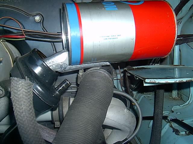

PostPosted: Wed Jun 20, 2018 7:38 am    Post subject: Re: Oil fill Reply with quote
Buy your oil in cans and use the technology the filler was designed for. Razz
Whoa. Never seen that. It makes perfect sense though. I always wondered why it was so hard to get to.
