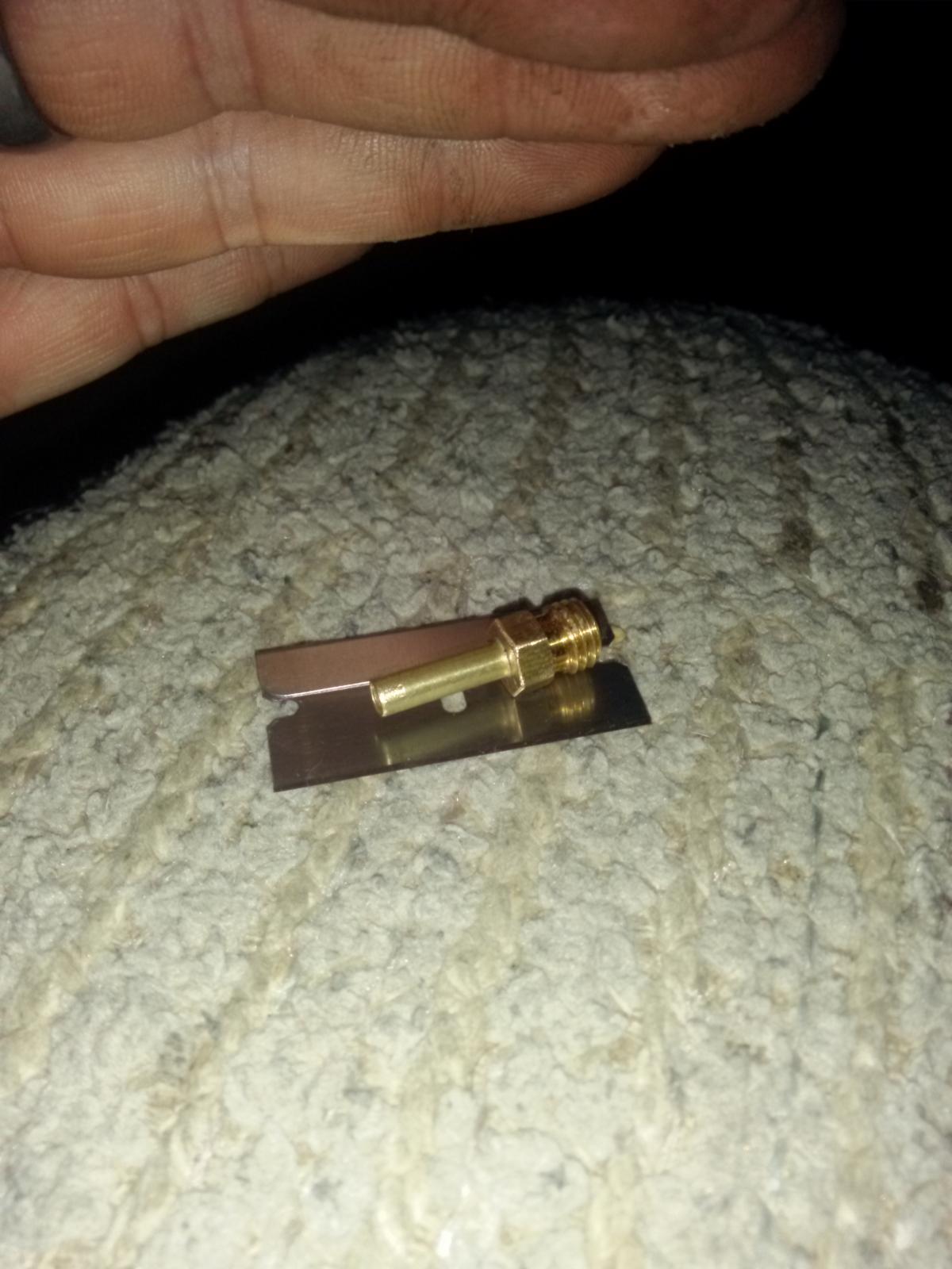

Mondshine, that's exactly the sort of stuff I want to see! Nice Work! Cool way to go if one desires to "update" the parts.
Any details on that vacuum fitting? Looks like a piece of brass tubing in a drilled out pipe plug or similar.
Here's how I made the last few vacuum fittings when I couldn't be arsed to buy the right assemblies. They started out as brass compression fittings. I cut one side off, drilled the center out, and tapped in a piece of brass tubing. Seals with a nylon washer, although a few wraps of teflon tape or even loctite would suffice.
A useful way to go if you have a pile of parts and fittings in "that" drawer in your garage. I've had exactly zero luck finding a basic fitting to screw into these guys that's all ready to go, unless buying the full line for the original application.

PostPosted: Tue Sep 11, 2018 11:17 am    Post subject: Re: VJU 4 BR 8/ 0 231 115 040 Cast Iron SVDA Distributor Reply with quote
The vacuum fitting was just turned from a piece of square stock, with a brass tube pressed in. I suppose I could have just used an M8 bolt.
I knew this would make Glenn cringe!
I do prefer the "one piece" points over the doglegs or other two piece points.
I also prefer the later "pass through" arrangement to the nut and bolt type. The later style "pass through" in its re-located hole, along with the filed notch in the distributor body allows the use of a standard 03-010 cap.
The change to the actuating rod was necessary because the post on the later breaker plate is shorter. Just a quick job with a file.
Did I do this just for the sake of change?
Partially; but it certainly makes tune-up parts easier to get. I am happy to leave the increasingly rare parts to those who insist on absolutely stock builds.
Besides... I'm retired. This is my idea of fun!

The mainshaft, drive dog and weights are the same. The other parts are not.
As to preventing the VJU4BR8 breaker plate from moving with the vacuum canister.... drill a hole through both and use a rivet or small screw to lock them together.
You could also use a non-working vacuum canister to keep it in place. If you need any, I have a few and will send for the cost of shipping.
One of the VJUs the guy has removed the vac canister, plugged the hole, and spot welded the points plate to the plate below. I guess he was making it a VJ4BR8. Would this work? I guess it would be a way of making a budget 019 if it did since VJUBR8s are cheap...

PostPosted: Fri Mar 08, 2019 9:38 pm    Post subject: Re: VJU 4 BR 8/ 0 231 115 040 Cast Iron SVDA Distributor Reply with quote
Yes but you might have a issue timing it since the points might have a advance added to it if the 2 plates are not locked in the 0 advance location.
Think about it, the vacuum canister moves the points to add advance. If it's not located correctly to the fixed plate you can have the advance off or have rotor phasing.
