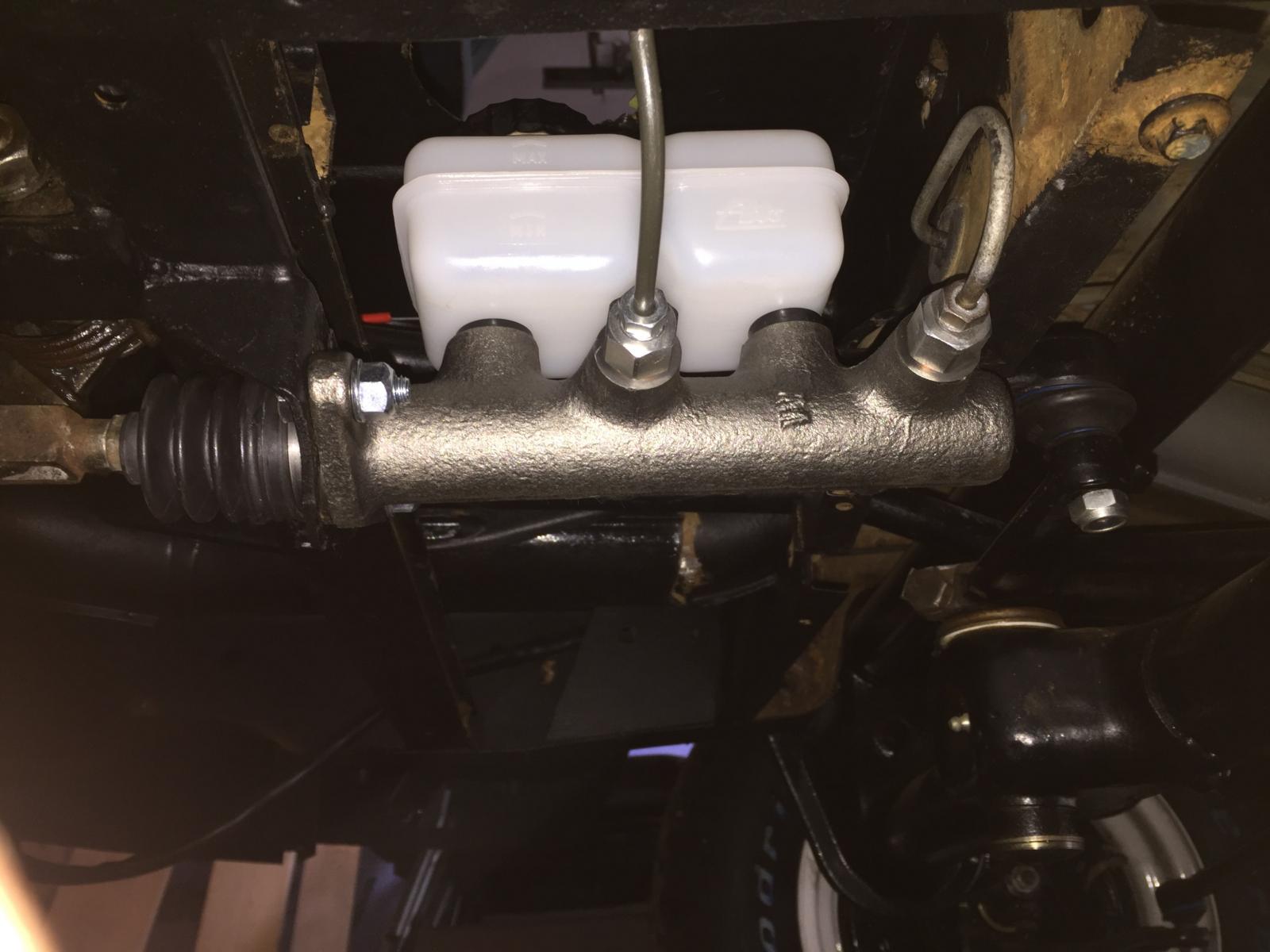

Master Cylinder is in. Better stop on a dime for the price I paid for that one year only dual circuit BABY!!!!!!!!!!!!!!

Thanks! Well, she runs, drives in and out of the garage and will now stop soon since I just put in that $$$$$ master cylinder.
I need to install the battery tray and mount the oil filter and a bunch of other stuff before I can put her on the street.

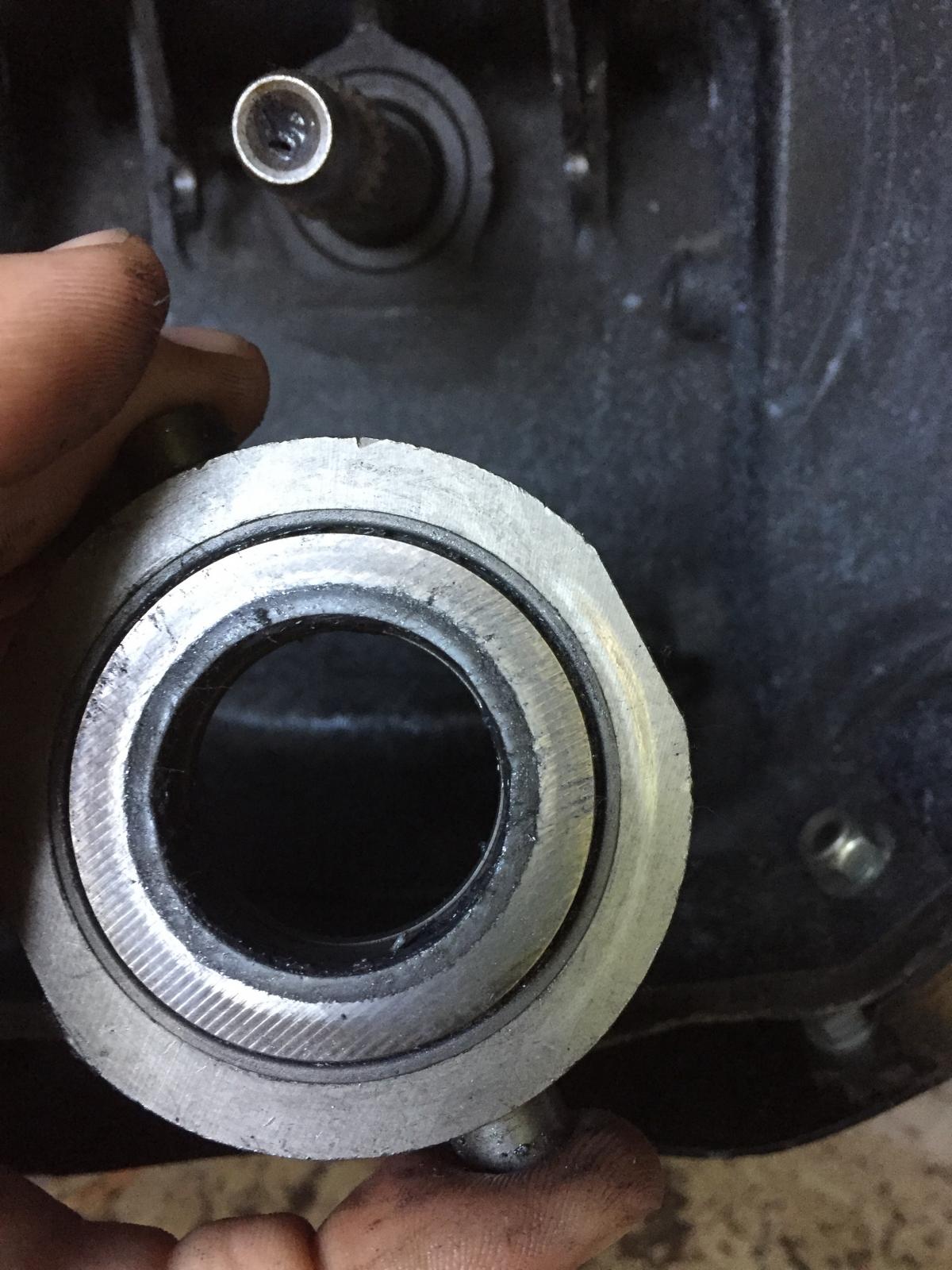

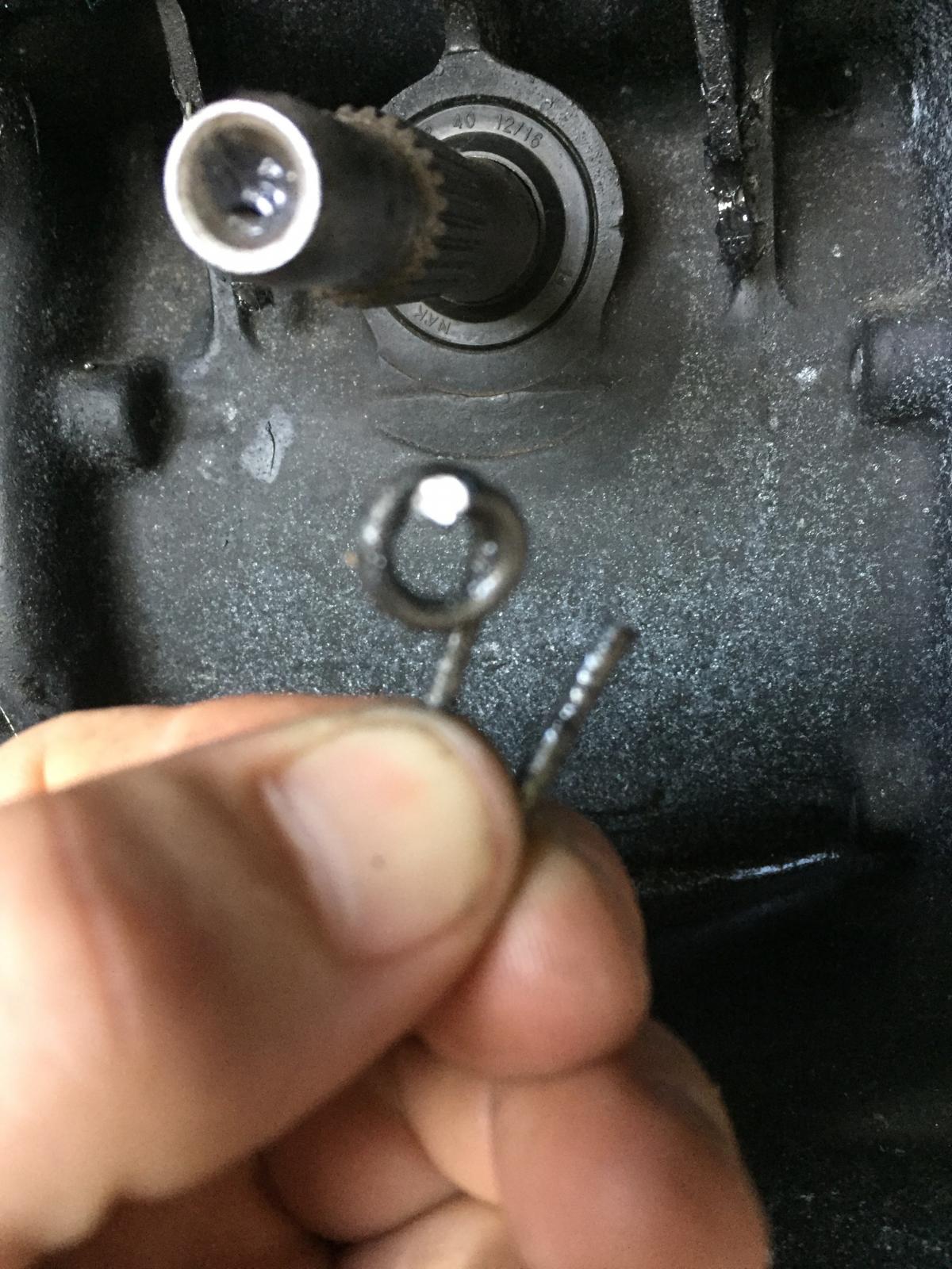

Went to take her down the driveway for a test drive. As I depressed the clutch pedal there came a gnarly grinding noise. Pulled the motor to discover a bent fork arm, signs of grinding on the throwout bearing retaining pins. and metal shavings. Wow, is the pressure plate to heavy for the throw out bearing? Or sized wrong?
There is safety wire installed around the clips because a heard they were notorious for slipping out.
I am so close to getting her on the road, what a bummer. Is there a better set up like HD fork and different retaining clips, etc. Obviously, I don't want this to occur again.
Thanks

first of all: way too much grease in there! clean all that gunk out of there!
secondly: wrong pressure plate (that's the 71- style), which is what destroyed your clips when you stepped on the clutch. see the shiny ring on the pressure plate and the blue paint shavings in the bellhousing?
thirdly: the arms of the cross shaft are bent, or at least look bent in the pics.
Thanks for the quick reply.
Yes the fork arms are bent. Ah wonderful to know that is the wrong pressure plate. Ok thanks for that.
Yes the shavings are more than apparent.
Grease will be leaving shortly.
So I am assuming that the same clutch will work with the right pressure plate or should I just purchase a new set up? Obviously, I will need a new cross shaft as well.

PostPosted: Sun Aug 27, 2017 4:46 pm    Post subject: Re: Advice on Single Cab Purchase Reply with quote
you could use the same clutch disc if it's ok and not slathered with grease.
since you're going to replace the pressure plate, i'd recommend putting a new disc in there at the same time (unless the one that was in there is perfect).
also consider a new throwout bearing, as perhaps that's where a lot of that grease came from? hard to tell since the grease is everywhere.
Thanks hazetguy. Much appreciated advice. I see now exactly what happened.
Time to order some parts.

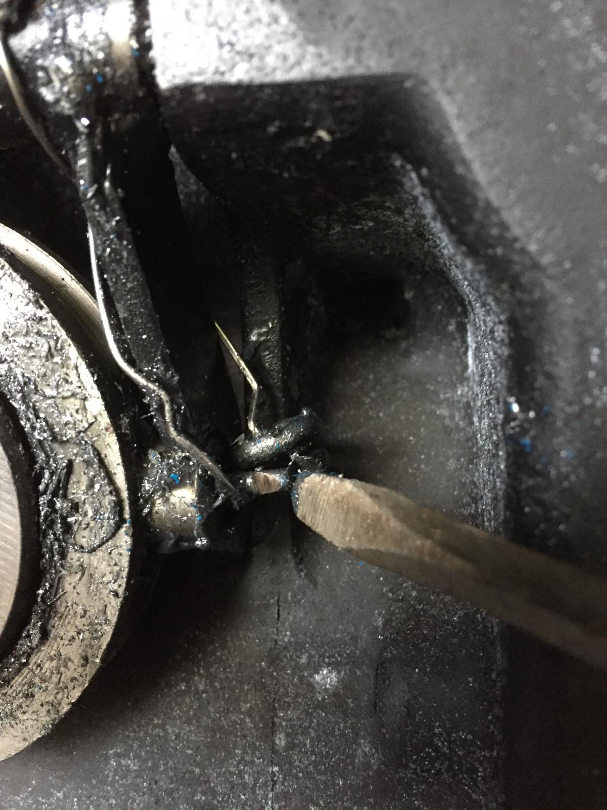

PostPosted: Mon Oct 08, 2018 2:04 pm    Post subject: Re: Advice on Single Cab Purchase Reply with quote
Well, I am stumped! This darn bulb won't light up. I have power and ground with a new bulb. ? Should this bulb only have a single contact on the bottom? This one has two, just like the original I pulled out to replace. Each contact on the bottom is receiving power. I cleaned the corrosion from all the grounding contacts.
Idea's
Thank you
1967 Single Cab
easy e
Joined: May 28, 2008
Posts: 3939
easy e is offline
PostPosted: Mon Oct 08, 2018 2:44 pm    Post subject: Re: Advice on Single Cab Purchase Reply with quote
nice dad wrote:
Well, I am stumped! This darn bulb won't light up. Should this bulb only have a single contact on the bottom? This one has two, just like the original I pulled out to replace.
6 volt = VW# N177191 .... auto parts store # 1156 (6v 10 Watt BA15s)
12 volt = VW# N177192 .... auto parts store # 1156 (12v 10 Watt BA15s)
